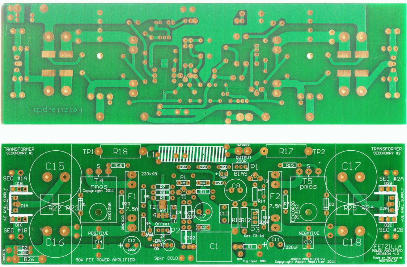

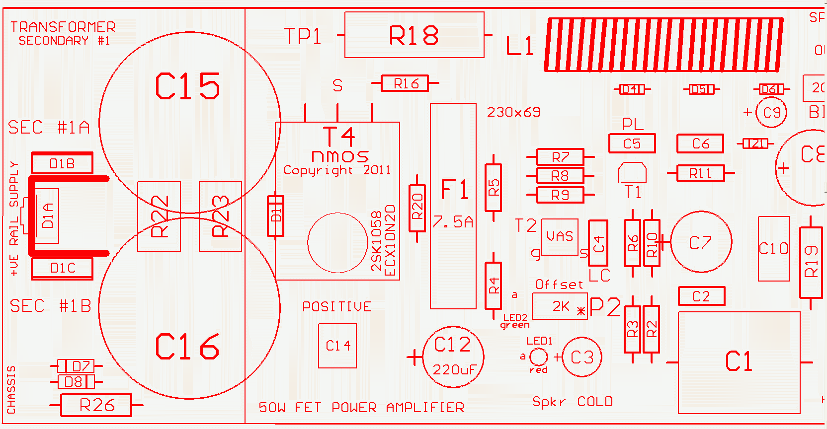

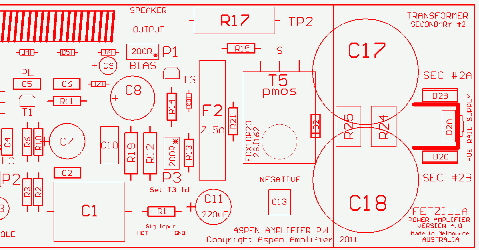

Silkscreen is erratic, e.g. placement, orientation, font size changes with component size.
Overlapping placement outlines. (Not a big deal for hand insertion.)
Placement outlines and silkscreen on wrong side of board: R22,23,24,25.
Identical components with different outlines: D1,D2 different from D7,D8, and C8 different from C7.
Components missing from BOM: P1, P2,P3.
Surface mount components R22-25 not called out on BOM.
Product name spelled differently on opposite sides of pcb. Fetzilla/Fetzila.
Nonstandard component footprints.
The core of this problem is the silkscreen, and it was compromised by the software used (Protel) and the treatment by the maker (Greentek Electronics).
I have attached two images; one is the original pcb silkscreen overlay in two parts left and right as designed, and the other is a scan of the pcb on receipt. You can very clearly see that the pcb overlay is subtly different to the original, which I submitted. Most of the errors identified are not evident in the original. I was disappointed to say the least, and five of your criticisms above were outside my control. Fortunately none of the errors compromised performance though they do affect component identification marginally.
FetZilla and FetZila are different because the software will not accept eight letter headers on the file number, only seven!! There is a reason even for the spelling error, outside my control!
Non-standard footprints, which ones particularly? The 3W smds perhaps? We are dealing with unusual components here; the thick film resistors, the Auricap input capacitor, the output inductor, and the enlarged 'Mars Attack' pads on the jfets. I composed these primitives myself according to past experience, so if you think some are wrong, do let me know and I will revise them.
I amended the BOM to reflect P1, P2, and P3 trimpots. Thanks for picking that up, I missed it!
You are right on D1/2 and D7/8. They are indeed different; yet the devices are all 1N4004.
Lastly, components on wrong side of board; yes, true enough, this primitive was set up for component side mounting and I did not revise it for foil side, my mistake.

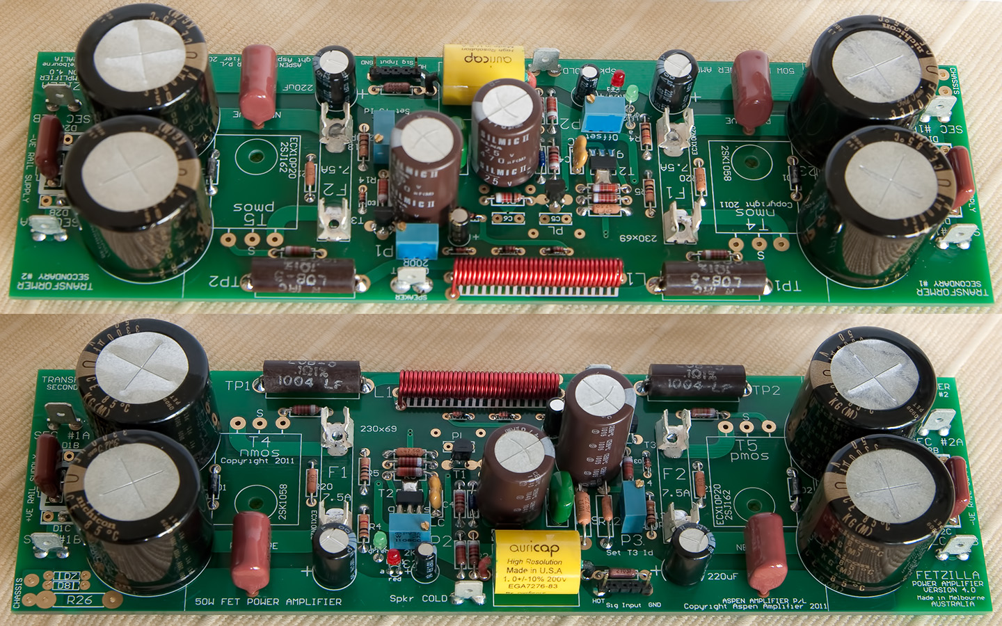

I have had the FetZilla running on my test bench for more than a week now and can say that there is no need to mount the three bias diodes on the foil side.
It was an option I considered for very hot climates, but I believe it's unnecessary after living with the amp for some time and noting that the quiescent was rock steady, better in fact than any bipolar output stage I've worked on.
Accordingly, mount them all on the component side, it is no problem at all as the tempco of the lateral fets keeps everything very controlled. I set my quiescent at 400mA.
