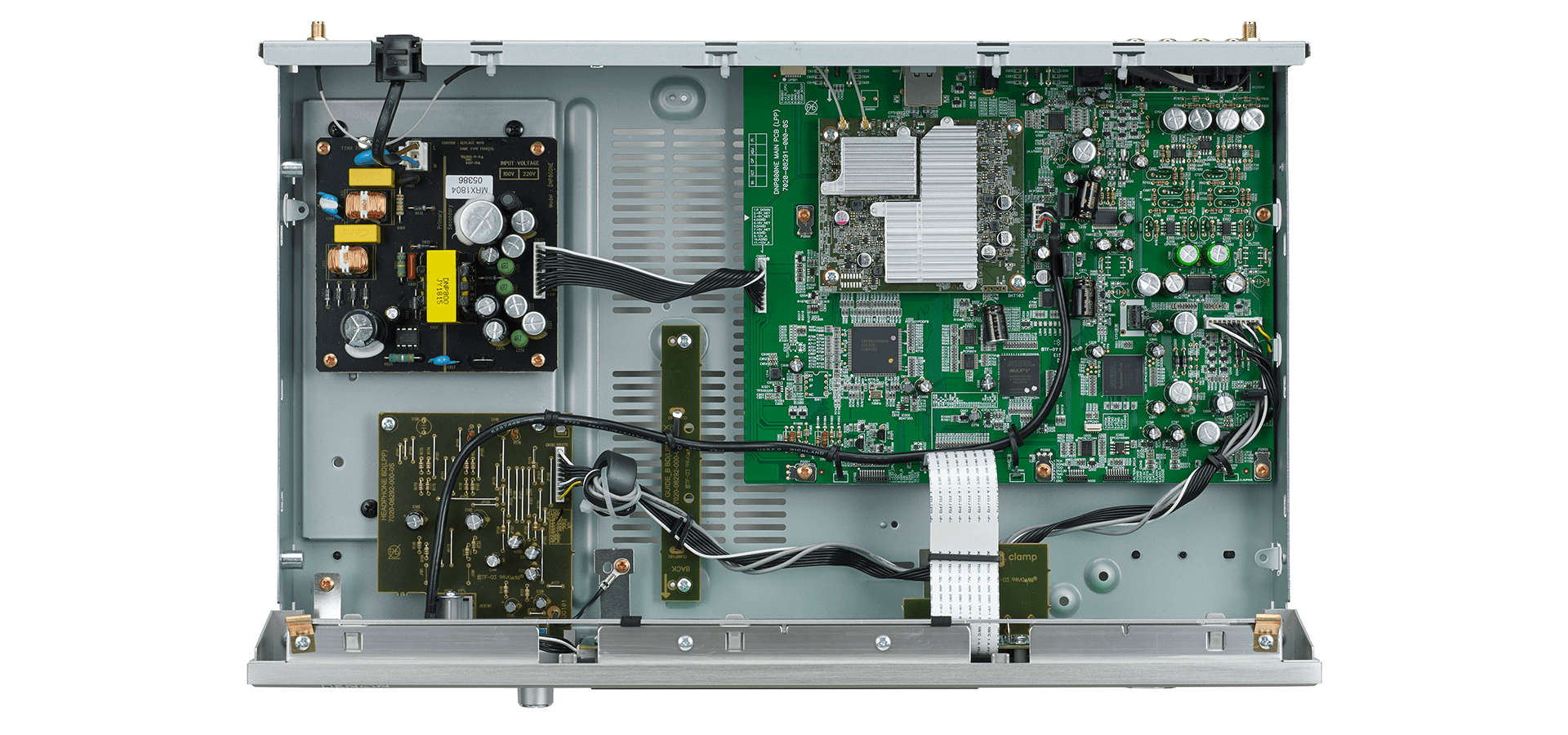

I have a Denon DPN800NE network player. It felt very light and suspected that its source could be switching.
Searching on the internet, trust me that it is so.
