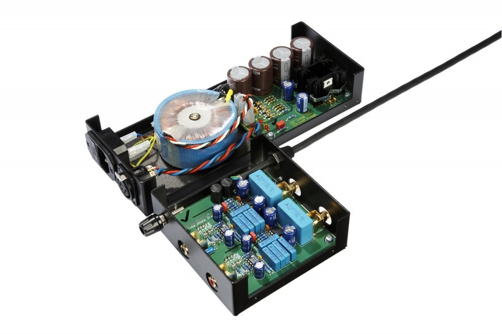

I have built several phono preampli diy of the well-known ones and not so much. VSPS300, VSPS400, Muffsy PP3, P06 ESP, Solidphono by TNT.
My question today is if these phono pre can be powered by switching source + 15v 0 -15v.

Technology does not matter. Execution does. Yes, you can make a very very clean SMPS. For bigger loads it is economical. For the tiny loads of a phono amp, it may be cheaper to use a linear. Cascade a handful of regulators etc. The same level of quality in a small SMPS may cost more.
SMPS ARE routinely used in audio. Even high end. For example the Benchmark amp is one of the best at any price. New Topping PS5 is unbelievably clean. There are many published post supply filters for DIY. Some markets may select a linear for advertising reasons claiming some magic superiority. I don't use them because I am not competent to do so. I know linear. Not an excuse for a comercial product.
At low power levels like preamp supply linear regulators are simpler and cheaper from both design costs and implementation.You don't care about switching noise, emi...they are simply put cleaner in a smaller envelope, there's no need for additional inductors with linear supplies either nor very low esr capacitors so it's basically cheaper to manufacture too while efficiency don't matter for audio preamplifiers.It may count for sattelite or orbital telescope equipment where saving weight and efficiency is a must, but on Earth...100mW or 10mW is the same thing.

All my pre DIY phono are powered by conventional sources, but on the advice of RJM from VSPS and Solidphono from TNT, they have a 50w toroidal transformer.
According to them the difference in dynamics is noticeable.
That is why I thought that when using switching sources it is easier to reach 50 watts or more.

Some switchmode chips under light load change to lower frequency operation - this can be an issue for audio as even if the switcher is nominally well into the ultrasonic range in frequency, without a significant load it may drop to a lower frequency, or to a sporadic burst mode, both of which may be slap bang in the audio band and hard to filter out.
And for a phono preamp you have the issue of RFI getting into the preamp input (such as switching noise), and there's a limit to how much RF you can filter out with capacitance if the cartridge loading capacitance is a couple of 100pF, some of which is already taken up by the cable.

SMPS's used to be noisy, and got a bad name in high end audio. But that is not the case anymore today. But as the hifi scene is quiet conservative on technology it's still a tricky marketing thing to use SMPS's. Linear psu's sell easier, and can be sold at higher price.
And for low power use, and linear is cheaper to build than a good smps.
But technically there are no reasons why a smps couldn't power a phono stage. It has to be done right to avoid switching noise, but it can be done. Some, like Manley Labs even start to build tube amps with smps's, and that is way trickier due to the high voltages needed than phono stages running from 12v to 24v...

What I can say is that once when I tried powering a head amp (ie. a gain stage which takes LOMC voltages and produces an MM-level output) with a 12v SMPS ... the noise from the spkrs was unacceptable. (I tried this to see whether I could use a $50 Meanwell instead of a $500 Sbooster for my head amp. 🙁 )
So I had to continue to use an Sbooster to power the headamps.

Well I tested and used -and not just once- Meanwell, XPPower and Hypex ac/dc converters, XPpower, Traco, CUI and Murata dc/dc converter as well as discrete dc/dc switcher solutions (LTC8582 et al) from phono-MC stages over highlevel stages to power amps and always had very positive results.
Admittedly all switchers require at least some passive post filtering, but often this suffices already.
When used in conjunction with those modern fast regulator chips (LT304x/309x, TPS3x/7x series) the performance is certainly top notch in every aspect.

Switch mode supplies tend to be used in applications where more power is needed, and low waste heat and efficiency are required. In a small signal setting like a phono preamp, a 7815/7915 pair and a couple of small caps will do it simply and just fine. Plus, there is no HF noise using them.
