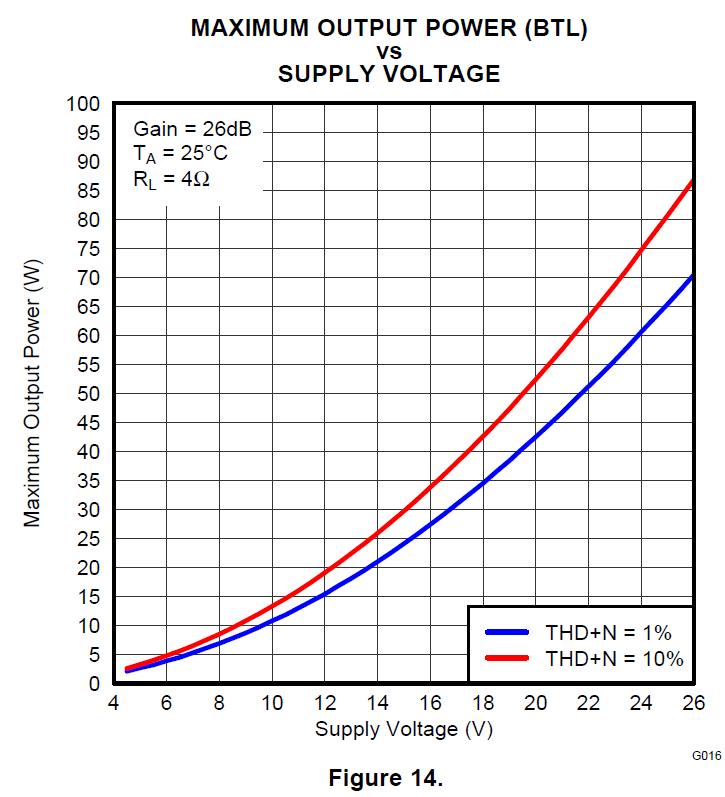

Although the amplifier you have selected ( others do as well ) suggests 100W + 100W The data sheet tells a more real story.
And although the amp ( you have linked to ) uses the chips in PBTL there will not be much more power than with "regular" BTL configuration until you decrease the load below 4R.

Yes was aware that output was not 100w more like 75w max at 24v when driving 8 ohms speakers (according to another seller on ebay). I really don't need that sort of power, its mainly for background music and to listen to the radio.

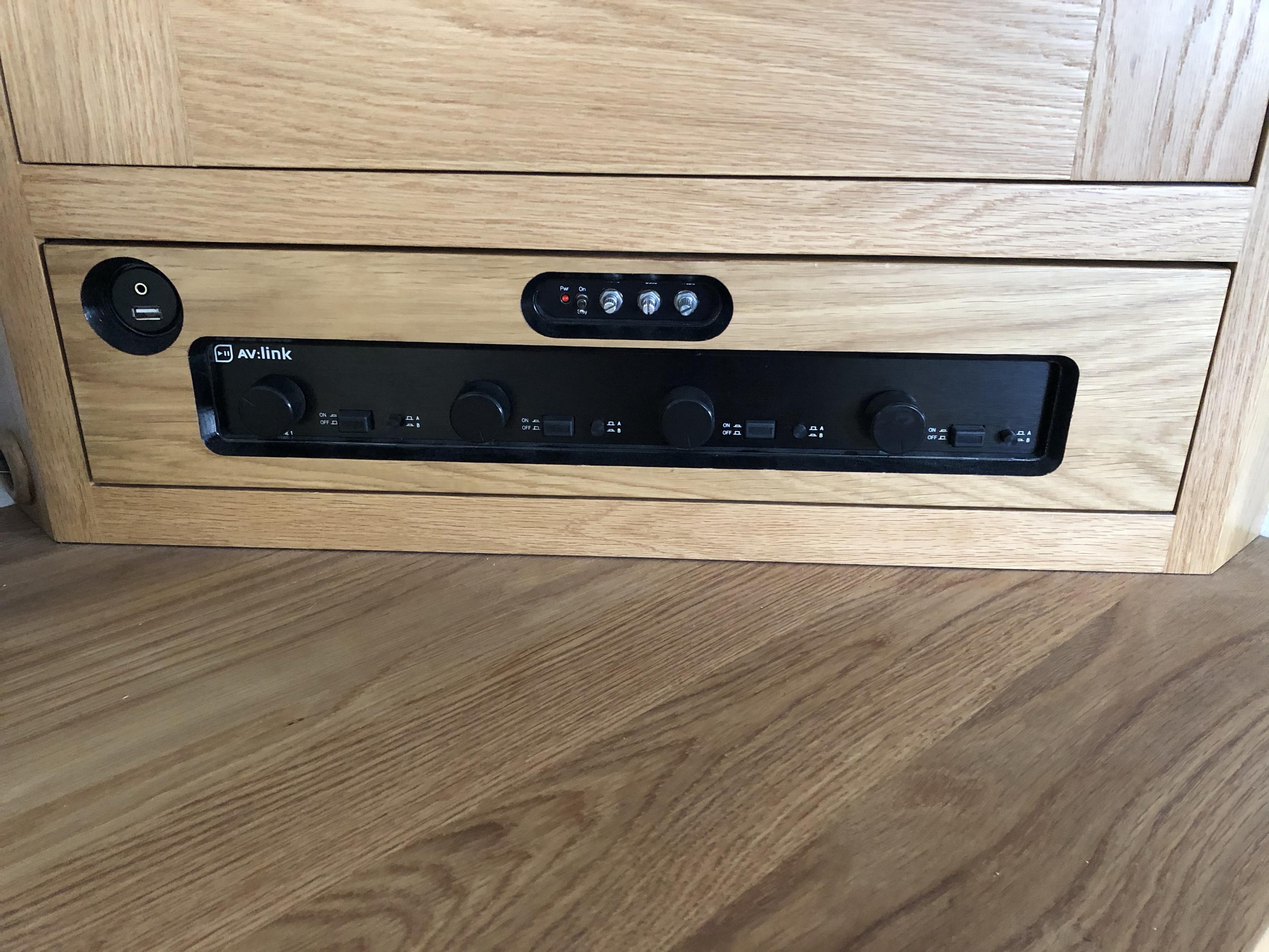

As an aside this is the 4 way speaker selector I was having issue with. It has internal matching transformers but I only got very low distorted sound out of it. I have therefore decided to use it as a case for the four amps and smart relay. Mainly as I went to a lot of trouble to build it in to my kitchen unit Shown with another 50W+50W TPA3116 based amp.

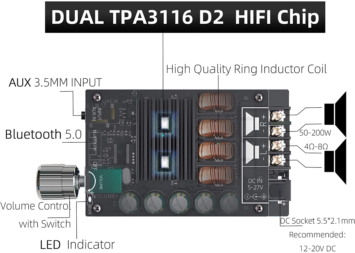

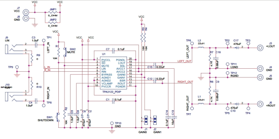

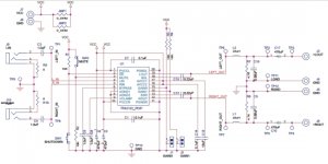

I have attached images of the TPA3116D2 schematic and one of the board itself for further info

Your first post indicated that you are using TPA3116 modules. The schematic you displayed is for a TPA3122. The speaker negative terminal is common to both channels and ground.
The picture of the board is for a Dual chip TPA3116. The tpa 3116 each speaker output is about halfway between ground and the + power supply. The speaker negative outputs are NOT tied together and are NOT tied to ground. Connecting the - speaker terminals together and or to ground will most likely destroy the chip. You must use double pole switches for each speaker connection.
If you are only connecting one set of speakers to each amplifier and are switching the power supply connection on and off then you can use single pole switching.

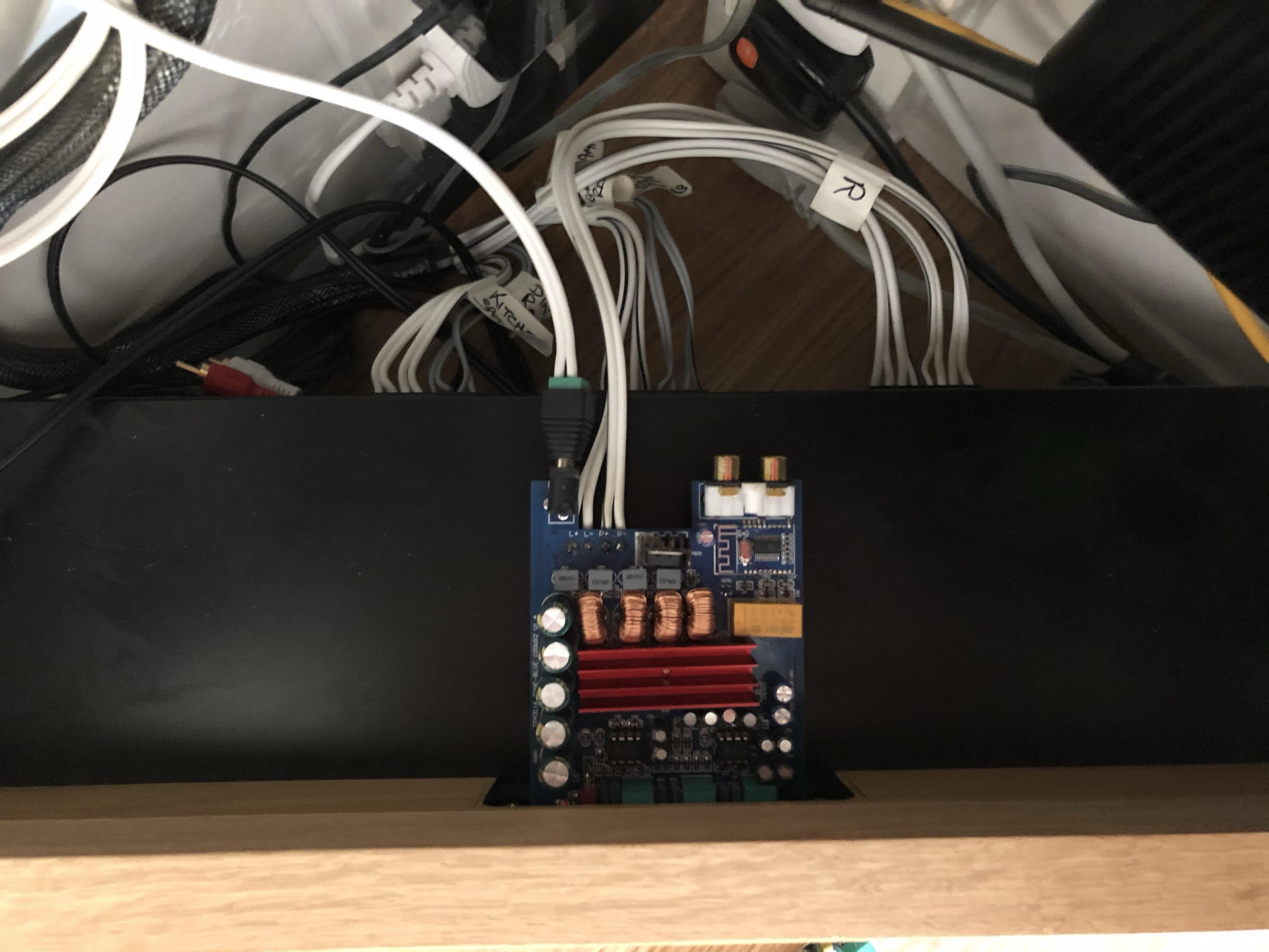

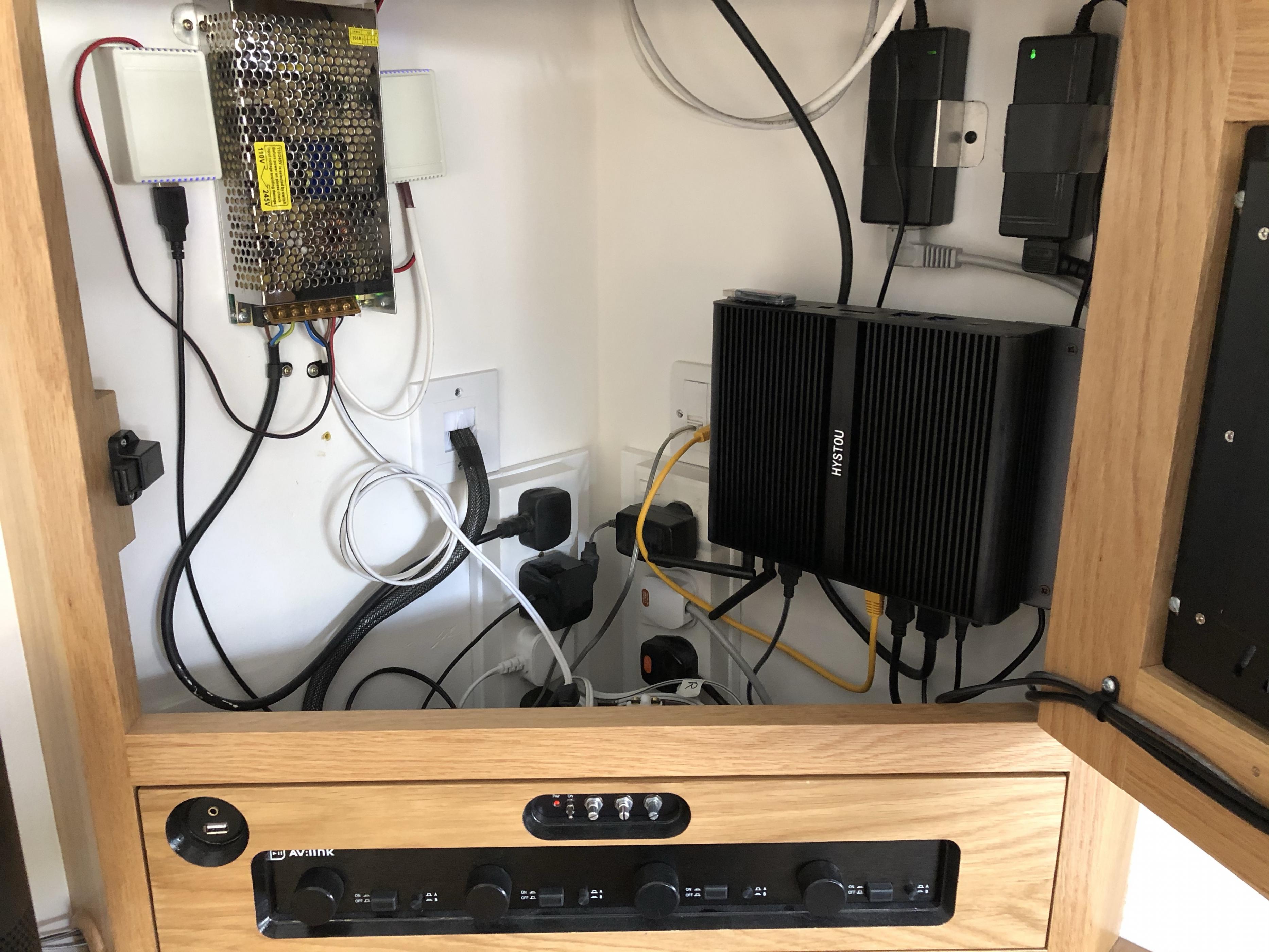

Thank you xrk971 but this is not possible now as I have already spent a lot of time and effort bringing all the speaker connections to one location in my kitchen, where the amp and speaker selector are located. Attached are a few photos of my installation.
As the speaker selector won't work I aimed to remove the contents and mount the amps inside the case which would make a nice neat solution. Doug's idea of switching the power to each of the amps and keeping the speakers connected seems the best way forward.

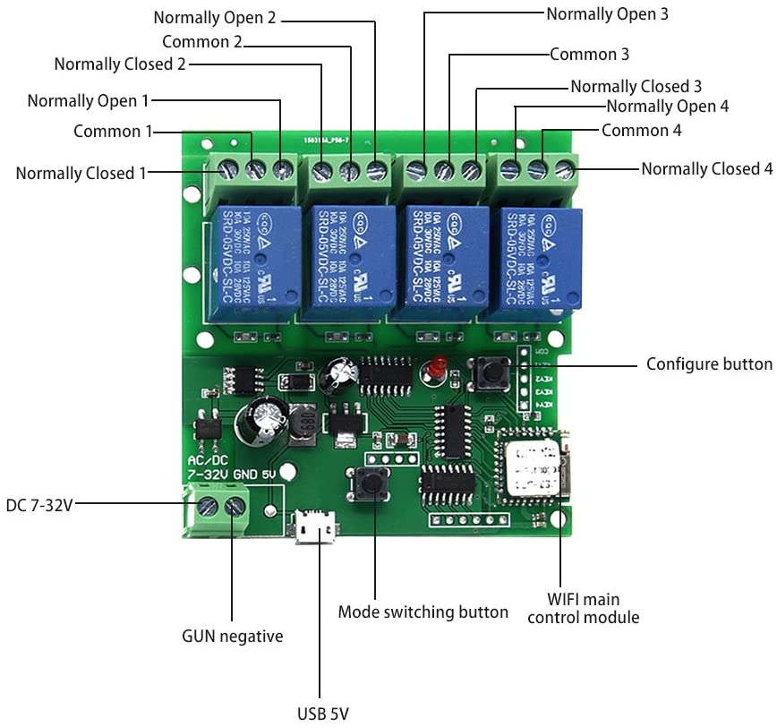

I am trying to find a Tuya Smart relay board with a centre off similar to this to use for the voice control and to act as the two switches required for the circuit above. As I type this I have just thought perhaps I could just use a two relay board? One relay for volume up and the second for Volume down. Just need to check they work as momentary relays.

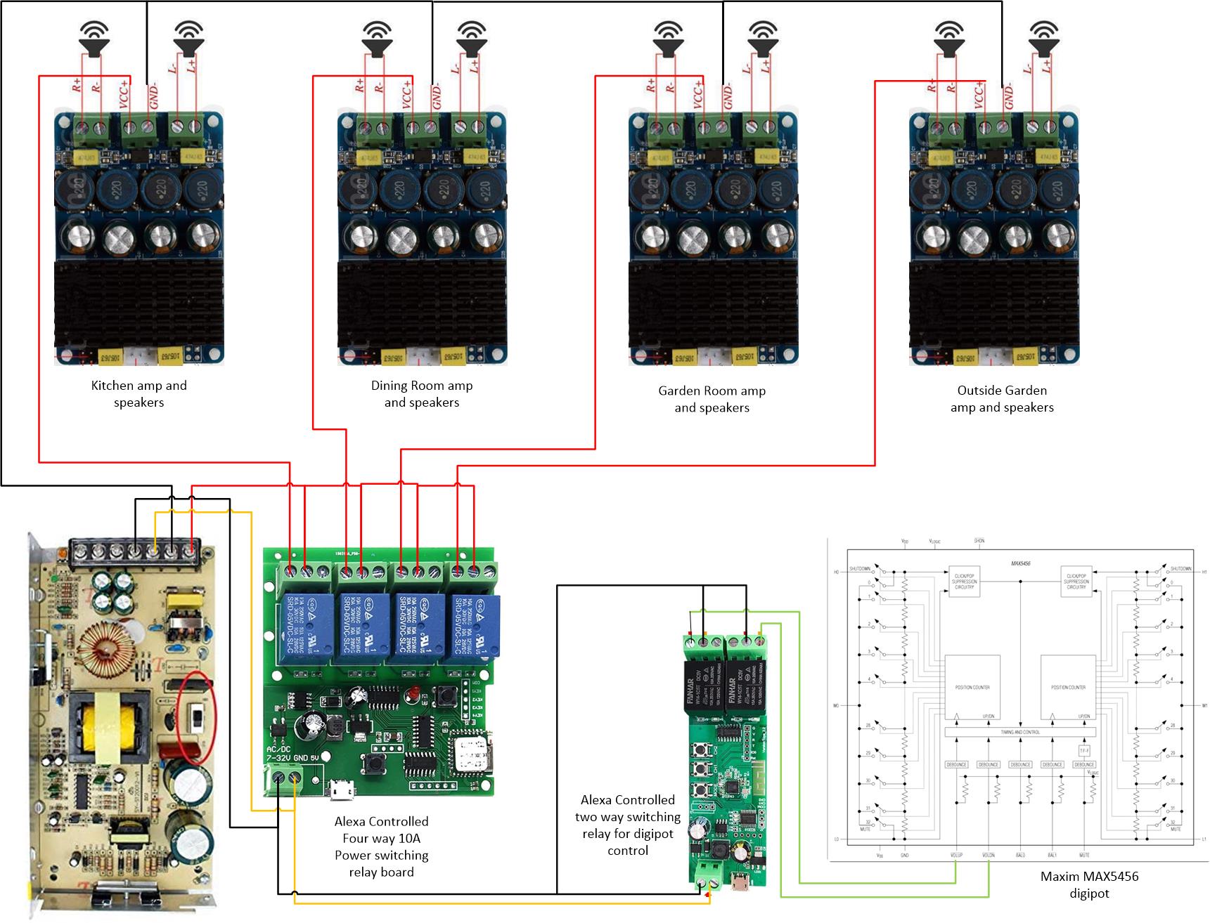

OK so I have moved things on a bit since my last post. I have decided to use TDA7498 base amps in preference to the previous TPA3116 based amps partly because of the additional power output but mainly because I don't need bluetooth or volume control on each board. That said there are some 120w +120W TPA3116D2 based amps which I hadnt seen before. Any thoughts on which might be better suited would be apreciated. The TPA3116D2 are even cheaper than the TDA7498 boards 😀
Master volume control will be controlled below but individual amps will have a separate potentiometer.(Detailed schematic to follow)
I have attached a schematic for the amps and how they are each selected using a four way voice controlled Smart Relay board. The plan is I can use a voice command to say "Alexa turn on music in dining room" the appropriate relay will close providing power to the amp.
The other two channel Smart Relay will be used with a Maxim MAX5456 digipot to control the volume. This has the advantage over other digipots in that you can use manual external momentary push switches to control the volume up and down. These momentary switches will be replaced by the two relays on the Smart board. This can be set to Inching mode rather than Latch mode so can close in adjustable steps from 1 sec upwards.
I plan to use a 24v Power Supply (which means I wont get the full rated output from amps but happy with a max of 50w per channel) with a current rating of 15A. It is unlikely to have more than two rooms operating at a time but do you think this is sufficient power output should all 4 be selected? I will also need to take a 24v feed and drop to 5v to feed the Smart relay boards and Digipot and possibly 12v for the audio input selector (unless I can bypass the onboard 12v to 5v dropper circuit as the relays are 5v rated)
One question I have which I seek your opinion on, is any issues I might have with a common audio source connected to all of the four amplifiers at the same time. For example will the proposed schematic drag the input audio levels down due to the impedance being divided by four as they are all in parallel? Sources are likely to be at line output voltage from an Echo show, iPhone headphone outlet and hopefully a bluetooth receiver.
Depending on comments relating to the above, my next task may be to select individual sound sources rather than having all inputs connected together. I had thought about using something like this Audio Input selector. I can dispense with the phono board and rotary switch and take a feed from each of the NO contacts on the four relay board to switch each relay on this Audio selector.
I would effectively be reversing the throughput so the input to the amps would be directly connected to one of each of the relays and the audio source connected to what is now the audio output.
So when you use voice command to close the power relay and supply voltage to the amp it also powers the relay on the audio selector board which then connect the signal to the appropriate input. Maybe I can even put a resistor/capacitor on the feed to the selector relay so it pulls up more slowly giving a slight delay to the signal being connected.
I would appreciate any thoughts or comments on the design especially if I have not considered possible connection issues eg should I decouple the inputs with a capacitor, can I do anything to prevent speaker "Thump" when power is applied to the amp etc.
