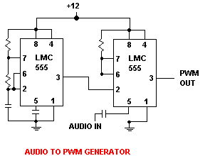

Here's 555 schematic
I used LMC555's at around 200KHz switching speed and an ordinary switching power supply mosfet (look for the lowest Rds(on) for better efficiency). The output of the second 555 goes to the mosfet (which drives the speaker). (You can use LM555's but they can't switch as fast as the CMOS LMC555)
You can use LMC556 instead of 2 LMC555's, it doesn't make a difference.
The 555's (or 556) has enough juice that you can breadboard the circuit and drive a (somewhere around 270 ohm) easy load for testing.
Put whatever LP filter circuit you want (frequency and order).
Have Fun!
On the national website, the 555 datasheet shows the building blocks. (Timer and PWM generator). You can also use the PPM circuit, but it didn't seem to work as well as the PWM circuit.
http://www.national.com/pf/LM/LM555.html
Hi Matt MacBeth
How is the mosfet or mosfets hooked up?
I have only seen four transistor setups (H-bridge).

possible fet hookup
There are many ways to hook this up to a driver, a simple one is shown in the picture. For a better circuit, a 'real' driver circuit should be used.
Harris (Intersil?) and others make an H-bridge driver that should interface to this. There's even some with integrated FET's. The problem with making your own H-Bridge, is that if the 'top' and 'bottom' come on at the same time (overlap) this will damage the FET's. The driver IC's prevent this.
Anyways, on to the schematic.
P.S. sorry about the MS-Paint schematics (especially the choke)!
Thank you, Matt Macbeth. I think I can increase the accuracy of the pulse stage by placing a PNP transistor. The transistor will make the capacitor charge fully instead of 25% to 75%.
For more information of what I'm talking about:
http://casemods.pointofnoreturn.org/pwm/741.html
The person took off from the trigger and left the output hanging. I'll use the output pin so I don't have to use an op-amp to smooth out the sawtooth waves. Though, I don't have an ocilloscope to see the effects.
I can also use 4011 NAND gates to generate the pulse but I'll stick with 555 timer for now.

I think this is what you guys are looking for. A quad op-amp, a couple of comparators, four FETs. The TC4428 is a TeleCom dual comparator. All the parts are available from Digi-Key.
http://www.linear-tech.com/pdf/lt1160.pdf
This has a low distortion triangle wave generator driving the fast comparator and the motor drive IC has shoot-thru protection. Figure 6 page 13. Distortion is a function of the switching frequency and the low pass filter. Another good read.
http://www.onsemi.com/pub/Collateral/AN1042-D.PDF
