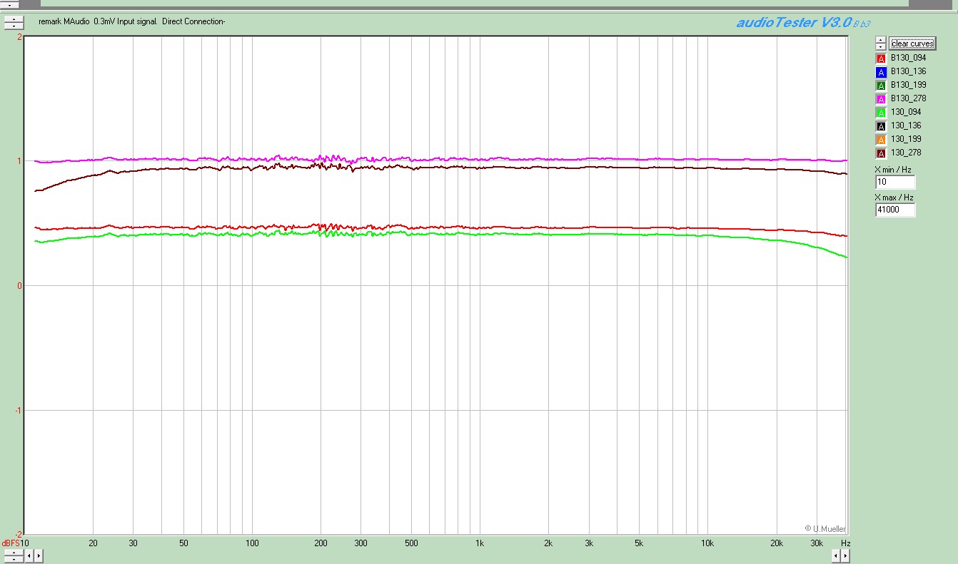

I have some data with and with out the bypass caps in a more exagerated example. I'll post the curves after you test and report back.

This is an exaggerated and not directly apples to apples comparison, but the attached shows the impact of bypassing a string of LEDS in the cathode. The Pink and Red are two sweeps with 660uF FC type and .1uFMKP bypass, the Brown and Green are without bypass caps. In this case it is a 12b4a and there are 7 LEDS in series.
I don't have a 6SN7 set-up otherwise I would repeat the experiment.
There is another BIG difference in that the 12b4 won't even come close to an overload condition as it is biased around 17Volts. (at least the way I am using it) The 6SN7 may.
