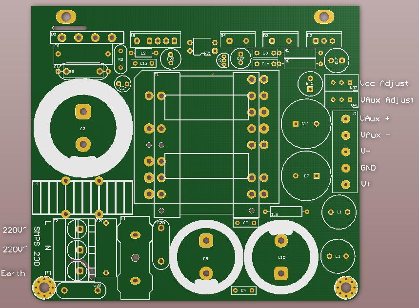

Hello Cristi, after few weeks of service, my SMPS200 just died 🙁
I heard a noise (a loud CLAC!) when switched amp on. No voltage at the output. Visually, nothing seems burned. Fuse is ok.
What tests can I do to find out what component is broken ?
It might be a cold start overcurrent which could kill the thermistor. that can explain the noise and the fact that the fuse is not burned. can you measure the thermistor, with a multimeter, should have about 10R when is cold. make sure that you disconnect everything before measure. i wont' guide you to measure anything else which implies to connect the smps to live mains. if you cannot find the problem, just send me back and i will replace it.
thanks for the help. referring to the pcb, could you tell me which one is the thermistor ?🙄It might be a cold start overcurrent which could kill the thermistor. that can explain the noise and the fact that the fuse is not burned. can you measure the thermistor, with a multimeter, should have about 10R when is cold. make sure that you disconnect everything before measure. i wont' guide you to measure anything else which implies to connect the smps to live mains. if you cannot find the problem, just send me back and i will replace it.
edit : I looked again the board carefully: it seems that a small component (R2 on pcb) is blown.
the thermistor is R2, exactly the one which you said. in the attached image, has the oblong footprint just under the rectifier bridge and C24.
replace the thermistor with a new one, same value, and for better reliability you can consider a bigger size. the value is 10R. the code for a bigger one is NTC 10D-13. after you replace, leave about 12-15mm long legs from the pcb to allow heat dissipation without overheating the board. in normal working conditions the thermistor gets very hot, over 60*C.

ok will do.the thermistor is R2, exactly the one which you said. in the attached image, has the oblong footprint just under the rectifier bridge and C24.
10R Thermistor is actually not that easy to find🙁 I could not find your exact reference.

The thermistor used for this smps is not a "sensitive" choice. in fact, any thermistor which have nominal resistance at 25*C between 5 to 10R and can withstand at min. 3A can be used. the size should be between 9 to 13mm, bigger one will not fit on the tight space.
i just narrow the search and there are 3 types which can be used.

thanks. for some reason, the link does not work on my side. Could you give me the part numbers ?The thermistor used for this smps is not a "sensitive" choice. in fact, any thermistor which have nominal resistance at 25*C between 5 to 10R and can withstand at min. 3A can be used. the size should be between 9 to 13mm, bigger one will not fit on the tight space.

i will post the direct link to the parts: http://uk.farnell.com/ge-sensing-thermometrics/cl-120/ntc-thermistor/dp/1707218

be very careful when you install the new thermistors. after plug-in the smps the big capacitor will be charged at +300V, then will take few minutes to discharge. wait until is completely discharged, and only then can work with the board.

ok. thanks for the advice : good for my health !i will post the direct link to the parts: GE SENSING / THERMOMETRICS|CL-120|NTC Thermistor | Farnell United Kingdom

I'll pick this one : similar or better than the suggested. A bit more expensive, but available here in Europe to avoid the 16GBP shipment costs from the US!
