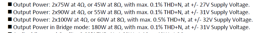

Hi Cristi, I have a TA2022 based amplifiers, And I noticed that there is no +-30v option in the SMPS200QR page, only +-32v. Can I use the +-32v on my Ta2022 amp?
Take a look here
Connexelectronic
Follow the link to the PDF. Here it says +-32V, so the answer would be yes.
Or you could go with the +-27v psu.
Connexelectronic
