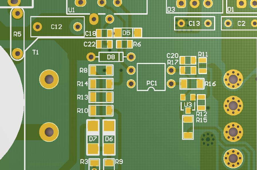

I'm experiencing a high pitch high volume tone from the SMPS itself. Anything to do about that ?
Partially solved. The 3886 boards had 1500uF@rail local decouple. Those 4 caps upsets the SMPS. They are gone now, so are the annoying whining.
Only thing left are a faint hiss - I'll try moving the SMPS away from the modules.

Jesper, the whinning could be caused by a particular voltage setting where the control loop stability is narrow at a given current draw and the easiest way to avoid it is to increase or decrease by one-two volts. The SMPS180QR as well as SMPS250QR use quasi-resonant flyback topology, and besides the regular voltage feedback loop found in most of the power supplies, there is a self-synchronizing circuit which helps to achieve the quasi-resonant operation and the values of this circuit has to be tuned too. overall, the target is the output voltage stability and the lowest switching noise, without decreasing the efficiency, primary required for an audio amplifier. If the output voltage is stable, should not worry about the transformer noise. If is annoying, replacing one or two resistors the noise can be reduced.
The voltage is stable, but the whining is annoying. I'll like it to be dead silent - and to be able to run at 27v instead of 32v.
Tell me, which resistors is to be replaced and by which values - I'll gladly make the test. After all, it is DIY.

Start by changing the value of R11. the value is 100K or 150K depending on the board version. see the layout screenshot. i suggest to use a 220K potentiometer in series with 10K resistor which will be soldered with ~ 10cm long wires on the board and tune till is noiseless without compromising the voltage stability. try this first, dont touch anything else.
will be a lot of fun to reach that resistor and you will bless me a lot for that
because is under the transformer, and to take out the board from the shell will need some effort and tools. try to not damage-it, will be great.

I christi i resolv my hiiiiiiiiiii problem it's come from the amp i use, for the little noise i've heard i put resin in the transformer...
