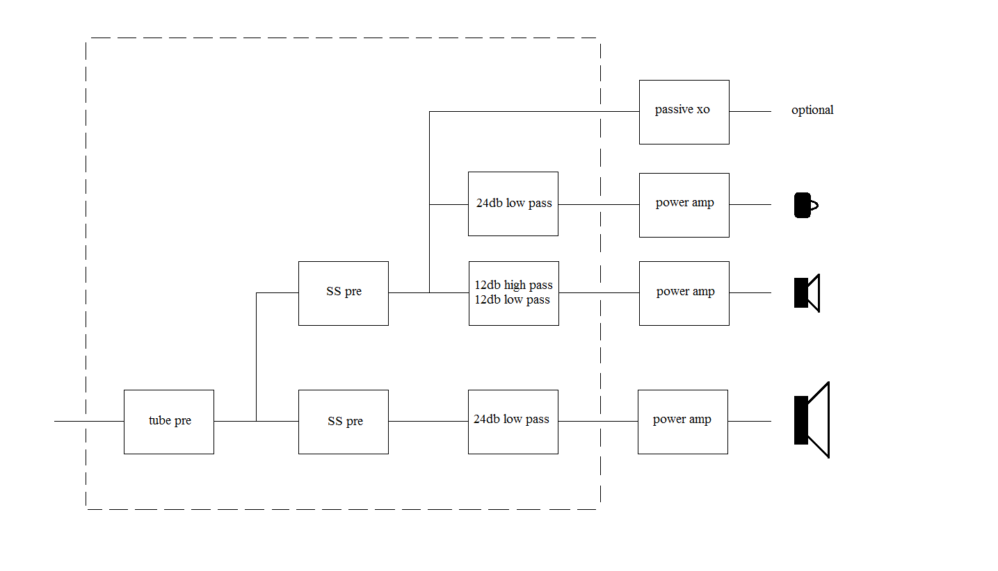

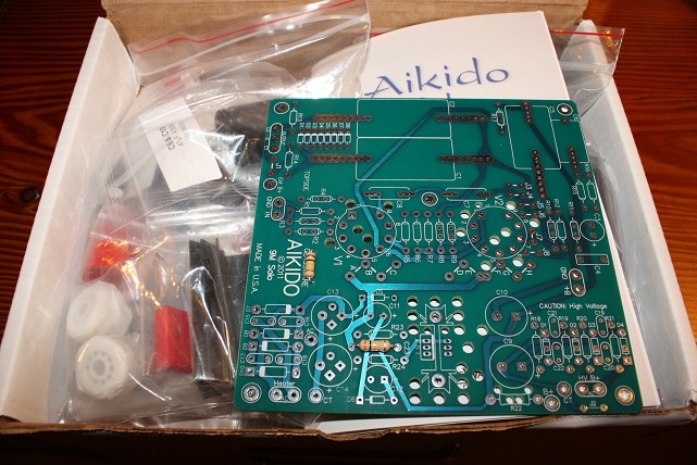

ok, I got the Aikido mono solo boards
it will be my instrument input
and I expect my two channel Burning BA-3 (NelsonPass) will look like this
this will be my output gain/buffer

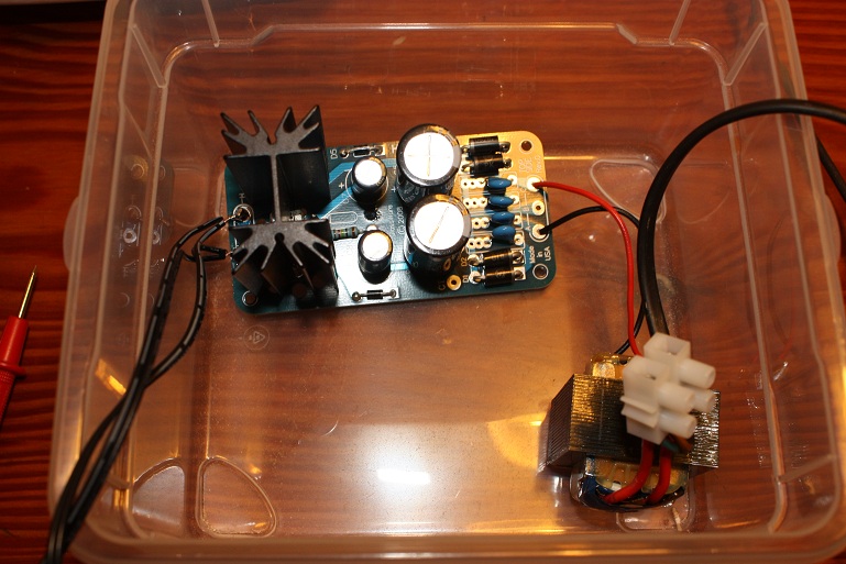

now I need some power supply parts

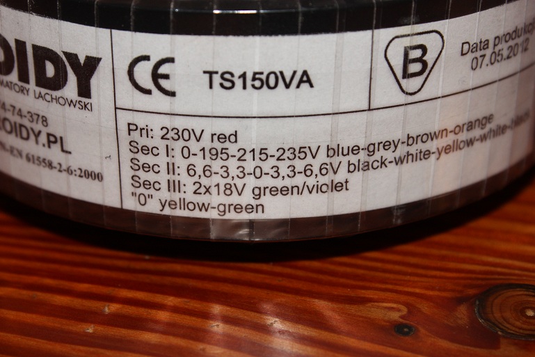

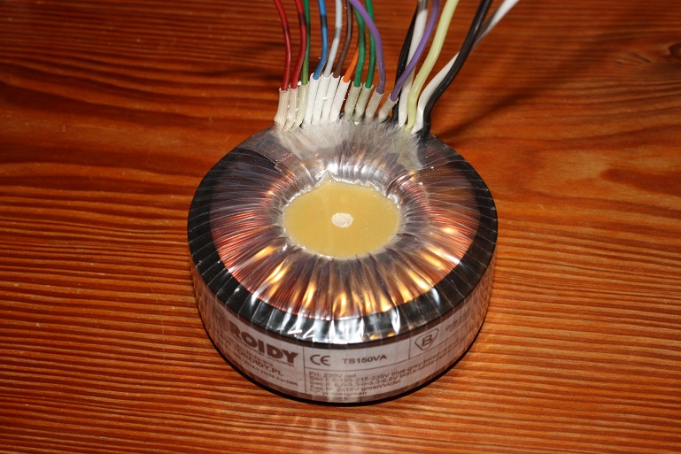

going to order trafo
planned voltages
0-195-215-235 (100mA)
maybe 100mA is a bit high for a preamp, I dont know ?
6.6-3.3-CT-3.3-6.6 (1.5A)
0-18 / 0-18 (1.5A)
and maybe I would like exstra voltages for effects, 0-9-12-15V
maybe getting a bit complicated in one trafo
planned voltages
0-18 / 0-18 (1.5A)

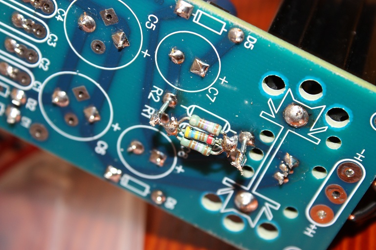

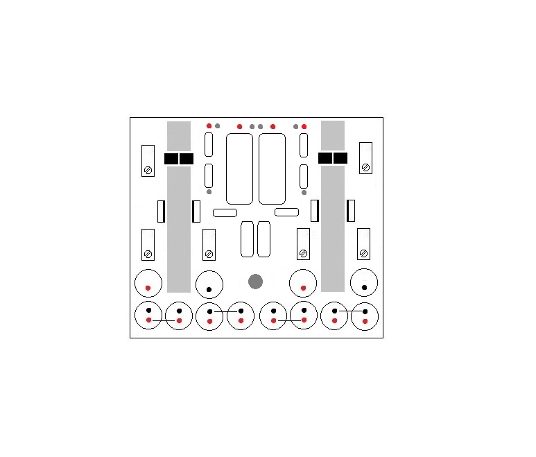

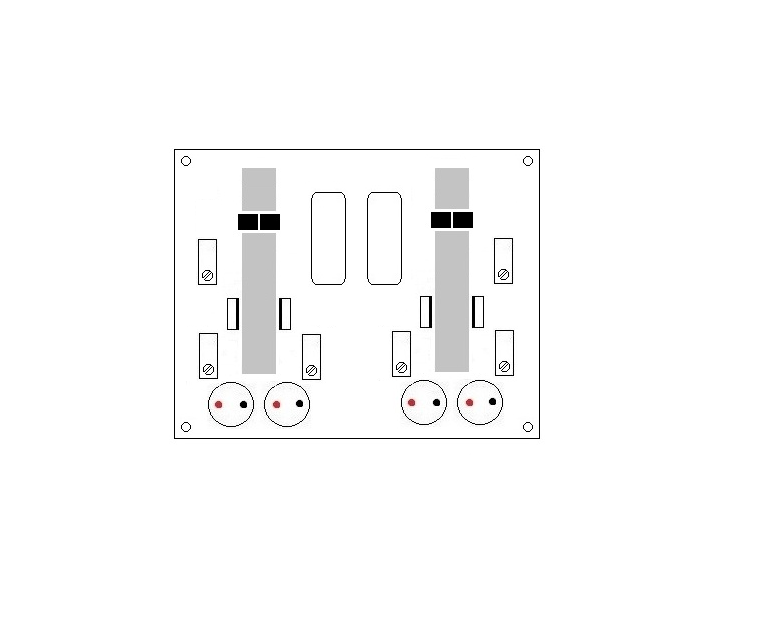

BA-3, a full ground plane seems to make sense here
and where a hot connection is needed, I will just route away with engraving bit
a hybrid combination of hard wire and hole mount
would be really nice to have a small tool to route around the holes

trafo ordered from Toroidy 🙂
0-195-215-235V (110-120mA)
6.6-3.3-CT-3.3-6.6 (1A/2A)
2x 18V (2A)
special audio quality
2x 18V (2A)

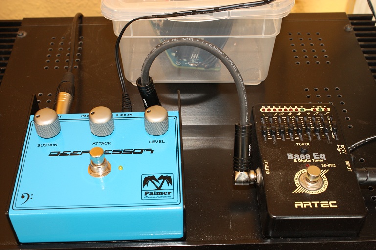

actually, right now, the only pre I have between my passive bass and power amp is a simple Bass EQ pedal switch thing
works ok
it even works in bypass mode 😕
but it tells me that my future preamp build may be all I will ever need
that feels good, somehow
but if this speaker goes active, I will still have some means of controlling the sound 🙂

Compression.
Compression.
wow, it works 😎
hard to imagine playing without it now
like night and day, really
funny, I just now found that the compressor has a high/low gain switch, for active/passive pickups
