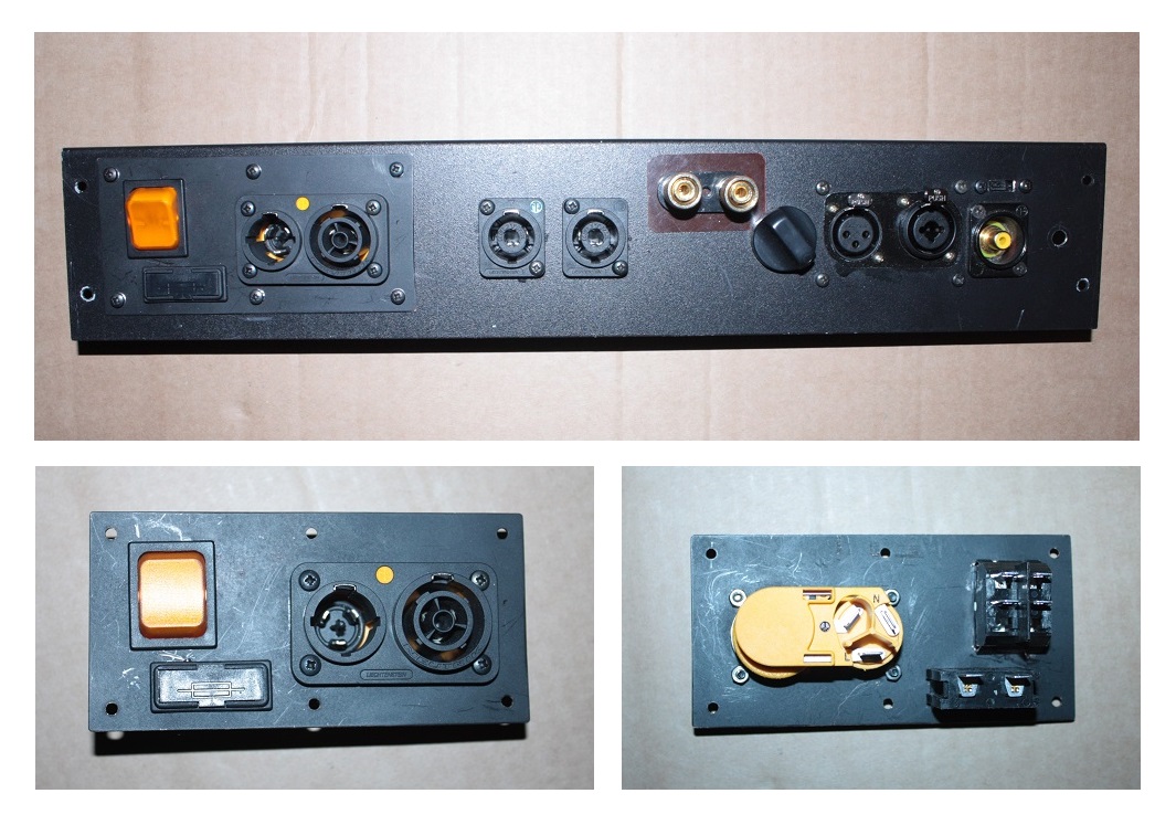

hope to have this amp ready soon
Details please?

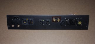

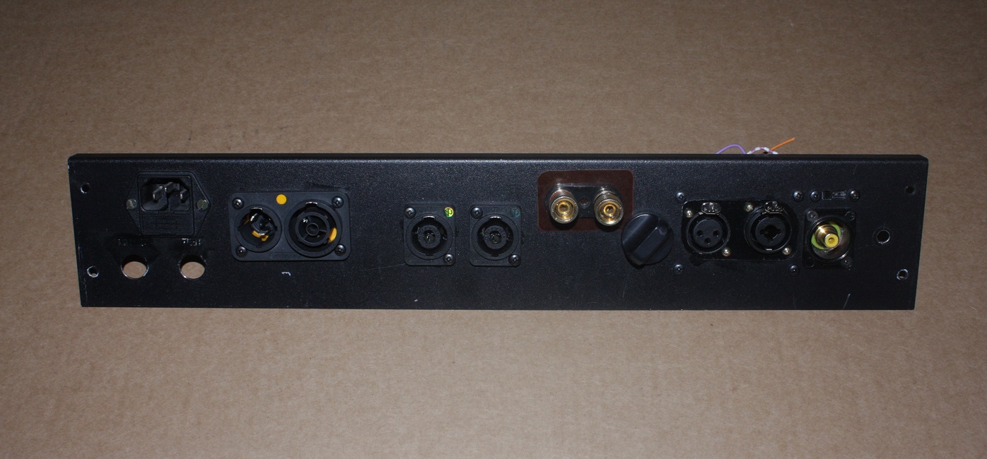

I'm currently working up a 2RU integrated bass head. Bought one of the ICE 500ASP modules for sale here, which already sounds great with my existing DIY preamps.

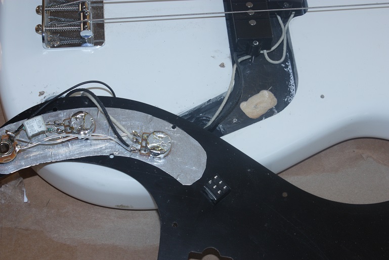

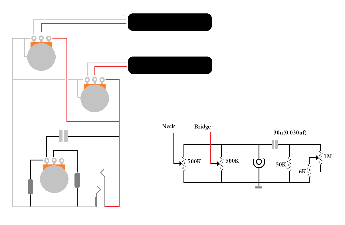

looking at tone curcuit
this is my first passive with two tone controls
plays nice, but 'artificial' and gnarly
appears the tone controls are just one on each pickup
not sure why they call that bass and treble controls
took out the caps and measure them, and they they are both 70n
and, I found one one cap to be very poorly soldered, and loose
quite a mess with all those wires
will change that later
for now I just moved the caps to positive side of signal
nice change, and improved the already good playability even further

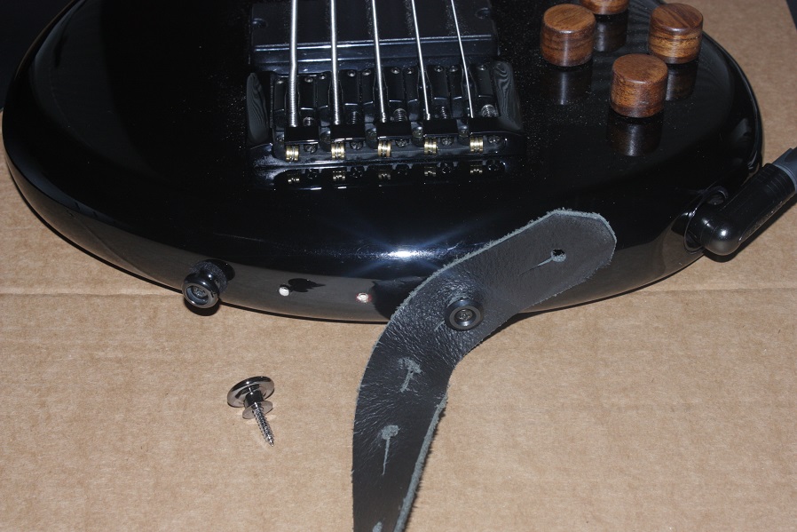

testing different strap pin/button placement
this particular bass have exstreme offset
the experiment started because I found it very stressing
but in the end I have decided to keep it
proved quite good for the low wearing rock style
but absolutely no good for a high wearing
makes this bass feel like a crawbar
a small offset to the opposite side cured this completely
actually, almost feels like it lost a pound or two
a nice surprice

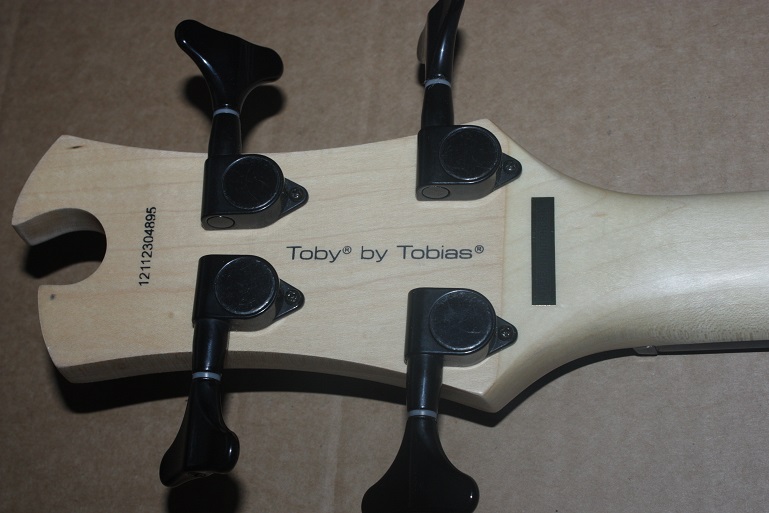

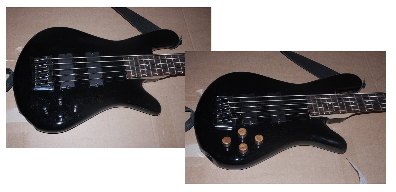

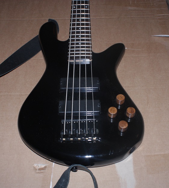

new bass just came in 😀 ... a really cool and cheap Toby

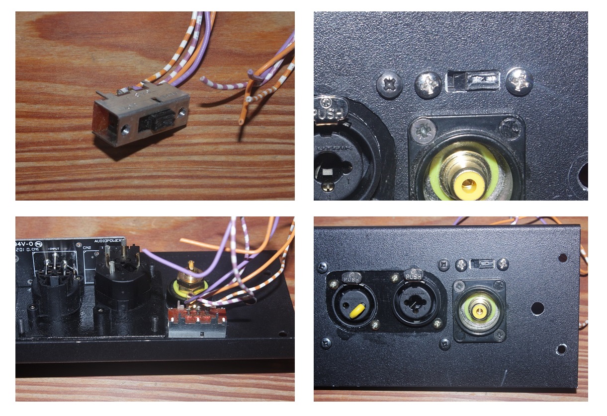

I was lucky today, and found a very nice DPDT switch 🙂
