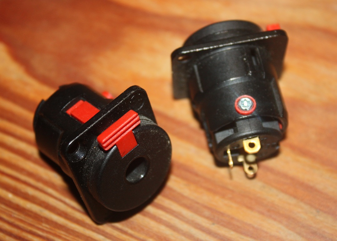

Neutrik makes locking 1/4'' jacks as well.
One place where I really don't like standard 1/4'' jacks is on amp's speaker connection. That or banana plugs on PA systems. That is potentially dangerous. Neutrik Speakon connectors with twist locking are very good, fast to set up and better connection.
Still not 'unsafe' - and you only get a very brief 'blip' as it falls out anyway -
If you have an active instrument with the standard power switching scheme the full battery voltage hits the tip as the plug comes out and the tip contacts the middle connection on the jack. That can and will blow drivers in some cases, and definitely sounds horrendous IME.
.... That can and will blow drivers in some cases, and definitely sounds horrendous IME.
thank you 🙂
like these

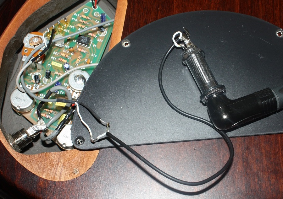

oh man, another active disaster 🙁
my 5th bass
but first time I tried to buy used, second hand ... and last
again ... lots of work ahead

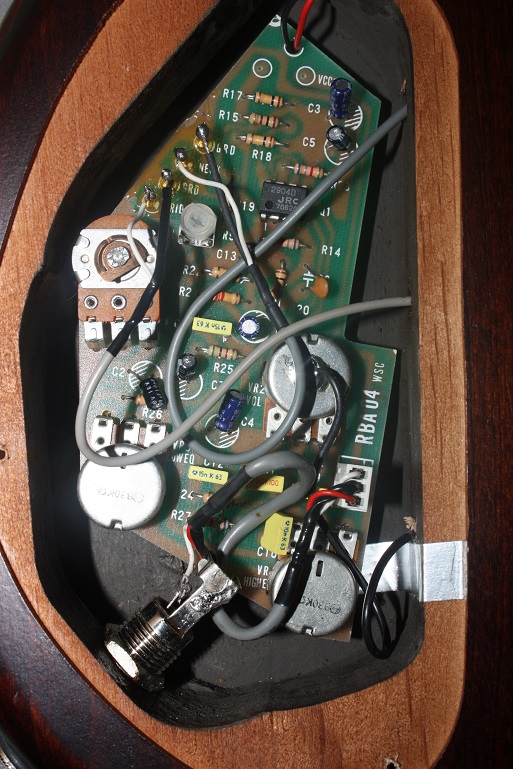

can't believe people are actually trying to play instruments set up this poorly 😱
So what's wrong with it?, there's no obvious problem with the picture?.
don't know
maybe it works like intended ... and if so, that is definately not very good 'intentions' 😛
either its just crap, or its got an error
but before ripping out its guts I will try and connect pickups through exstern pot and jack 😉
don't know

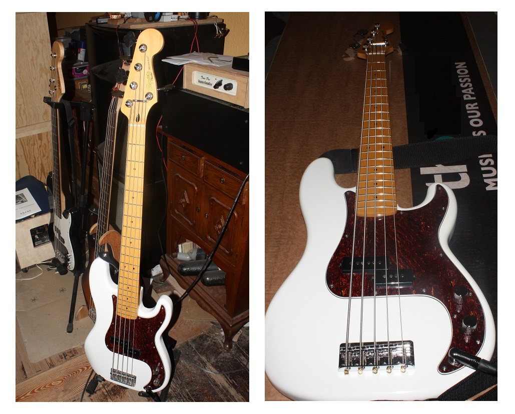

3 weeks ago I bought this bass
only made small changes, and adjustments
and apart from the feeling of ripping off my shoulder, its been a very nice experience
fully passive like I want it
feels very nice, and plays easy and fast, and with very long sustain when needed

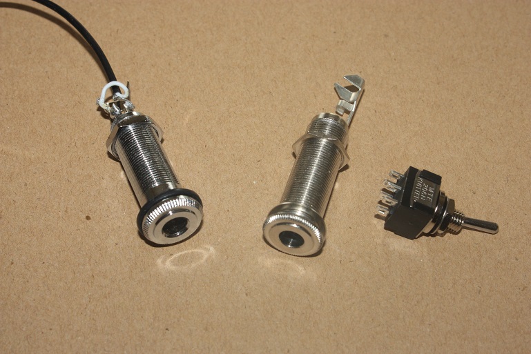

but the jack plug is crap
definately have to be changed
new jack plug(Allparts) for my cheap J&D 5 string
and this one holds on to the jack like it will never let go 😀
and a nice DPDT switch (2-pole, ON-ON)
for choosing series or parallel connecting of the P split coil pickup on my new Squier Fender
its parallel connected now, which definately sounds cleaner, and faster
but I also thought the original series connection had 'something'
