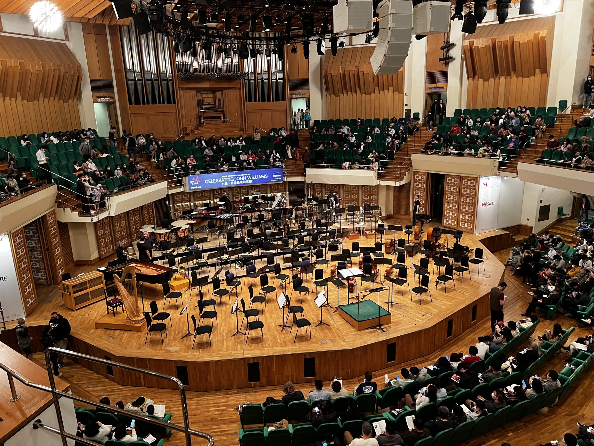

A week ago: John Williams compositions live:
Vs.
Not hard to be sure which sounded better, but the speakers don’t disappoint, even in absolute defeat!

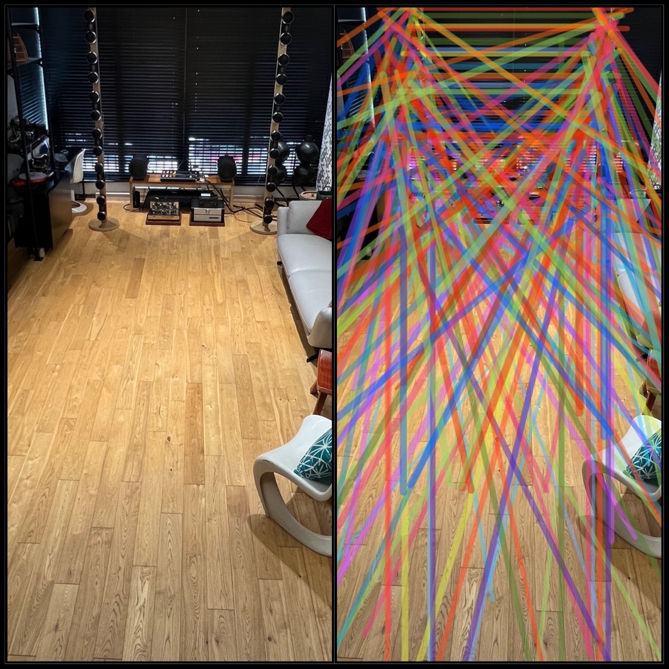

A recent visitor to hear these speakers insisted on sitting at equilateral spacing. He’s of considerable experience in listening to diverse speaker models (most audio gurus in my neck-of-the-woods are, by virtue of geographic-borne opportunity 😉 ).
I indulged his preference without contest, only later suggesting he try other positions, too. He realized without any posturing from me that there was rather little difference in impression from his original [equilateral] spot to that of almost any other.
Indeed, shortcomings tradeoffs exist as with any speaker. All is likely compromise. But I took that session as one more feather in the cap of this bird flying just as it should.
Not many in-home setups can offer a satisfactory listening triangle palate that, if diagramed, more resembles a nightclub laser light show…
…and that image doesn’t stylize the last ~third of the room’s listening distance options. It’s fun.
