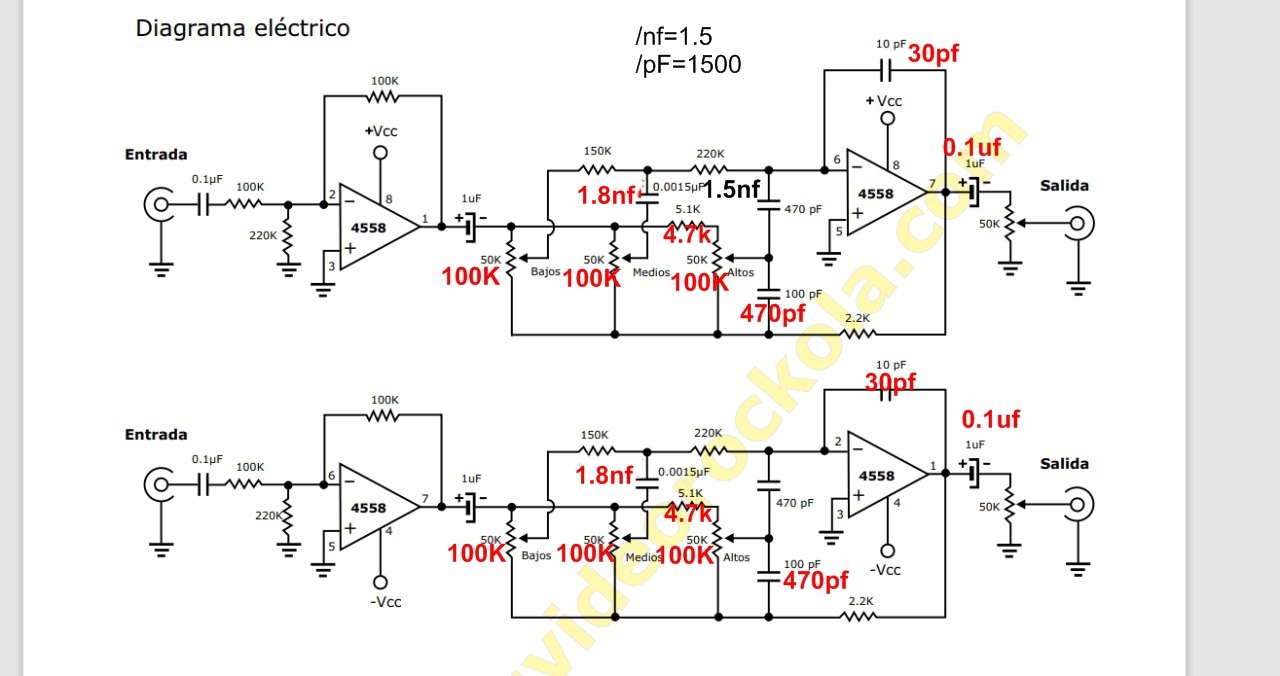

Please find attached the circuit of the board which works for me. The stuff marked in red are changes I found on my board. My board also uses the NE chip not the 4558.
This board works with zero oscillations the only problem is the Mids control is not so good need to work on that.
This circuit is fundamentally unstable and will be problematic.
The circuit is loading the inverting input with a capacitance to ground on the treble control, so the noise gain is very high and you are introducing significant phase shift. This is going to make the opamp you use critical, and the problem will be worse with high GPBW opamps like the OPA or LME devices. I think this circuit would work better if the main gain elements were single transistors where the overall loop gains would be much lower.
I've snipped the treble circuit out and done a quick analysis to show you what's going on here:-
To mitigate this problem, you can insert a resistor in series with the 'altos' pot wiper - try 100 Ohms, that should help. (I used the LT1115 because it is a high loop gain opamp, so will show this problem up more easily)

The Rockola Scircuit. Which I will include here works the best i.e. zero oscillations. My friend says it sounds really good except for the mids and he wants me to try different cap values to see if the mids can be improved. He feels the mid control is not acting on the mid band but more on the high band.
Anyway as it works with zero oscillations I do not wish to tamper with it.
I would rather get my other tone control boards working. One is the Vasp board and the other is a parametric Eq by Xtreme amps.
I have a circuit for the vasp. I dont have the schematic for the Parametric and I am in the process of making a schematic for it. The fact that its been painted over to hide the circuit makes it a bit hard.
Bluejay with mid (Vasp) is oscillating. Rockola is not. Black text in rockola-salcon is original values red is values the board was sold to me with. The parametric board I am still trying to make a schematic off.
