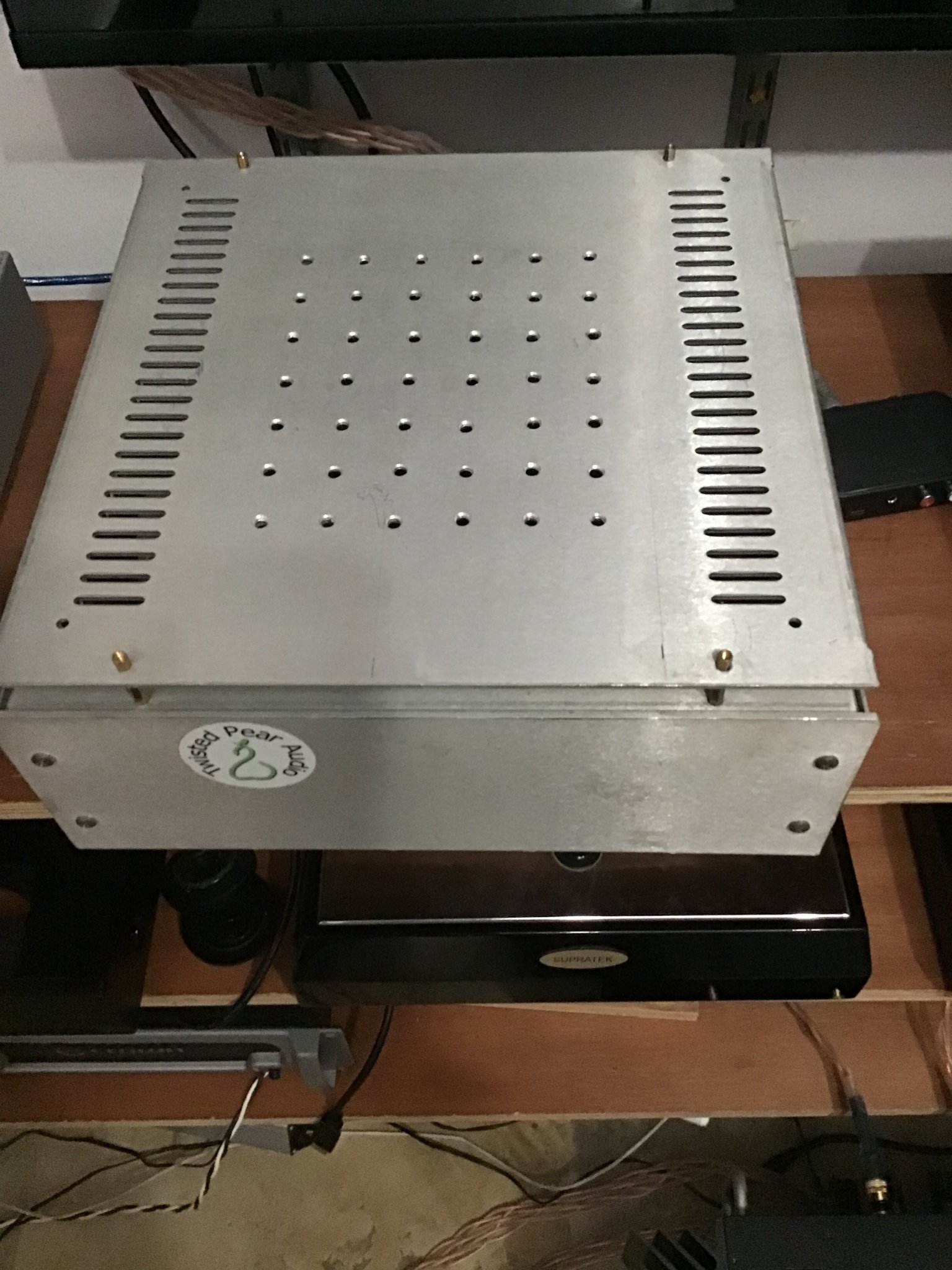

My Buffalo build emits a lot of heat. Whenever I turn it on to play I remove the top cover, which has much more ventilation holes that shown on the top cover for this project. I do not know if it has to do with the regulated power supplies implemented, Placid HD and Placid HD bipolar. The heat sinks get pretty hot, that is expected, but the top cover if not removed, really, really gets hot. I do not know if this is healthy for the unit and how to mitigate it, other wise, than removing the top.
Maybe Francolargo could shed some light on this! Do your top plate in your builds get hot too?

My case is sealed. I was using Placids sinked into the aluminum case. Heat was no problem. IIRCC, DAC was using 30 watts. Recently I changed DAC power supply to Centuar (not sinked to case). Now using 6 watts. DAC power supply is on 24/7, case is barely warm to the touch.

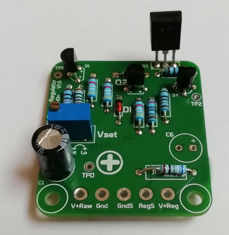

Got some time yesterday to build a pre-regulator and test it.
Works as anticipated, so I'm pleased.
Fast boot feature works: ramps up to ~4v within.. 1/10th second..? on powerup before disengaging and letting the regulator noodle up to 5V operating point.
Trimpot sets output voltage with high degree of accuracy; 20 turns to set a 10v range.
DC output impedance is measured at a high-ish 0.8R but I can live with that. Worst case scenario, in this specific application and my planned configuration, is c. 225 mA max load for the Vd rail, feeding Vd, Vdd & Dvcc. That equates to 0.2v output drop from offload to max load.
The AD7151 regs are LDO, with a dropout at max load of ... 0.6v IIRC? So I can set these pre-regs to 5V offload to be safe and still be within a comfortable operating margin. Preregs themselves require about 5v in-out but my transformers are running at ~12-14v so again comfortable margins.
Additonally, dynamic output impedance is much better- falls rapidly above DC to ~ 0.03R by 10Hz (IIRC) where it levels off. Its based on a capacitance multiplier if the above didn't suggest that topology but i've refined the design over probably 20 years. Most schematics you see on this topology fail to really leverage the benefits and eliminate the weaknesses IMO.
Pros:
very stable- no oscillation even with no output capacitance, indifferent to the ufs if there are some.
good line and load rejection for a single stage regulator, acts pretty close a brick wall all things considered.
Very high bandwidth, far beyond any feedback-based design ive encountered.
very low noise.
Goodish dynamic output impedance
Cons:
slow rise time, measured in seconds.
highish DC ouput impedance
can drift a little under heavy thermal effects
As long as you understand what compromises are involved and what your performance requirements are, it can be an excellent solution. To my mind it should do what I want it to here; act as 'domestique' to the tridents:
block line noise getting to the AD7151 and stop digital hash getting back into onto line while providing a good low impedance low noise supply for the single Trident to work off. And most importantly wont oscillate when stuck in front of the trident's low impedance input caps.
I've tried the topology directly on AVcc in the past and it didnt work at all, totally dulled the sound. Seem to remember Russ mentioning very low impedance is required in this location. So its good where it is IMO.
next step: Build another 4 of the things. Takes about 40 mins to assemble and test each but I'm looking to be time poor over the next 2 weeks.

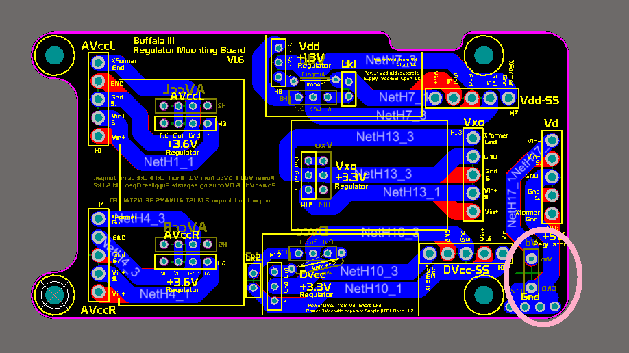

Annoyance to deal with: spotted a pcb error on the Trident mounting board, polarity of the Vd header is back to front, gah.
Typical. But at least I spotted it and everything else checks out. its not ideal but I'll cludge a workaround for now. Next time I do a board run I'll add a replacement board. it shouldnt matter but I know from experience if I have to service the unit in a (few) years time I'll not know what that was about and probably fry something.

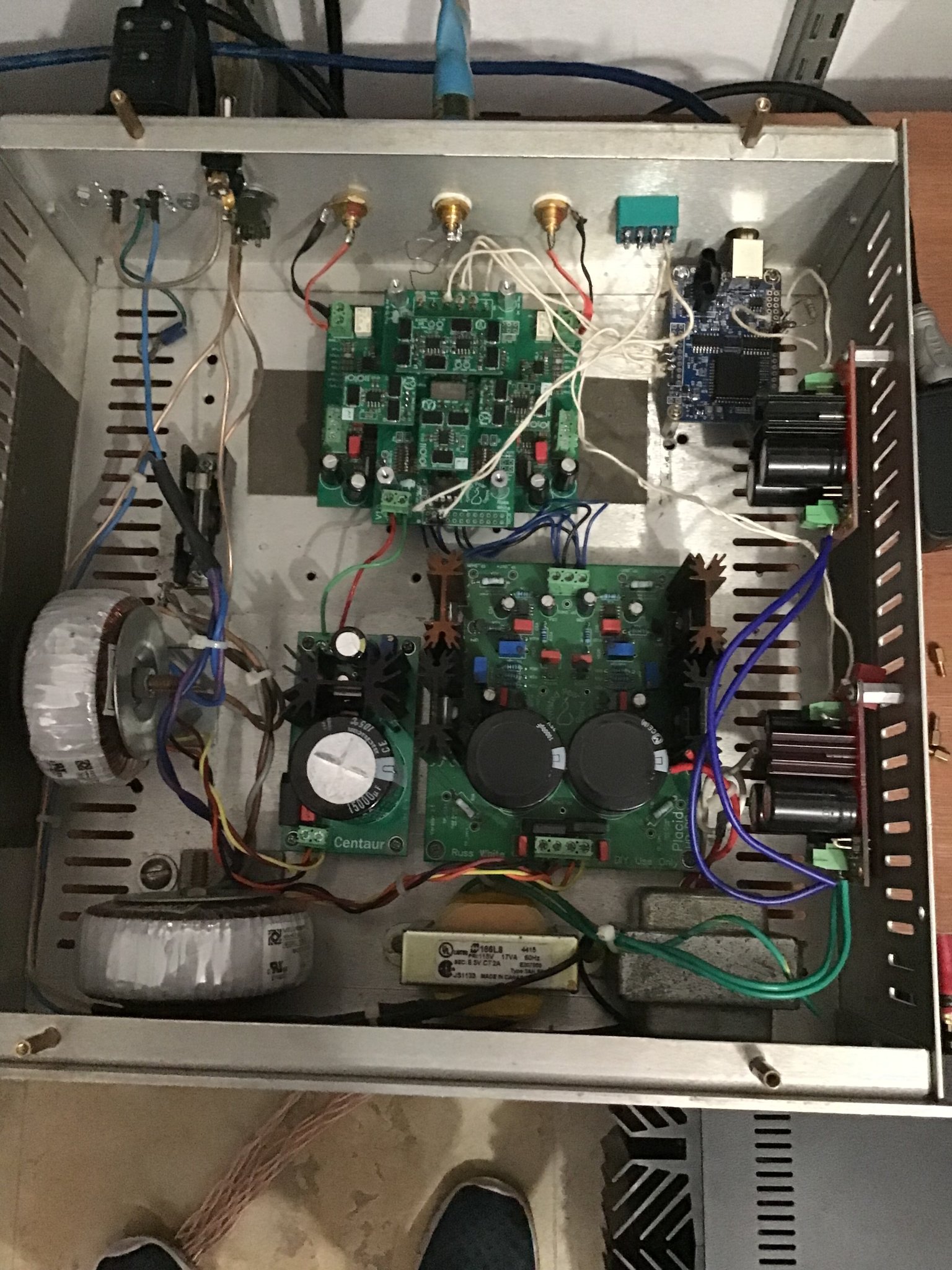

This is my dac project. A few years since completed. Started with the dac 18 board and then upgraded to the 38, as well as the IVY upgraded to the Mercury. The upper right hand small board is the JLsunds I2s to usb converter which I was alluding to in a previous post. Ordered a new one and everything is well. And, I was powering the 38 board with the HD 5v supply but I was not able to Upsample to DSD 256 without noise. So now the power supply board is the Centaur which gives the capability for DSD 256 upsampling. Hope this pictures and ced’s project motivate others to build this amazing dac at least until TPA stop selling the boards, etc.
