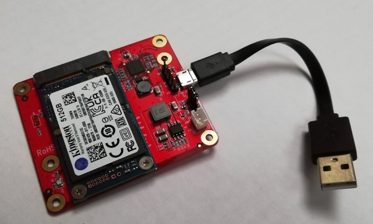

SSD and Raberry Pi mSata to USB converter board from Startech I prepped a while back.
I LIKE the Startech boards, they are constructed to toggle between USB power and offboard power. Perfect to align with design goal of max Power supply isolation between components. USB will supply signal only.
The RPi PCB mounting pattern is also pretty common so likely to make replacement parts or addtional parts easy to mount in future.

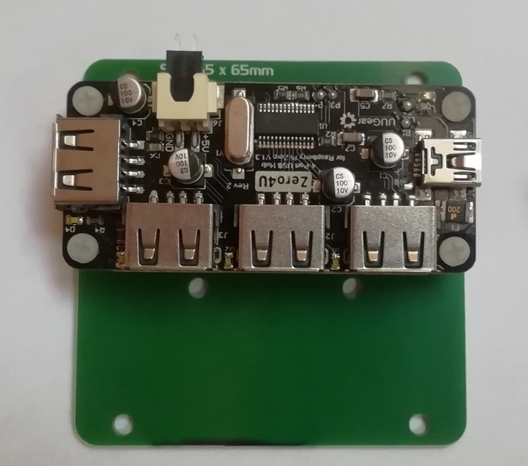

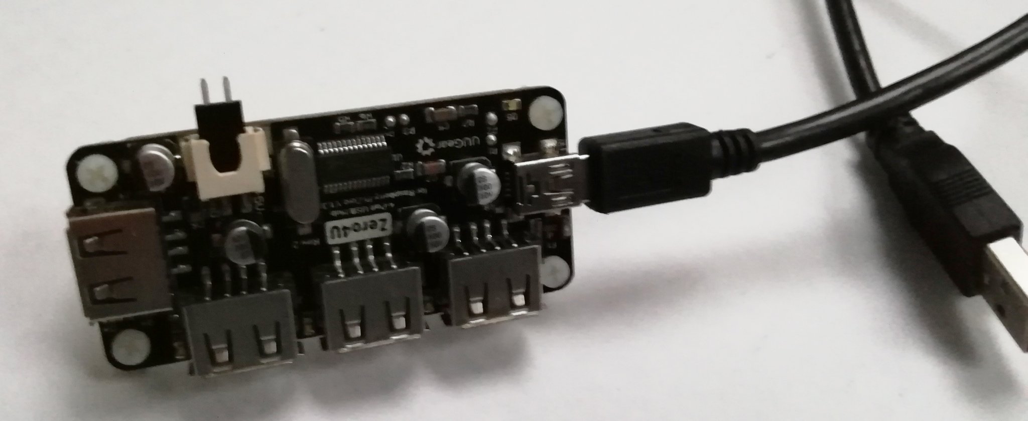

Zero4U mini USB hub I also picked up a while back. Dinky little unit.Will allow ability to plug in a USB thumb drive via back socket, And for additional SSD drives if needed though unlikely to be necessary with 2TB units being freely available now.
I stopped buying hirez formats several years ago as damned if I can hear the difference between them and redbook standard. Production quality makes far more difference than sample rate when I did a few A-B comparsions buying the same album twice. So saved as FLACs I dont need vast amounts of storage.
Again, you can see ability to power from separate Supply rather than via USB.

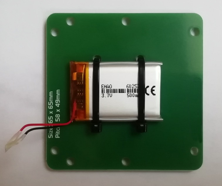

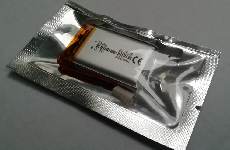

UPS battery for the BBB I ordered online a couple of weeka ago. Bricked one BBB a few years back but been lucky since. Need a more robust approach to power down than crossed fingers though.
I seem to remember having the devil of a time trying to get the battery to work with the Hermes first time around which is why I never implemented it. Will have to have a go again gah.

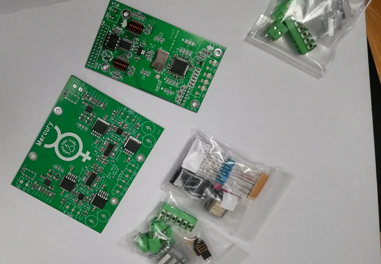

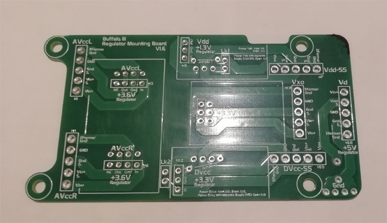

PCBs also arrived from china.

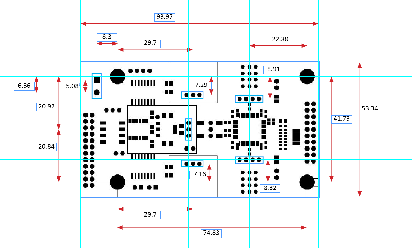

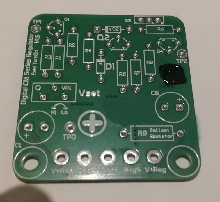

Regulator mounting board for the tridents, fingers crossed all the header pads are in the right position. I had to reverse engineer from a pcb image that was posted years ago.
dimensions came from this, sized up in photoshop. Looks like its a CAD export so measurements should be pretty accurate

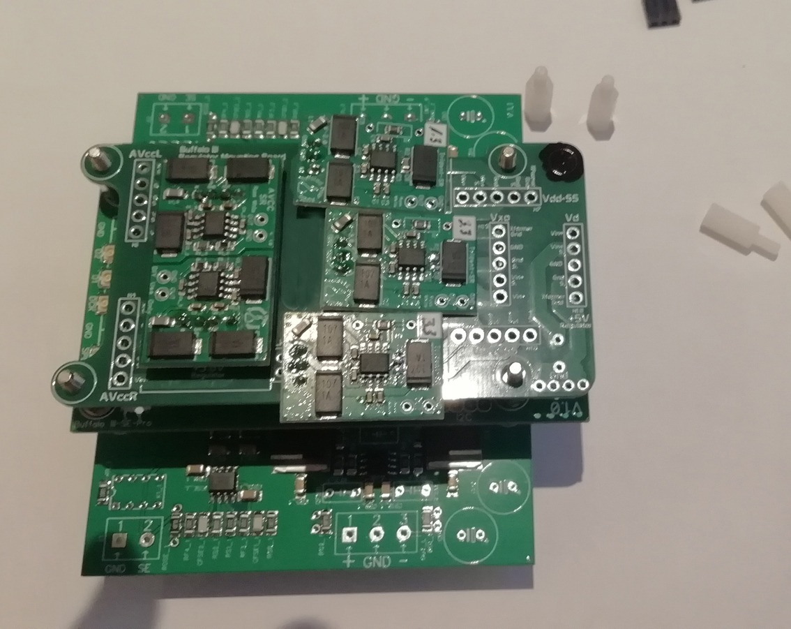

Loose fitting of the Mercury-Buffalo-Regulator mounting board- Tridents with headers.
Boom it all fits, all the headers line up perfectly, 3rd board down. Damn, I LOVE it when a plan comes together.
Well actually, almost. Haven't checked the AVCC pads yet. As usual, its some of the minor fixings that are missing in this case 4 pin males headers. None in my parts bin, sigh. But need to get some slightly smaller PCB standoffs too, so putting together a BOM of missing parts.
Main thing is it works. Need to triple check all the pins too, if I've made the smallest mistake I'll almost certainly fry the buffalo, so gonna triple check that.
