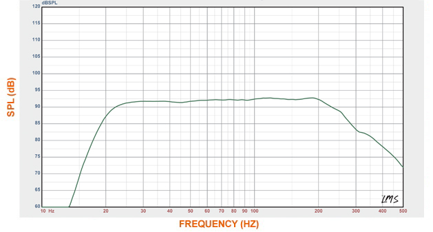

The port size is 4" and from the SVS specs it's tuned to 20Hz (with the old driver).
With regard to warranty.. they have a replacement driver that's exactly the same as my current one and it's in the same price range as that of a Peerless xxls 12".
I was thinking of getting a newer driver, possibly improving the performance of my subwoofer (or noT :scratch1:) as the price would be the same. Looking at the specs of the Peerless and knowing that SVS use one in the newer PB12 sub it would be a possible candidate.
I have manged to get the SVS curve (from the internet).
It looks like there is some flattening by the onboard EQ of the amp, or am I reading it wrong?

Thanks for the comments, I will be getting the Peerless xxls 12 and besides the warnings from SVS that the performance will not be as good (I figure this is a sales pitch) from what I have read and compared from the internet I will be risking it... 😱 lets see how it goes 🙂
