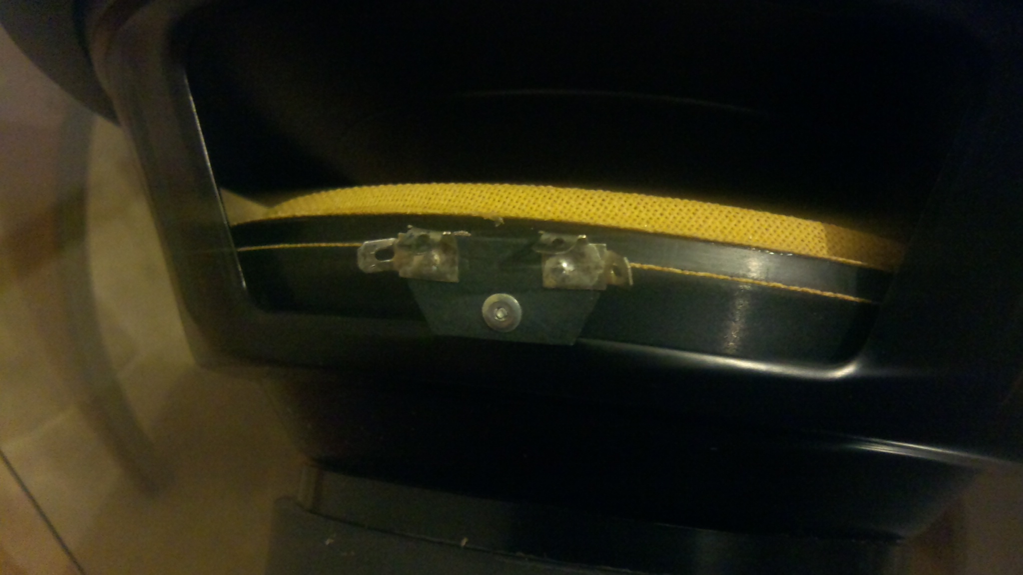

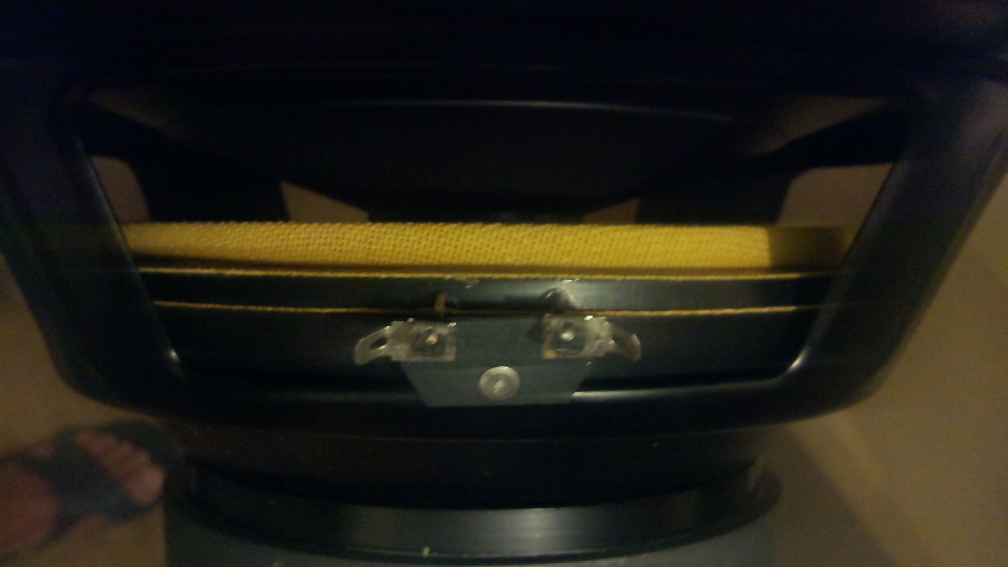

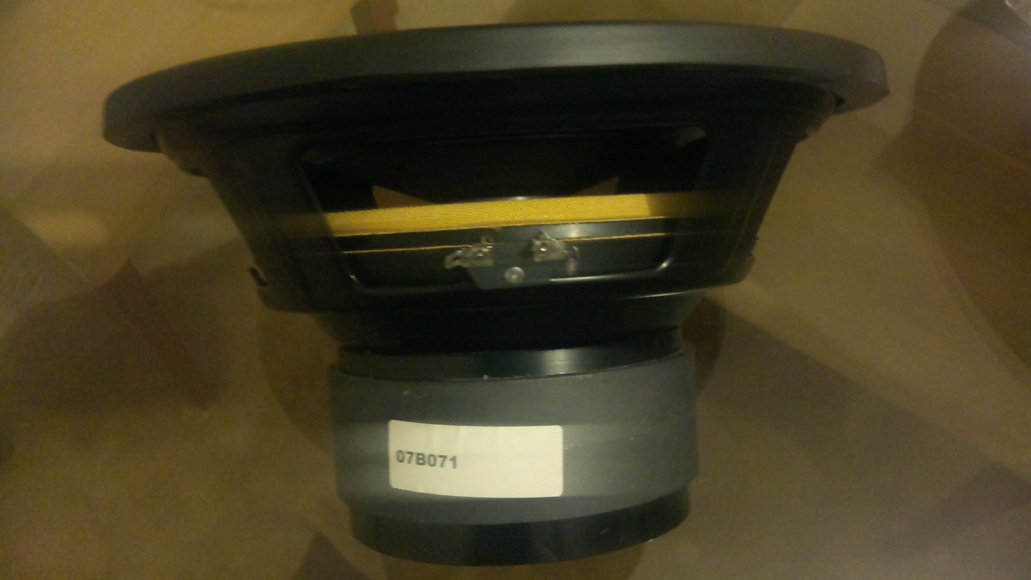

Unfortunately I can't find a supplier here in Europe that has this driver available.
Where are you located?
Hmm, this driver wants a ~176 L to just be a max flat alignment, so what are you thinking, sealed with EQ?
GM
It's a very nice driver sealed, but you right this is not the case...
SVS use custom version of peerlees from what I know and I don't know if there is some kind of electronic filter built in the sub amplifier.I am located in Portugal.
Another driver that "could" work is eminence lab 12 its about 150 euro shipped or the AD12-300SB that is the monolith sub driver, both you can get from BK electronics.
You should also measure the reflex size and insert in the sims to che tuning and wind velocity.
Anyway I think that the best option is to ask a replacement driver, maybe asking for some kind of warranty.
The port size is 4" and from the SVS specs it's tuned to 20Hz (with the old driver).
With regard to warranty.. they have a replacement driver that's exactly the same as my current one and it's in the same price range as that of a Peerless xxls 12".
I was thinking of getting a newer driver, possibly improving the performance of my subwoofer (or noT

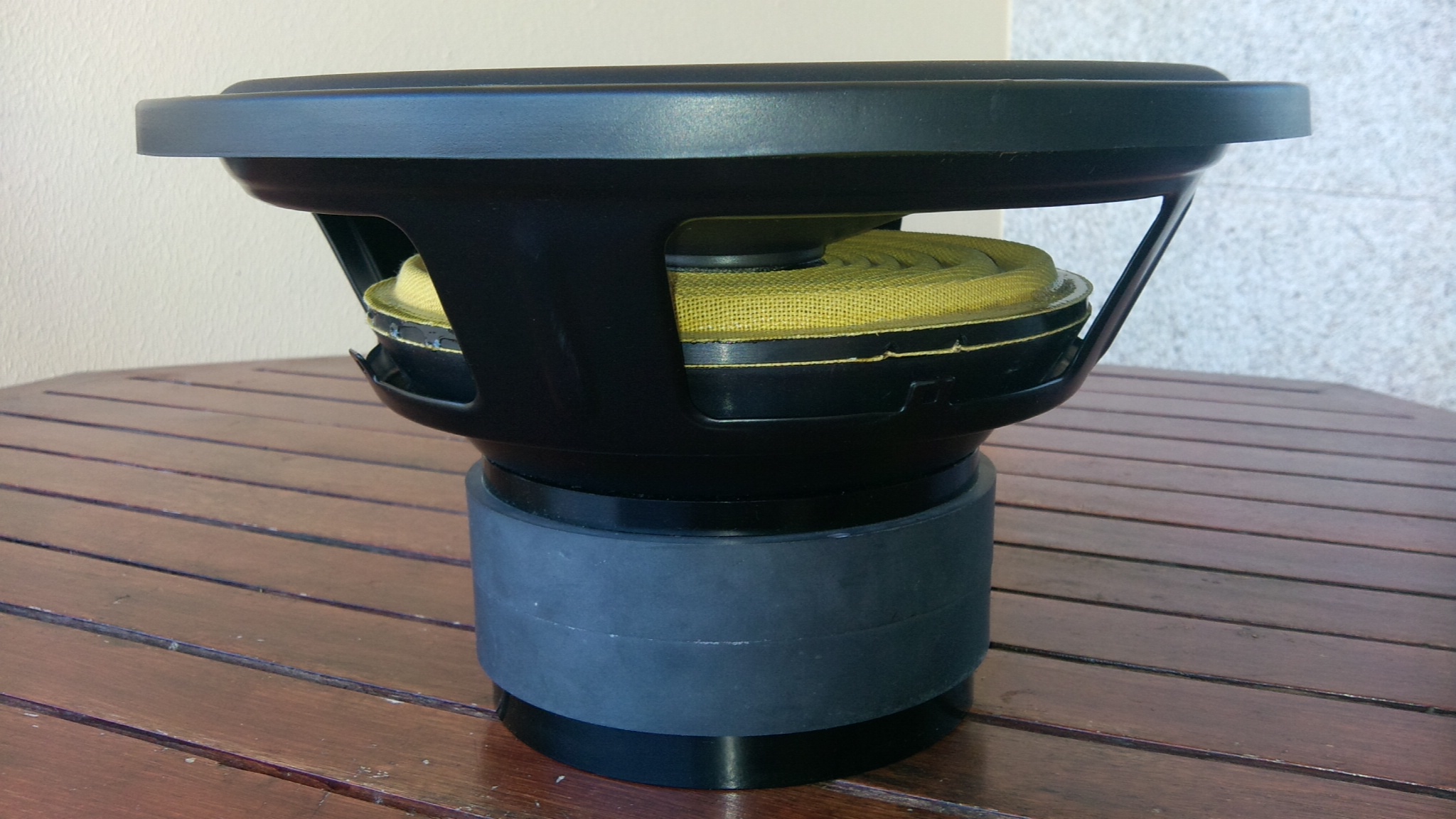

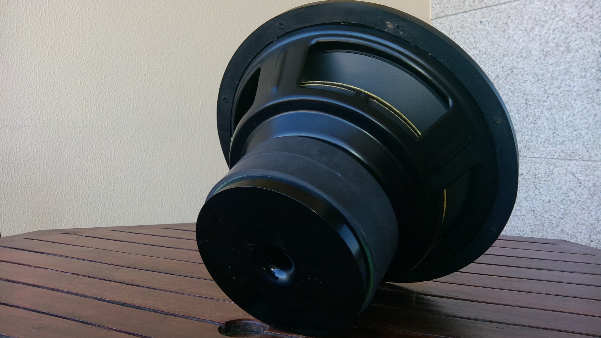

Well I've bit the bullet and bought the xxls driver! I had to cut out approx. 3mm in the inner diametre to fit the xxls driver in lol.
With regard to the result... I am very happy with the outcome.. the bass "seems" to be tighter and more hard hitting. I dont have a frequency analyzer so I can´t tell how low it goes but, listening to SACD of Norah Jones and Diana Krall the sound was VERY well defined, deep and overall solid. I would even risk to say it's better than my older driver, there seems to be more definition to the base impact (if you can call it that) lol.
All in all I am happy with the decision to go Peerless instead of the SVS replacement. I do blieve after hearing the xxls that's it's a superior driver 🙂
