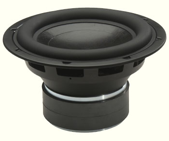

I have laid my hands on a SVS PB10nsd woofer and the 300 Watts BASH amp
I also have found someone who has measered the TS parameters
some further info is the vent is about 34 cm long and 3 inch
in diameter
some calculations give a netto volume off 62 to 64 liters
someone ever cloned or rebuild this subwoofer, it will only be used for movies

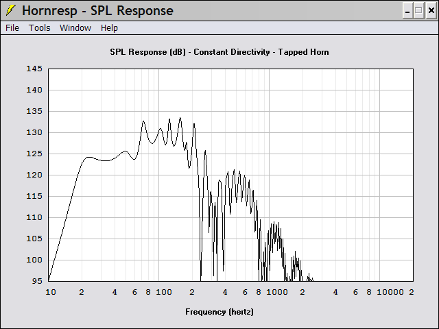

Anyway, based on these specs a max BW alignment will be around 0.707*Fs with a ~ Vb = Vas EBS alignment, but due to the low Vas the vent will be excessively long, so a mass loaded reverse tapered TL (ML-TQWT) makes more sense to me. Corner loaded it should be solid into the teens, though its low Pe will keep it from getting to DD/DTS reference level if that's a performance goal.
Now if you can 'afford' a larger, ~81+ " tall cab and the T/S specs are close, a tapped horn sims an eyeball flattening ~125 dB with only ~140 W, but the trade-off is it's ~280.64 L + all the panel thicknesses, though if it can be laid down along a wall to fire into the corner it can be fairly small in cross section with only one bend 122+" long and of course more folds can be used to reduce its height if taking up a larger floorspace isn't a major issue:
