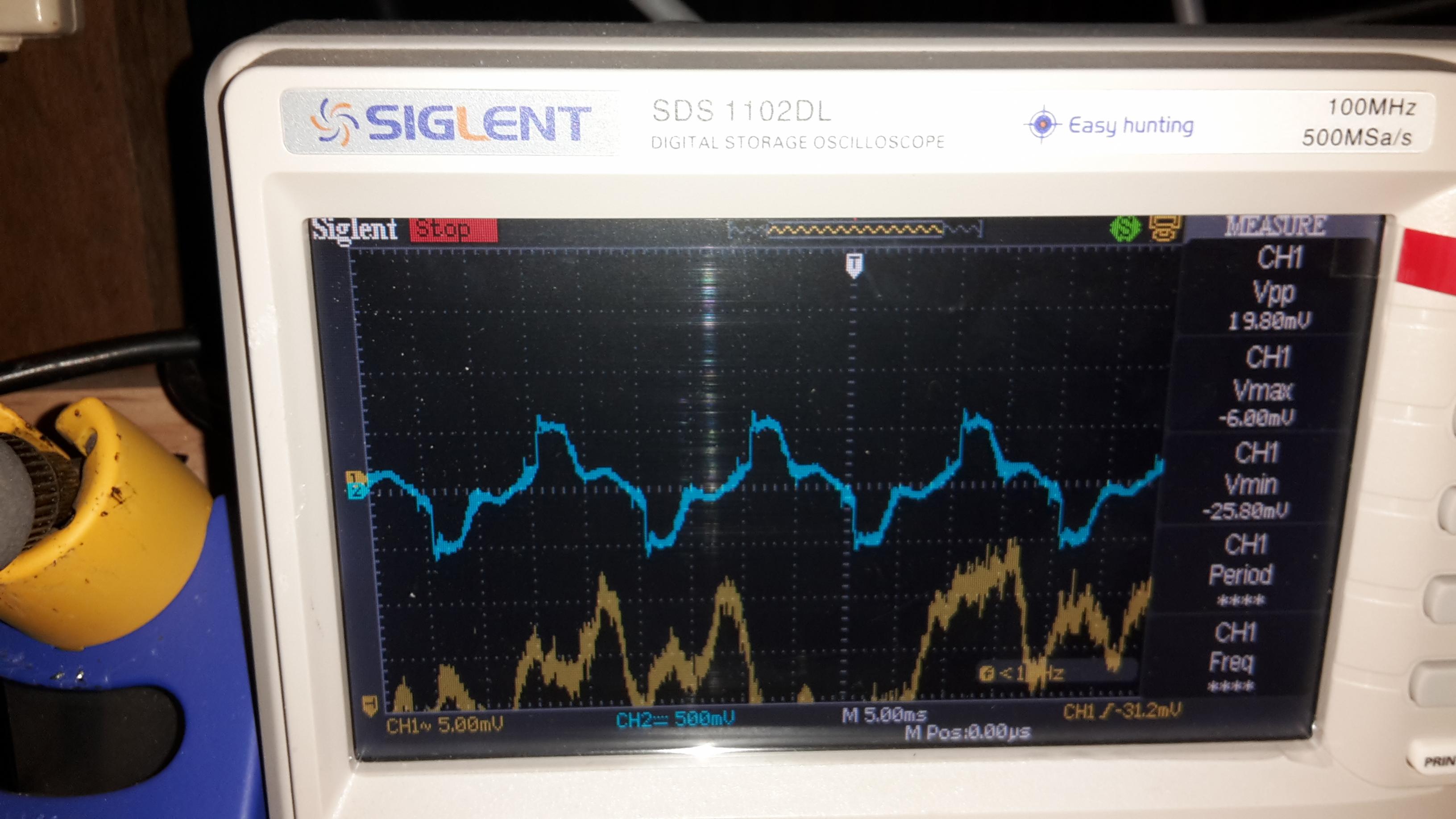

OK so with bibs and bobs i had available i put 11 ohm resistor 10nf cap polypropylene and 2 diodes oposing between the safety ground and signal ground. This had no effect. I tried it because I should have earlier but did not.
The other is the safety ground and neutral trace seem to be leaving some sort of artifact on the output signal. Hard to get a good pic of it though.
The yellow trace was taken with no amp connected and a shorted input. Phono stage selected and full gain on linestage.

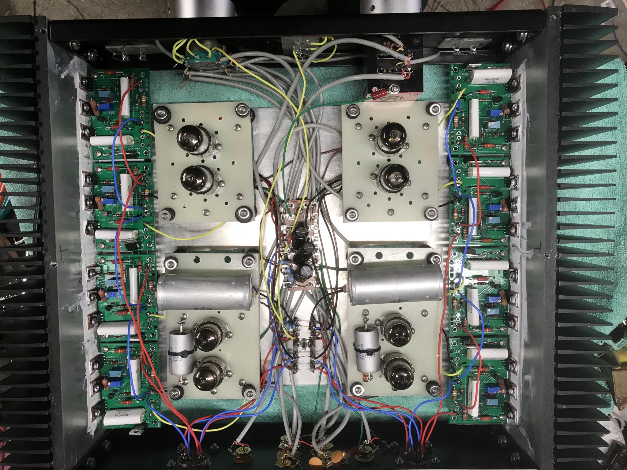

Semi complete in previous picture. The raw HT and heater supplies are in an external box. I am not using super reg. But I am using 8 shunt and Ccs regs. Each node has its own. I have built them with 2, then 4 and finally 8. Each time it got obviously better. Uses more power than most power amps.
