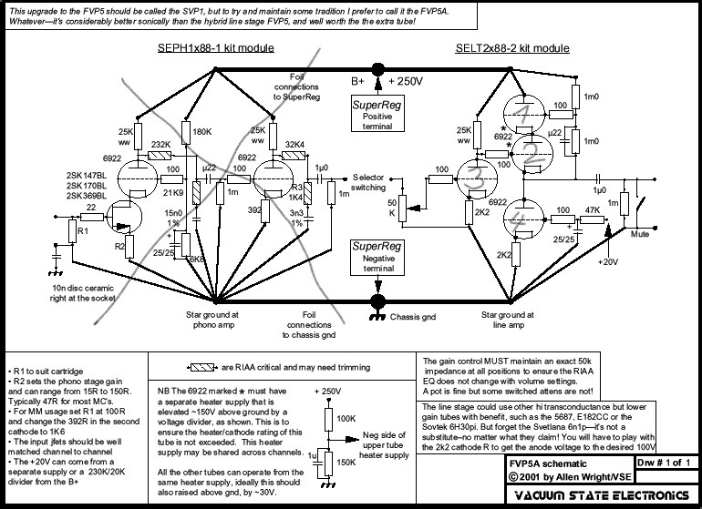

I am building FVP5A amp and maybe someone can help me with some questions. There are in line stage tubes that are marked with ✱ star sign and these tubes need to have a separate heaters. Are these star marked tubes as one tube or two different tubes (on the right these two upper tubes)? Using this showed voltage divider where should I connect this elevated 150V? Says that to the negative side of upper tube heater supply but I do not get it. 🙂 Any help would be appreciated.

@rchamber My focus with this schematic will be to get out the best possible sound. To make sure that I understood right.
Tubes in line stage marked on the picture as 1 and 2 are as one tube and this tube heater pin 5 is elevated +150V.
Do I need separate 6,3V heaters supply AC or +, gnd to connect this to the tube marked on the picture as 1 and 2 to heaters pin 4 and 5 adding this elevated +150V together with one heater supply pin 5?
Pin 4 is gnd or separate supply gnd or AC?
Is possible to use tubes 1 and 3 as a one tube and 2 and 4 as second tube and if it is then is there a difference in sound?
I am planning to use 6H23P tubes as a start and later 6DJ8 or 7308 tubes. Would these tubes work with this schematic?
Correct.
You will have to figure the heater supplies yourself.
No. No clue about sound differences.
Bad idea...I would stick to Allen's recommendations. Either build it as designed or take his suggestion about trying 5687.

I use two separate heater supplies per channel in my SVP. Yes, they need to be electrically isolated from one another apart from the elevation circuits, so you need separate transformer windings, rectification and smoothing.@rchamber My focus with this schematic will be to get out the best possible sound. To make sure that I understood right.
Allen grouped the triodes the way he did because of his strategy for elevating the heaters - the dual triodes share a heater, so they need the heater to be at a voltage that works for both halves. I don't think combining 1 and 3 in one envelope would work, for this reason. Why did you think this might be preferable?Is possible to use tubes 1 and 3 as a one tube and 2 and 4 as second tube and if it is then is there a difference in sound?
Allen never said anything against 6H23P, but these have different bias requirements so you would have to alter the cathode resistors and really know what you are doing to get the target currents and voltages. I agree with Robert in this respect.I am planning to use 6H23P tubes as a start and later 6DJ8 or 7308 tubes. Would these tubes work with this schematic?

@Alex M for the heater do you use DC or AC voltages? For me putting together heaters DC voltage + and elevated +150V very strange. Does it work this way? Does this elevated +150V do not effect the DC regulator?
Basically 6DJ8 is 6922 and should work in this schematic? I could not find suggested suitable tubes for this schematic besides 6H30, 5687, E182CC.
Allen recommended current regulation, which is what I started off with, but I found that the EH 6922s I used had a non-standard heater current, which meant the voltages were too low with a 300mA current. In the end, and to allow me to experiment with different versions of the 6922 valves, I switched to voltage regulation.
The voltage elevation only sets the voltage at one end of the filament, so no problem.
6DJ8 is basically a 6922, but with a different heater current and a lower maximum anode voltage rating (though Allen uses much lower voltages than some designs, like the ARC SP-10, for instance, so this is not an issue). If you use voltage regulation for the heaters you should be able to swap in any member of the 6922, ECC88, 6DJ8 family. 5687 is quite different, with a much lower gain.
