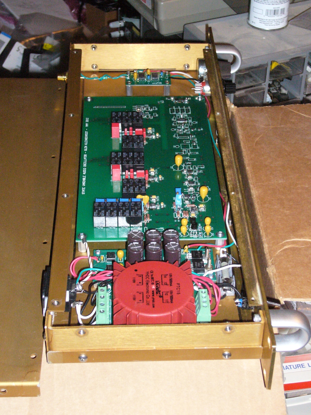

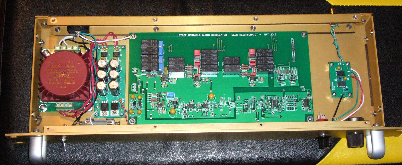

More updated photos. The SMD's take soooo long to install. I much prefer THD's instead. It's looking much more like an oscillator now. I had to order some more parts so that will take a while to get here.

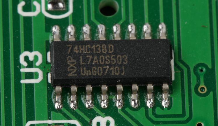

Has anyone had trouble identifying pin 1 on the HEF4051BT MUX/DEMUX chips? I got the data sheet from NXP Semi, but the markings they show are not on these chips. They are 16SOIC package. I did the best I could at guessing, but if someone has a positive way to identify pin 1, please share!
Hi Anders, This is what I'm dealing with. The NXP chips have no dot, no bar, no dent, no nothing. I had to guess based on the text on the chip and it looks like I guess right. Thanks for the link! much appreciated! (I can check to see if there's a beveled edge on one side, but I didn't notice one. The data sheet is completely wrong!)
Dirk

Hi Dirk,
Ah, you have a different 4051 chip than I have. I was certain that I had the same as you, clearly not so.
Well, I friend also built this generator and I checked with him just recently and apparently he has the same NXP chip as you have. According to him, there is a beveled edge (barely visible).

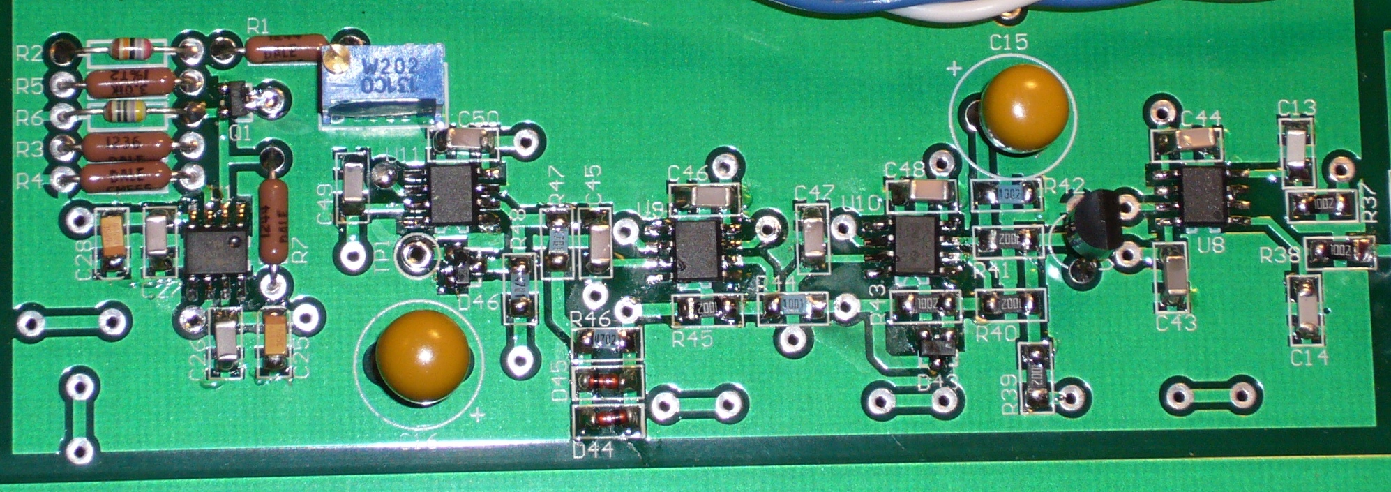

Here's a closeup of the voltage reference, error amplifier and nearby parts on the board. I got some voltages that look suspicious. First, there's 14VDC on pin 7 of U8 (the output), but very low voltages on pins 1 and 4 (inputs) of the same chip. There's also 13VDC on pin 2 of U9 (input). The other input is pin 3, which is connected to the above pin 7 @ 14VDC. So, I think there's something wrong with U8. I can't see any solder bridges, the chip doesn't get hot, and it's install correctly. Should I order another one and try to replace this one?
I noticed that the solder joint for pin 2 of U9 and U10 may not be perfect, but as I recall there was a solder bridge there so I used solder wick to clean it up. That usually doesn't cause a problem but who knows.

I fixed it!
Congratulations! Good work!
There was a solder bridge across pins 2 and 3 of U8, neither of which are used by anything.
Please be careful with your verbal descriptions. You may need to re-calibrate your way of looking at things.
Those two pins ARE used for something! They are used to set the voltage gain of the instrumentation amplifier U8. It just so happens that leaving them open-circuit (i.e., no components connected to them) sets the voltage gain of U8 to 1 V/V. By connecting pin 2 to pin 3 (i.e., the short-circuit solder bridge) you set U8 to its maximum available voltage gain - something greater than 1000 V/V. (According to the formula in the Data Sheet the voltage gain would be infinite, but in reality the limitations of the physical part will limit the gain to something less than infinite.)
The part is specified to operate with voltage gains between 1 and 1000, so all bets are off regarding the part's behavior when the resistance between pin 2 and pin 3 is much less than 50 ohms or so. Operating with lower resistance between those pins, or even shorting them, is unlikely to cause damage to the IC.
