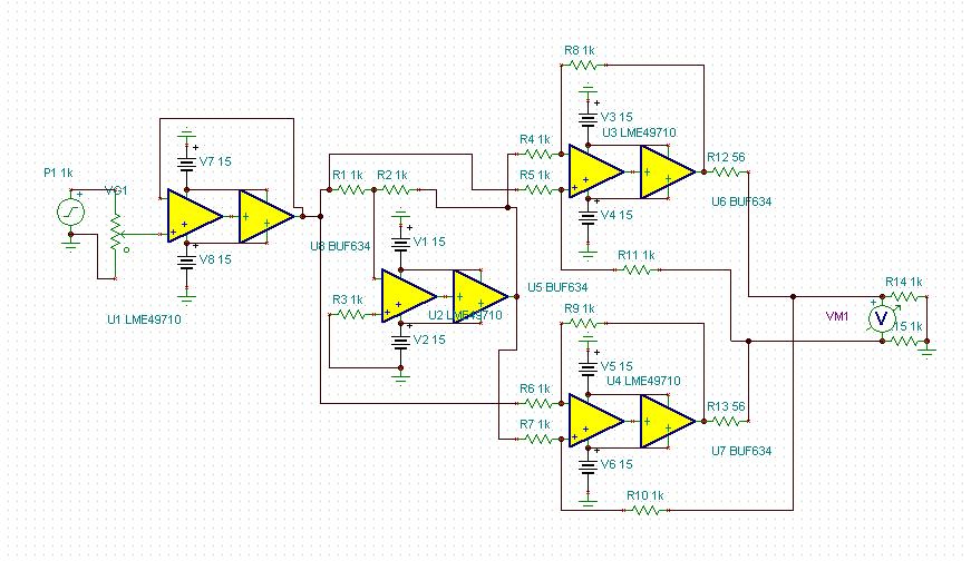

I'm working on a xfr based single ended to balanced converter. I need to build it, but it simulates at less than 1ppm THD. The circuit uses a balanced mixed feedback arrangement as documented by Lundahl and Walt Jung.

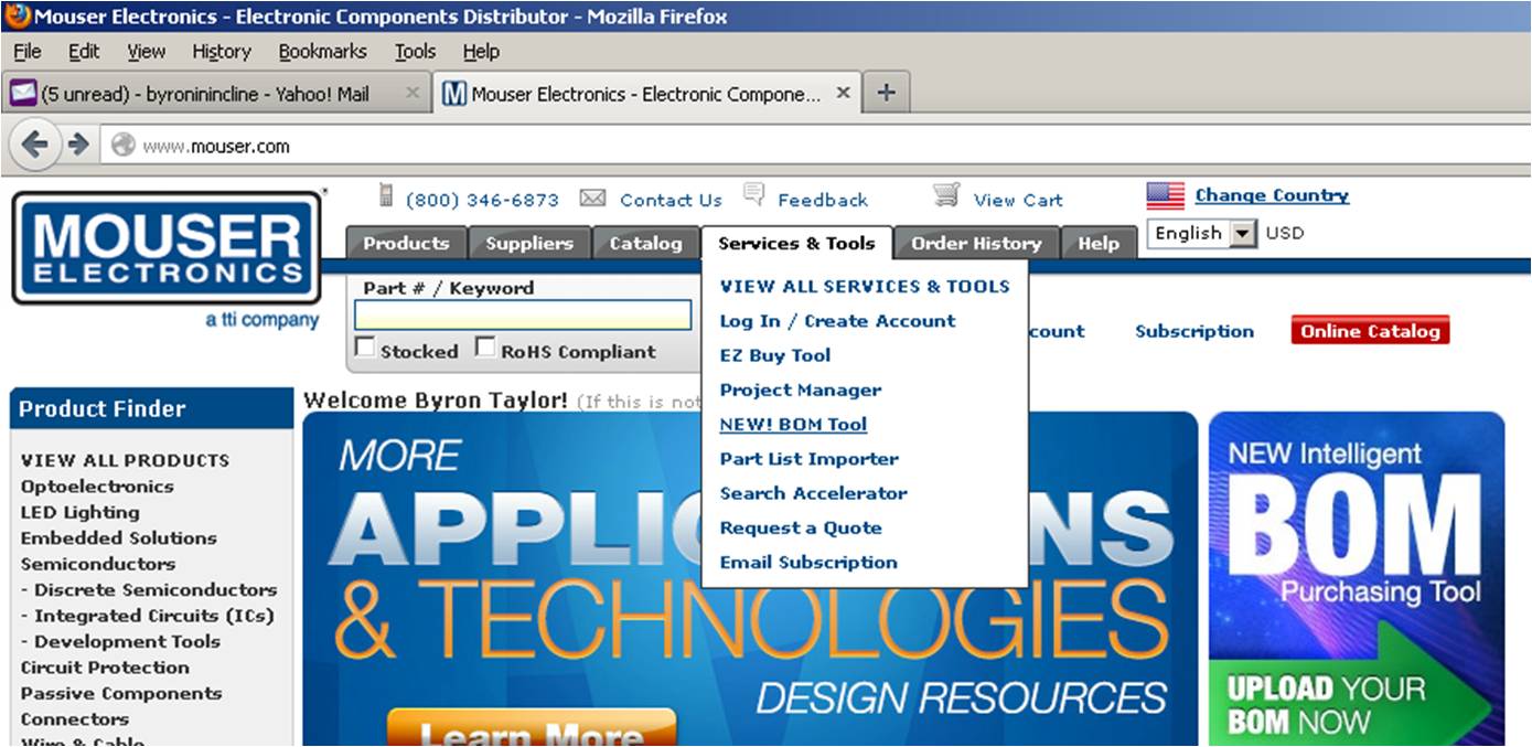

I converted the BOM dirkwright posted into an Excel file, then saved it as a tab-delimited text file. I posted the text file here for others to use. Here is what you need to do:
  1. Open the "Oscillator BOM.txt" file I posted in Excel or other spreadsheet software, and save it as either an Excel file, or a comma-separated values file (*.csv).
  2. Go to Mouser, and opened up their "NEW! BOM tool" (see first picture)

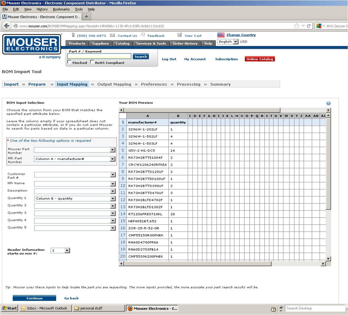

  5. Mouser will move to the "input mapping" step, where I filled in the drop-down menus as seen in the second picture.

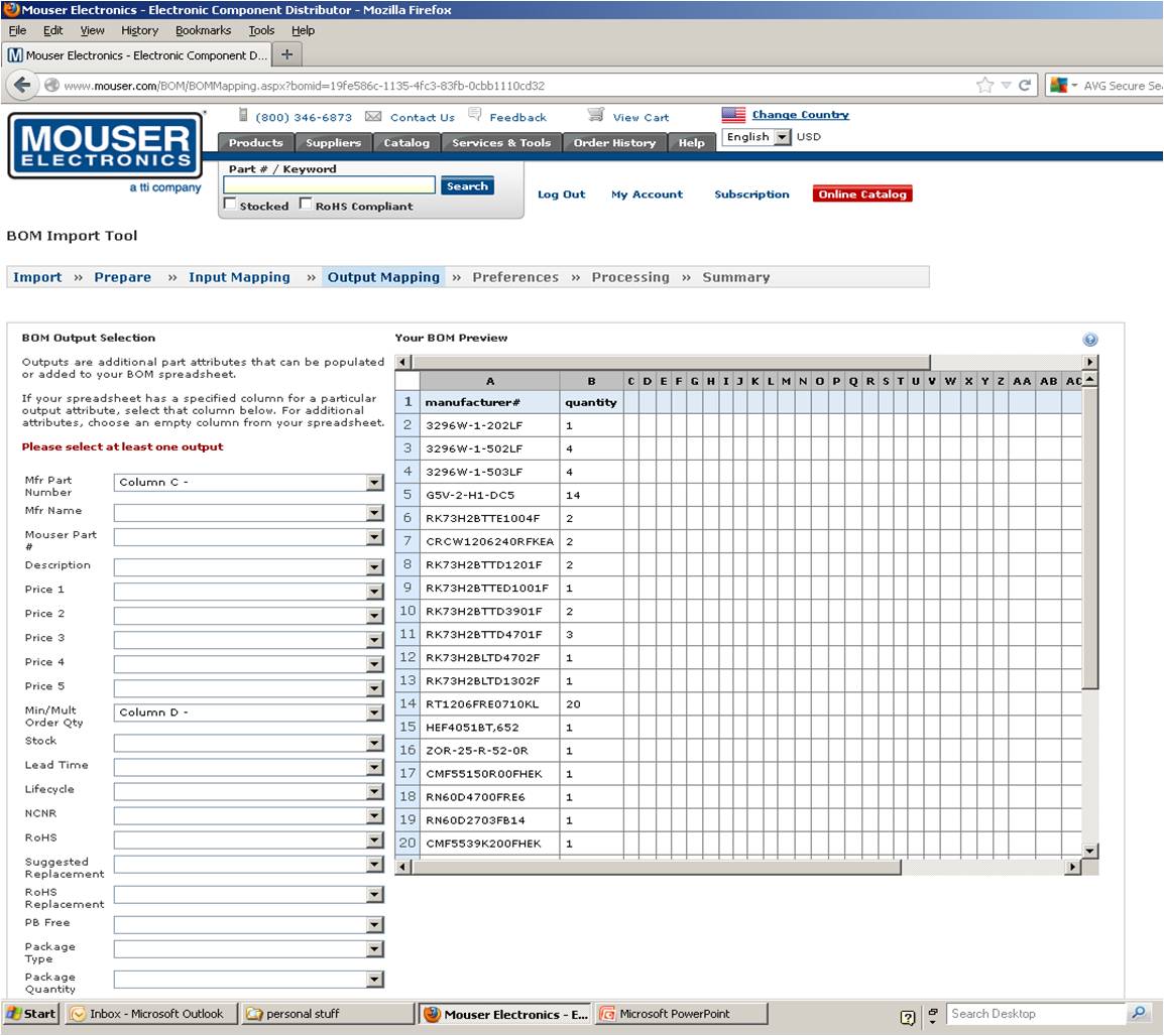

  6. Mouser will move to the "output mapping" step, which I don't understand at all. But I found that if I chose column C for the Mfg Part Number, and column D for the "Min/Mult Order Qty" the software allowed me to continue. (see third picture)

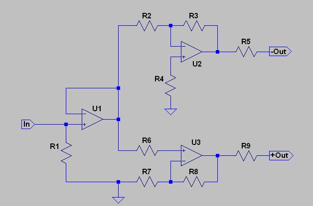

Well, his version has a problem in that if one of the outputs is grounded, then the opamp driving that will have to drive a 100 ohm load, which is bad.

I've been working with a low impedance version of the cross feed circuit but do not know if it will be stable. In simulation, I'm getting 1.5x10^-5 THD and S/N of 125dB. The four 1K resistors around each of the output opamps could be precision resistor arrays in 8 pin dip format. I'm nervous about this though since others talk about how it is unstable. One problem with working on these high performance circuits is that a purpose built PCB is pretty much mandatory, at least in my experience. I've soldered up several different kinds of designs on regular test boards and things don't go very well sometimes. So, this adds to the expense of developing something really nice. I've gotten pretty good with Pad2Pad software. <g>

I usually do (did) balanced conversion as shown in the simplified circuit below. Buffers could be added. First OP-amp could be inverting in order to remove some common mode distortion.

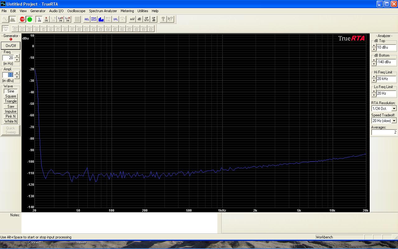

Out of curiosity, what sound card do you use? I'm referring to the TruRTA graph in post #35.
Oh, I'm embarrassed to say actually. Right now, it's just a little Behringer UCA202, which TrueRTA recommended. It has cross talk between the two channels, it's only 16 bit, etc.
I bought the TI evaluation board for the PCM4222 ADC that I need to put into a box. It should be 24 bit no problem.
