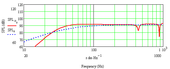

You're right Cal. Calhoun & Shadow were the genesis of all these boxes (I still call it the Calhoun range). When I was fiddling around in MathCad a few months back, I decided to see what other types I could come up with & did five or six. The box now known as Chang started as an idea for the 207 -I had it kicking around on my HDD and when Greg Chang mentioned he had a pair of B20s gathering dust, I plugged their specs into it & found they worked fine. Double & single mouth versions are possible for all of them, assuming the slot-vent length allows it.

Is that graph for the single mouth? What could I expect with a little room gain? Im thinking of building a suzy chang for the B20 and completely removing my subwoofer, If I can reach 30hz with some authority I will be happy. The speakers will be getting around 15-20 watts. The room is relatively small, at around 10 x 15 feet.Scottmoose said:Exactly like that Dave. 🙂

Fast1one said:Is that graph for the single mouth? What could I expect with a little room gain? Im thinking of building a suzy chang for the B20 and completely removing my subwoofer, If I can reach 30hz with some authority I will be happy. The speakers will be getting around 15-20 watts. The room is relatively small, at around 10 x 15 feet.
Your thoughts sir?
Yes.
With room-gain? A flattening of the LF response, so more gain at the bottom end.
Don't chuck the sub, if it's halfway decent -extra LF help never goes amiss. Get another one while you're at it. Stereo bass makes more of a difference than people think. Remember though your room is actually too small to support sub-bass wavelengths.
I doubt the speakers will need 15 - 20w to go loud. About 10 would be more than sufficient to cause deafness in a room of that size, even though I gather the B20 likes some power.
Beyond that, I have no thoughts. Dangerous thing, thinking, and best avoided.

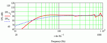

End-correction? It's not really about trying to extend the bass. These boxes are just regular BR or MLTL cabinets, and I design them as such initially, then replace the usual small vent with a larger flared one (or more than one) that gives the same Fb. The rapid decrease of pressure you get from the flare reduces noise and any peaking at Fc, should either exist. As you've coupled to more air you get a larger scale to the presentation & they help act as waveguides to an extent so they sound a bit like BLHs, albeit a heck of a lot smoother most of the time as they operate over a much narrower passband.

Scottmoose said:End-correction? It's not really about trying to extend the bass. These boxes are just regular BR or MLTL cabinets, and I design them as such initially, then replace the usual small vent with a larger flared one (or more than one) that gives the same Fb. The rapid decrease of pressure you get from the flare reduces noise and any peaking at Fc, should either exist. As you've coupled to more air you get a larger scale to the presentation & they help act as waveguides to an extent so they sound a bit like BLHs, albeit a heck of a lot smoother most of the time as they operate over a much narrower passband.
It also seems to make the box more dominating than the driver parameters... Just look at the wide range of drivers that work in Harvey for instance.
