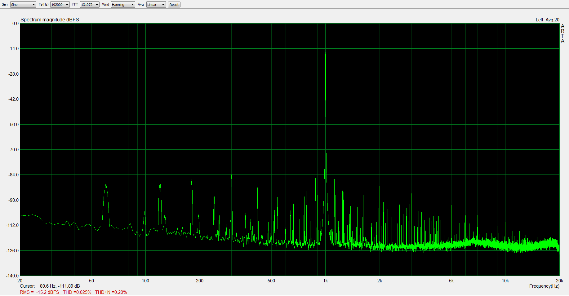

SY said:JB favors a high B+. I reran the spectra at 15VRMS out but with a 400V B+.
How so? The datasheet says 5692's have a 100V heather-cathode rating, and I thought JB's boards used upper and lower triodes in the same tube?
This is slightly stressing them. At rest, the top cathode sits at about 1/2 the B+ (200V). So if the heaters are biased up 100V, there's no violation. Barely. Signal takes that over peak, so it's not a way I'd recommend that it be run. I'll live with a skootch of 2nd HD to run the tubes more conservatively.
In Dave Dove's pentode Aikido driving 300BXLS we are running 430V as B+. The aikido output stage is a 6N6P - so here the heaters are biased up at +120V which is fine. The pentode heaters sit at the same point and are happy so far.
The other reason for a high B+ when using it as a DHT driver is the support for output voltage swing. In the above case that can be +/- 120V. so the hign B+ is used! We have driven it that hard when filling a hall 80ft by 130ft and it stayed very clean sounding all the way through.
Nice to see the exemplory distortion figures and spectrum (such as it is) from the Aikido - it seems to confirm the listening impressions of those who have built it!

I built one with 300V B+ and I can do measurements if ppl are still interested I will post.
Just please suggest your typical power amplifier load and vrms you wish I test it, and types of tests... 1k, inter-modulation etc.
As SY was mentioning earlier in the thread, the most interesting figure is how well a triode performs in the Aikido configuration (ie, Aikido 1st gain stage stack) versus the same triode in grounded cathode configuration. So it would be worthwhile to do any measurement for both cases (ie, just put a high R plate resistor in place of the top tube for the grounded cathode case and a higher B+ to get the same idle current, or better yet, a CCS up top with the same idle current and B+).
Since these are distortion measurements, and so we are looking at tiny faults, I see one issue overlooked so far. The top and bottom tube sections are not exactly identical in practice.

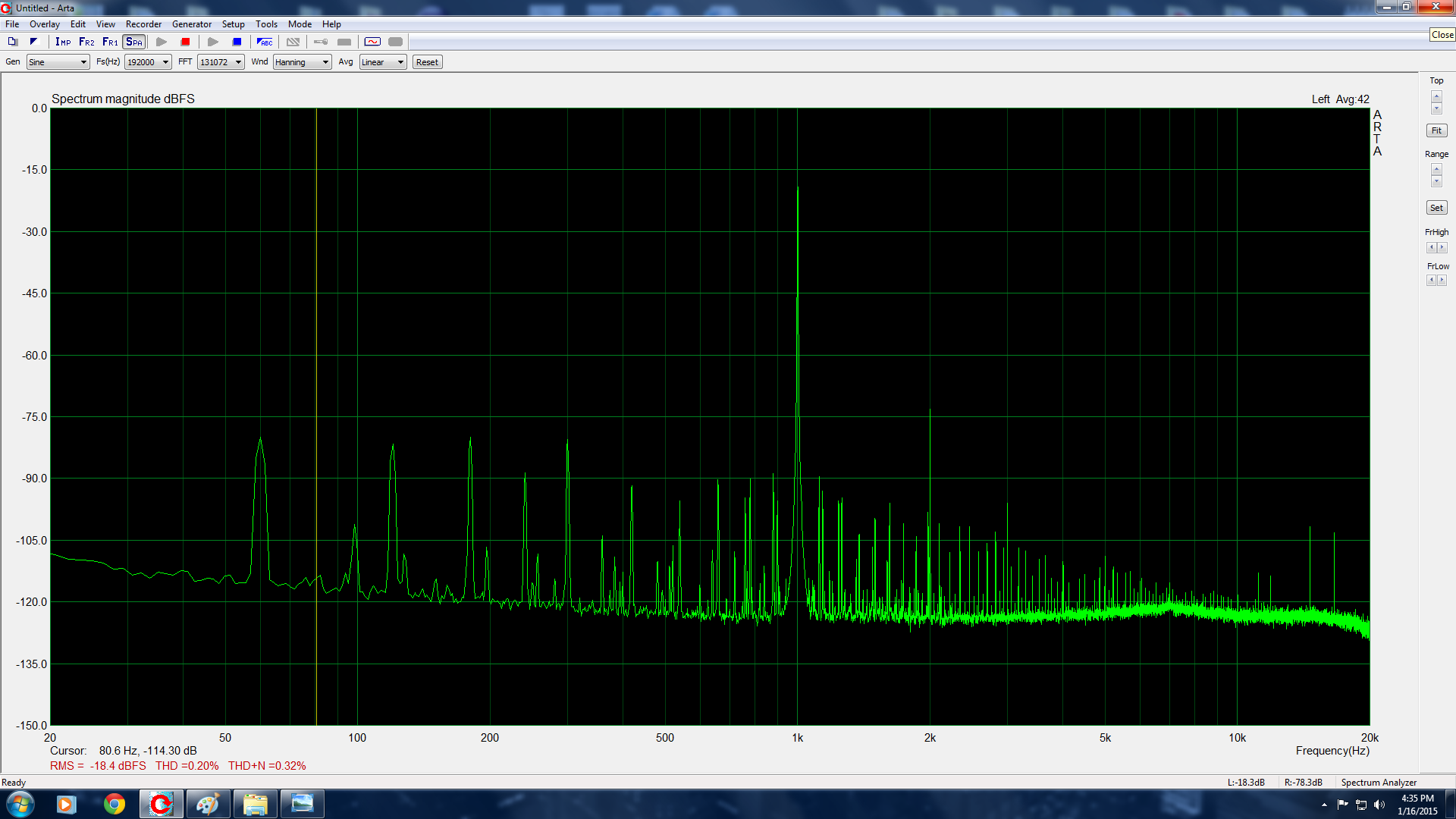

Hi smoking-amp, tonight I got some results of the aikido. I wish I had the boards because I am testing from a completed unit and I don’t want to cut wires at this point! I hope that you understand and that nevertheless the distortion figures will be valuable to you.
Tested aikido pre-amplifier:
Symmetrical SRPP configuration input stage: B+ 300V, valves: 6sn7gtb n.o.s., 200R in cathodes. Bias around 8.5 to 10ma each tube.
Output stage: cathode follower, same V, same valve, same resistors same bias.
Load is 109,85K
Frequency; Harmonics relative to peak signal:
2Vrms output:
20 hertz around 0.11 %
70 Hz 0.06% distortion (THD+ noise 0.05%) increasing linearly up to 17 kHz
17 kHz 2nd: -60db 3rd: -95db
40 KHz 2nd: -66db
The intermodulation analysis of 2 close frequencies at 1Vrms reveals the highest distortion peak at most -60db; otherwise the levels of the first peak are kept at -65db. Nothing unusual and very clean signal.
For 2 kHz the IMD is as follow with 9.7Vrms output signal:
2nd: -54db
3rd: -69db
4th: -74db
Ear test: warm color, less detail because of the added warmth and more blending, which is coherent considering the 0.1 to 0.05 % of 2nd harmonics introduced into the music, especially at lower registers of 250hertz and below.
Note from distortion tests: there are some noise spikes in the audio band at the input volume control which is alp blue, some noise which I will try to fix, nothing major at -100 db from 0 db reference or -90db if volume is turned to maximum.

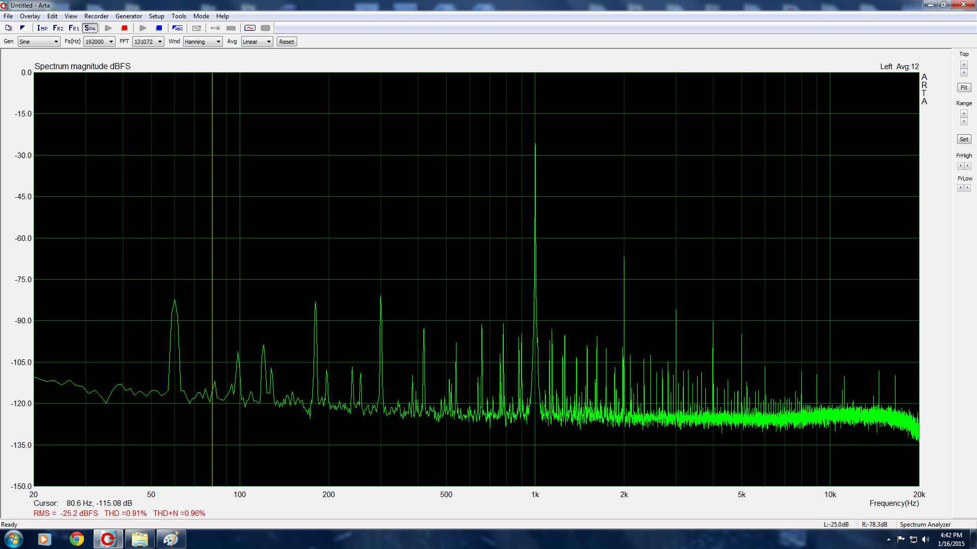

Rotating new n.o.s. unmatched section tubes lead to the change of parameter of 2nd harmonics (the only one measureable vs noise floor) at 1khz/ close to 2vrms, and throughout the spectrum from:
-65db
-68.4
-64.5
-64.3
(Black glass tubes: united electron low distortion tube perfectly matched sections: -64.6db, Motorola black glass perfectly matched section -64.2db)
Two new tung-sol tubes I inserted gave a -57db 2nd (0.131%) (and -86db 3rd but is below noise level)
0.038% distortion in the best matching out of 8 tubes. Interestingly, this attenuation supplement with the best match tube was not as pronounced down from 1 kHz (-66.5db) to 250Hz (-66db). As expected the high quality valve should be placed first, then the cathode follower can be any valve it has no measured impact on THD.
Test at lower B+: Also the test suggests that with voltages of B+ as low as 120V one can get to low 0.1 % distortion with no apparent increase of harmonics except a third harmonic raising slowly as voltage decrease.
