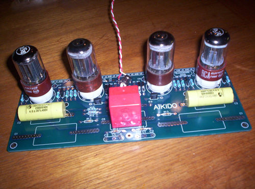

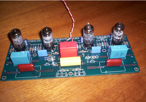

JB was kind enough to send me an octal board with premium components (Teflon caps, bulk foil resistors...). Set it up with 5692s, 10mA, 275V B+. At 100Hz, 1kHz, 10kHz, I got identical distortion readings at 2.5VRMS out. -68dB 2nd HD, no other harmonics detectable.
At 15VRMS out, 1 kHz, -53dB 2nd HD, 3rd nudging the low -90s. Nothing else detectable. Very impressive, much better performance than the ECC88 family.
I'll try to get some pix of JB's boards up; they are massively impressive.

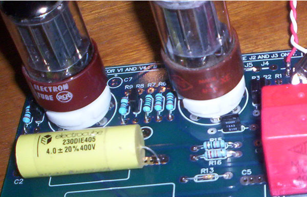

Very nice! I could spot some metal films and what looked like thick film resistors, and some other kind that were too small to make out. Would you be so kind as to tell what key component choices JB himself has made
Sure. Vishay bulk foils for the cathode resistors. The rest are mostly (I think) Yageo metal films. He uses Wima MKP caps for most positions, but does two output CR coupling networks. In one, I have a cheezy Electrocube. In the other, I will mount John's favorite, some super-heavy Russian Teflon caps. For a volume control, he's designed a nifty stepped attenuator, which I don't have a picture of yet. The boards go together quickly; I think it took me about a half hour to stuff one and check it out.
JB favors a high B+. I reran the spectra at 15VRMS out but with a 400V B+. That dropped 2nd HD down to -57dB, 3rd and higher well below residual. So there's something to be said for that, but I'm not sure the extra dissipation is worth it considering how low the distortion already is at lower voltages.
All measurements were cross-checked between a sound card/spectrum analyzer and an HP 3581A wave analyzer.
