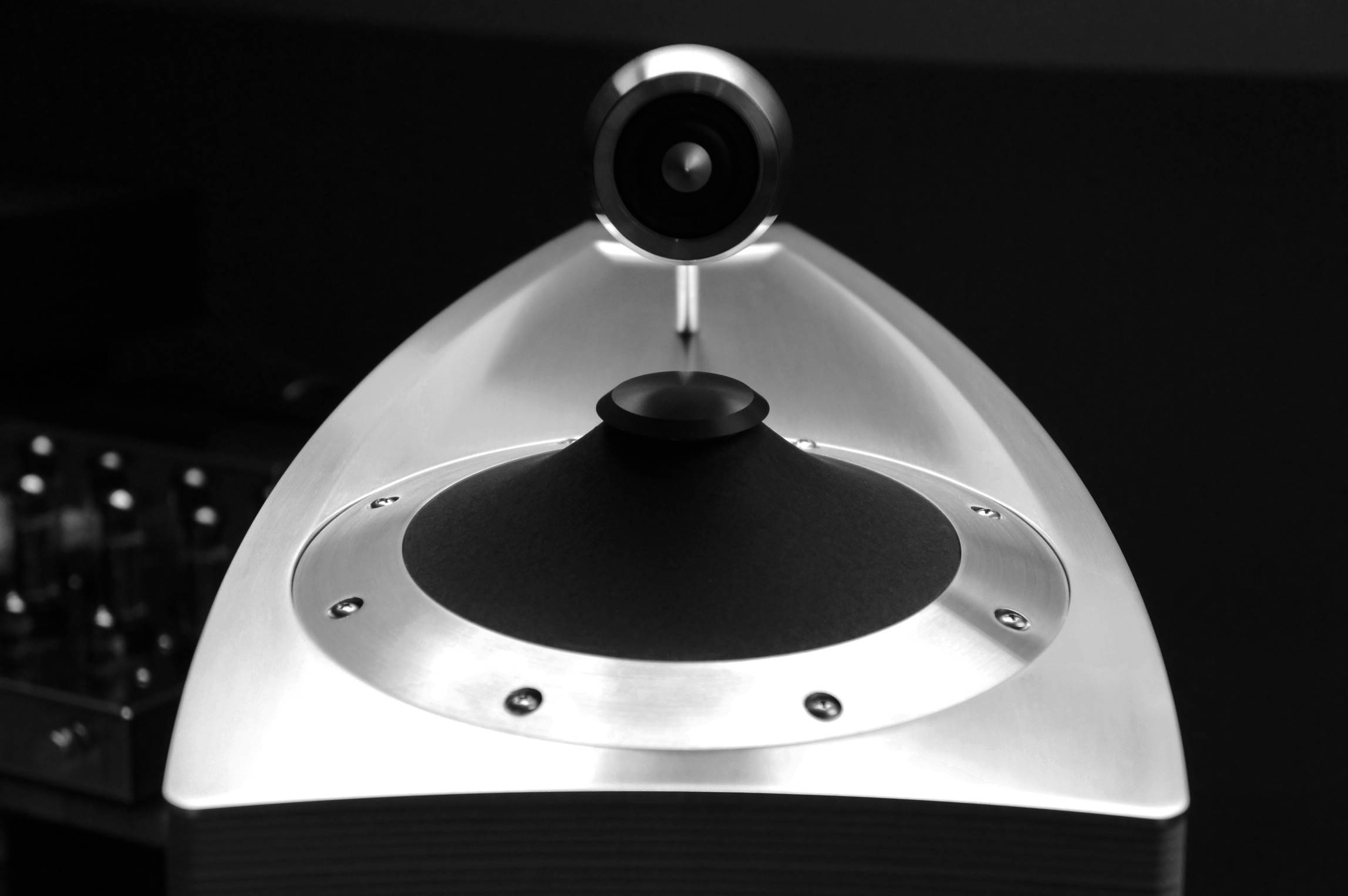

No it sound like crap that's why I spend 2 more years on it and 35000 euros poorer 😀

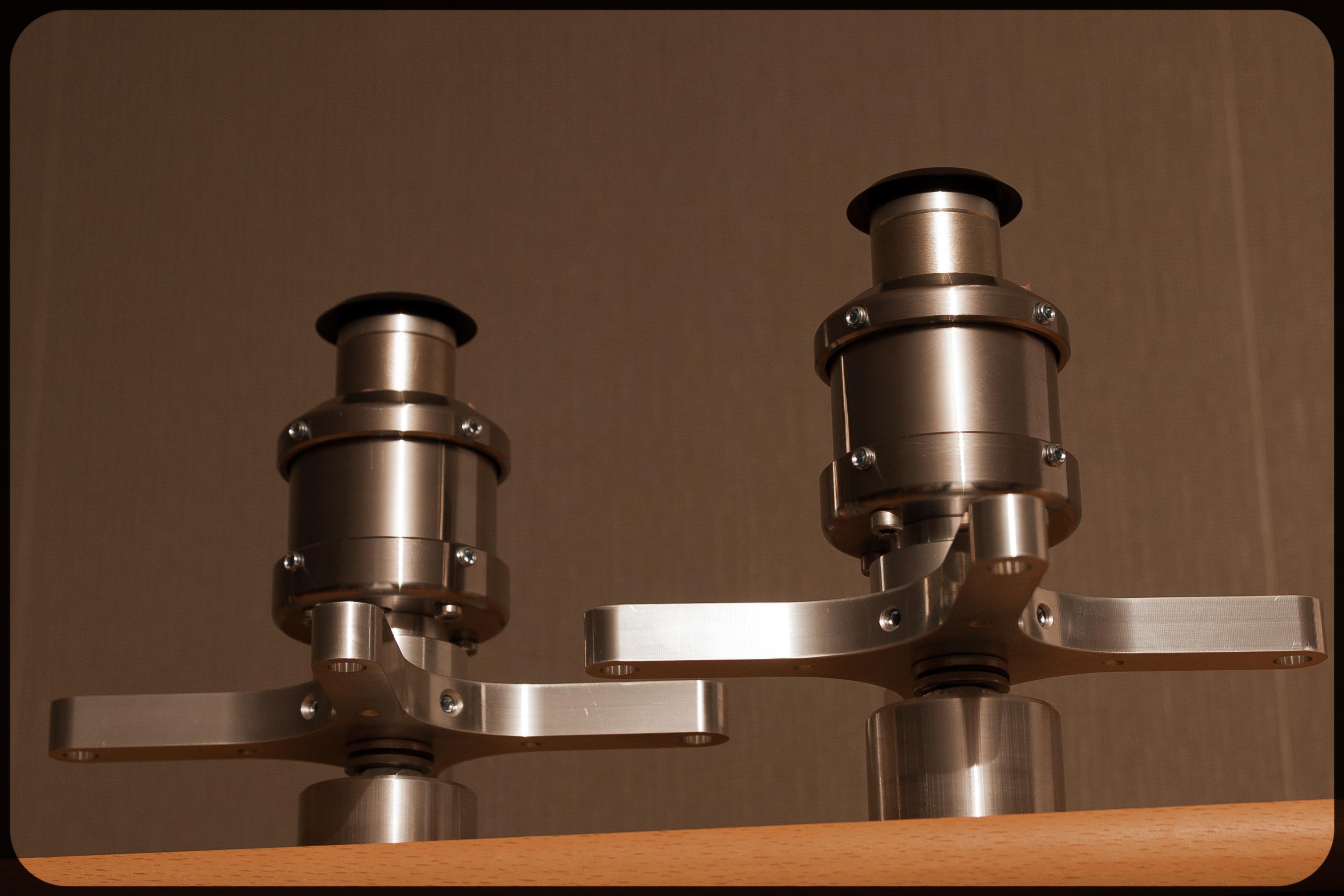

The reason is that I met a guy who beleived so much in this project (audiophile) that he helped me out with the financial part so that I didn't stop the project. He was so sure of the sound he was hearing that he must have this speaker in his house one day regardless of the price. I'm glad I found this guy 2 years ago and now the picture you see is his speaker. The man is very happy too ;-) This moment i'm working on the next 4 speakers.

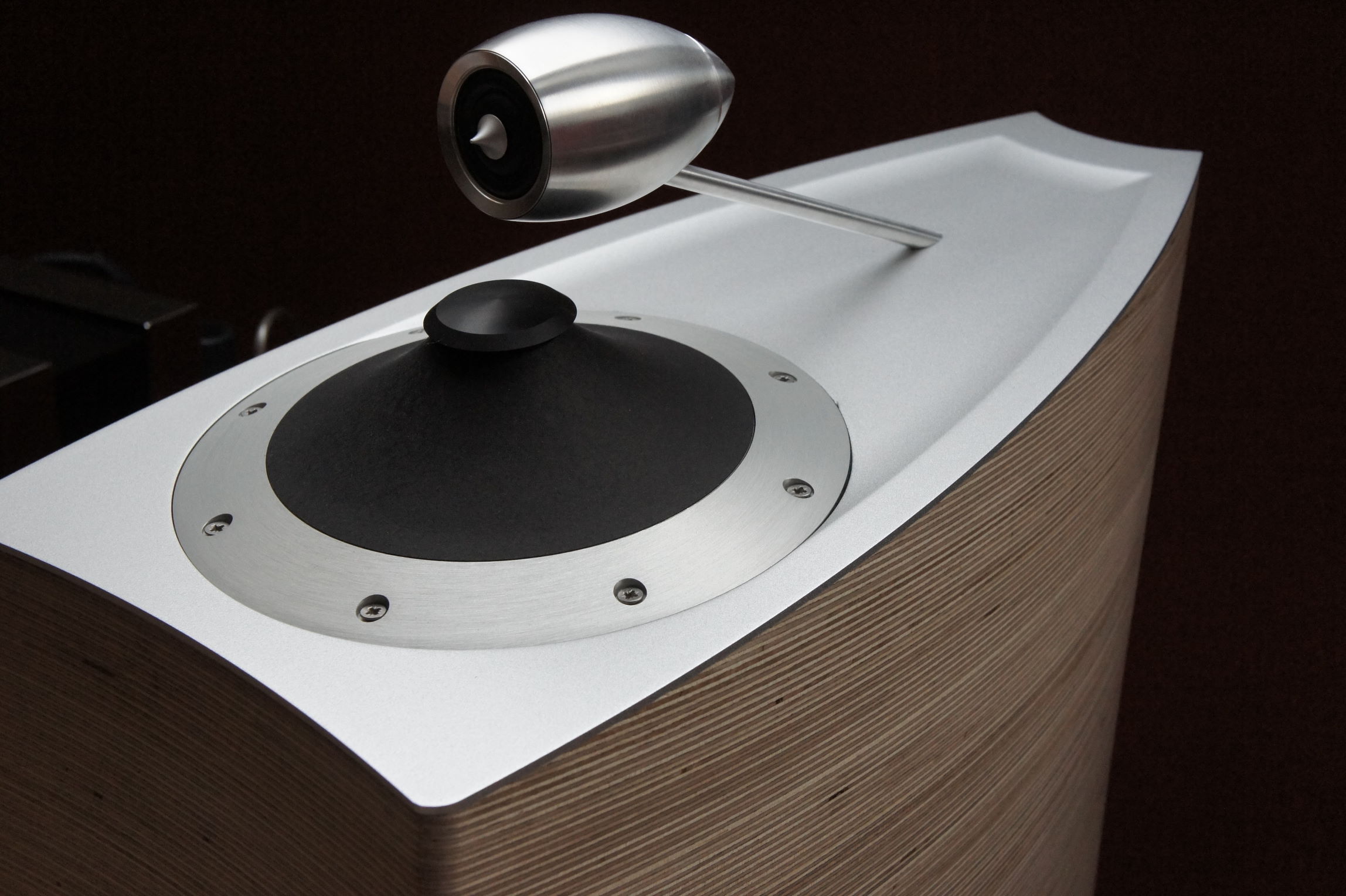

any measurements to share, i am curious as to what it sounds like given it's apperance.
the horizontal driver makes me think of of a short, fat Walsh style driver...

Oké and we are..... but that is irrelevant I guess you know what I mean.
German physics was like a inspiration but sadly never got the chance to hear them. Also MBL and there are similarities in sound with those speakers.

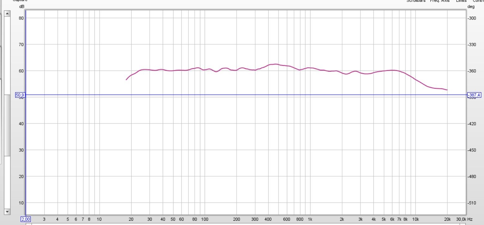

The problem with measurements is that you can't say how it sounds by only looking at a graph made of a simple sinus. That I have learned the hard way.
The final tuning is made in a few different rooms (like most common rooms)at listening position. The graph you see is measured in a typical dining room (10m x 4,5m x 2.4m) with no treatment. I have optimised and extended the low freq. output with 2 different tuned vents. Also this is measured in stereo like you can see in the higher frequenties. Fallback from 7khz due to phase shift (left/right speaker distance to mic) but this measurement is only intended for low freq. optimalisation. The mid-higher freq. are measured mono close distance with other results. Crossover: 3 components.
I let you see the low freq. extension because this is one of the strengths of the driver.
![FR responser low freq optimalisation [15859].JPG FR responser low freq optimalisation [15859].JPG](https://www.diyaudio.com/community/data/attachments/536/536389-3e9893de719b797b8c809f494ff08972.jpg?hash=PpiT3nGbeX)
any measurement at greater than 60 db?
i understand that perception and measurements are not the same.

While I'm not personally a fan of the material wastage inherent in the stacked lamination method employed in the photo, these are if nothing else quite a gorgeous piece of sculpture - clearly a lot of detail work in the machining of the wood and metal components of the enclosure.

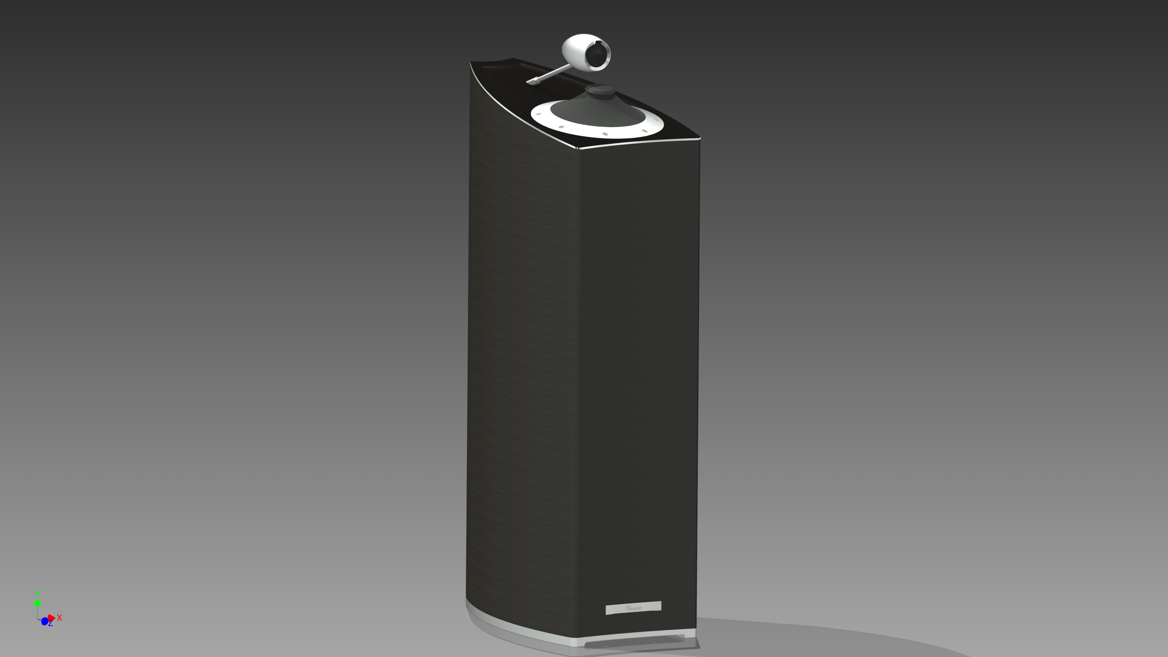

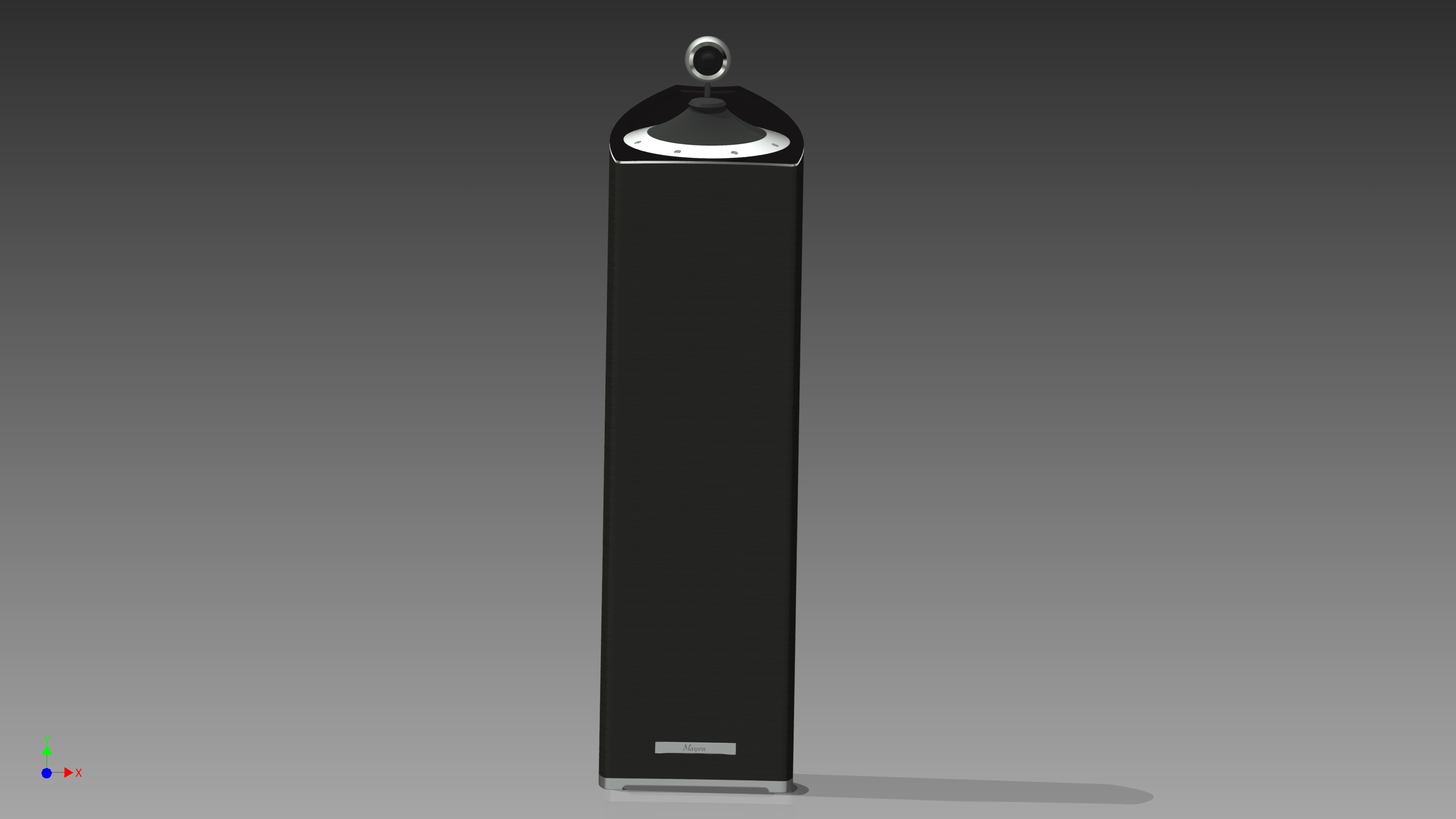

Any photos of the complete system?
Sorry, for the moment I don't have these, I will ask to make some since they are not at my place anymore. I will post the photo's when I get them.

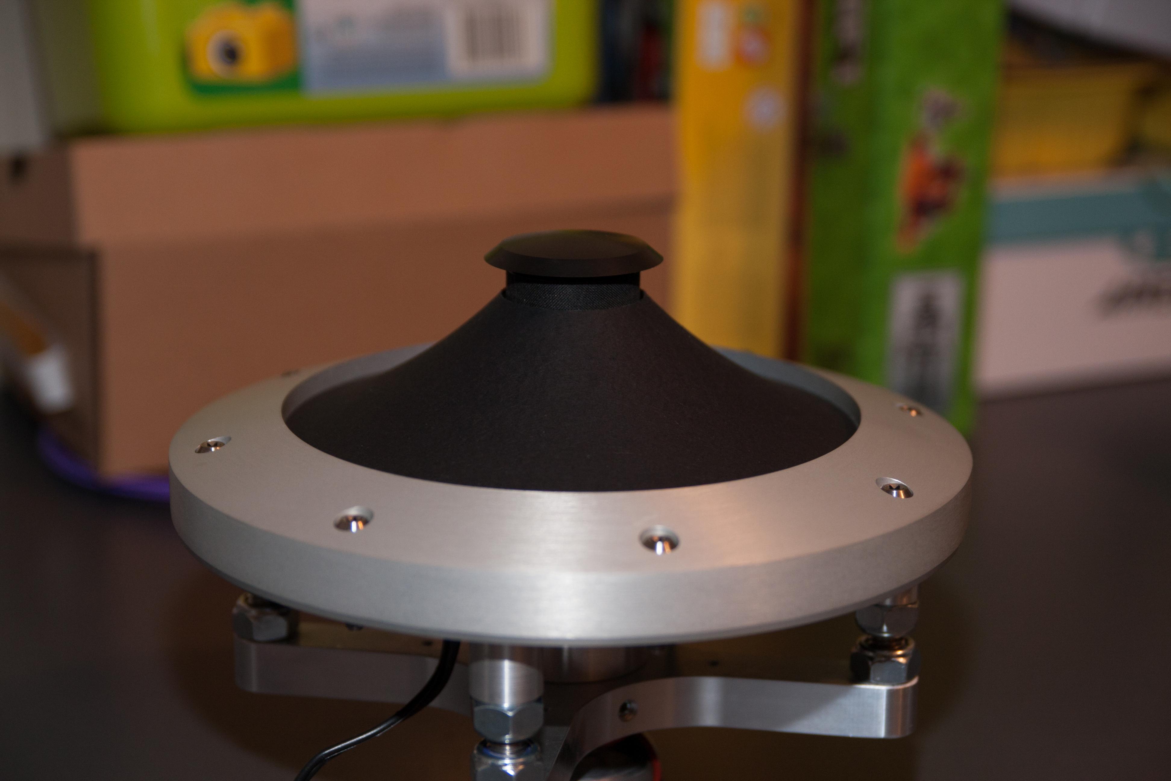

Motor of the driver:
Some schematics :
Seen this type.of.thing before....
There is already an existing patent for a surround less spider less transducer.
It uses DC current to suspend and position the coil by means of DC bias.
There are twin voice coils and a push pull tapped trafo to translate the AC signal.into motion in a similar fashion to ESL.
It's really fascinating but I don't think it's patentable in its own right.
Nice project though, assuming you don't mind sinking a fortune into something for personal use.

The patent is already in application so we have to wait whether it is approved or not. The office we work with says it will but time will tell.
For me it is not that important. This design is to complicated to make it profitable for mass production I guess. I know the existing patent but this uses a different approach and is not a problem.
If it is possible to get our money back it would be great, can we sell more all the better...
But what strikes is that the people who come and listen to the system are 100% convinced (we don't have to do anything). But over the internet is way to hard to persuade people (and this is nothing more than normal) the only thing I try to know are the looks of the system because this you can see and judge overseas.

Yes of course there are alot of them when did I say this was new?
I have tested first with a regular cone in a normal front firing setup. But I like (and this is personal) more the sound of semi-radial setups.
The only "new" thing is the combination of all those things that make to what it is and the patent is only made for the 99% lineair and adjustable suspension without interpolating signals into the "clean" audiosignal. The rest is pre-existing.... nothing more nothin less.

- Surround less, spider less, mid bass driver
