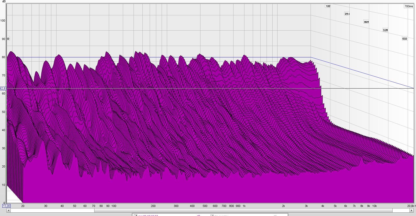

Thanks for the info this is the kind I need.
I have a waterfall of an older version this give an idea. (not high quality measurement) and the freq. response is not optimal but you can see the changes in time.
BL is droped from 9 to 7NA Mms is 18gr with the latest version. I have ordered some prof. paper cones so I want bring back Mms around 14-16gr.

Looks interesting
Hi Jef,
Your graph looks very interesting, despite the scale issues, its very even and smooth from low to high....That's unique and shows you have something good going on!
Your target of 14g Mms with a Bl of 7 sounds perfect...If your driver is around 8 inch diameter, Sd should be around 220 cm2 or maybe a bit more?
You will have better low end performance than my 4.5 inch ( Sd of 70) silk surround BMR, it has a Mms of 6.03g and a Bl of 4.82 giving a very fast ratio of 1.25 :1. If you can get the top end to extend out to around 15 KHz you will have a great driver on your hands.
Please explain the time scale on your graph, I see 700 ms at the end, but the important settling time is all in the first 1 or 2 ms seconds ...
I can email you a waterfall plot ( the file is too big too big to post here) of my silk surround BMR which is totally clean after 1 milli second...
All the best

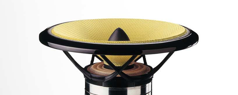

Jef can you explain the main differences in a nut shell, from this driver and B&W mid yellow cone.
Sorry for taking your previous post out of context and posting a different picture in your thread of Kevlar B&W’s cone, hope you don't mind. 🙁
Oké no problem at all my man!
I try to explain:
The B&W kevlar cone has a very small excursion only usable for mid tones not for bass.
You can see the b&W driver use a small spider (less resonance as a large spider) but also small excursion. If you use a small spider and will use it for large excursions it is not lineair because of the changing angle to the voicecoil.
The B&W also don't use a surround but the cone is direct attached to the basket. My driver is attached to anything for now. I don't know if I keep this, also going to try with a very soft surround because this is easier to build (only if the sound stay's the same).
My driver is build for two way = > less problems with phase shifts between two drivers. This is why I spend alot of time for the best compromise between low and high freq. response. For me a good driver must have sufficient low freq. output (40Hz) with good high freq. capabilities till 4-5Khz.
Also if you use one driver for very low freq. and high the excursion can be large but the sound must be kept clear => in my case of the very lineair excursion till 8mm results in a super clear (read not compressed) sound at high volumes. The cone can travel way more till 15mm but not like a normal driver even in this case it is not compressed. Why? the suspension in this case is less as it should be but not more so it stays clear. If you go further the cone will pops out. tried that 😉 put back in and no problem at all 🙂
in a nutshell:
I think the sound is that good because of the large displacement without distortion and the use of 2-way not three or more the prevent problems with phase shifts between two drivers.

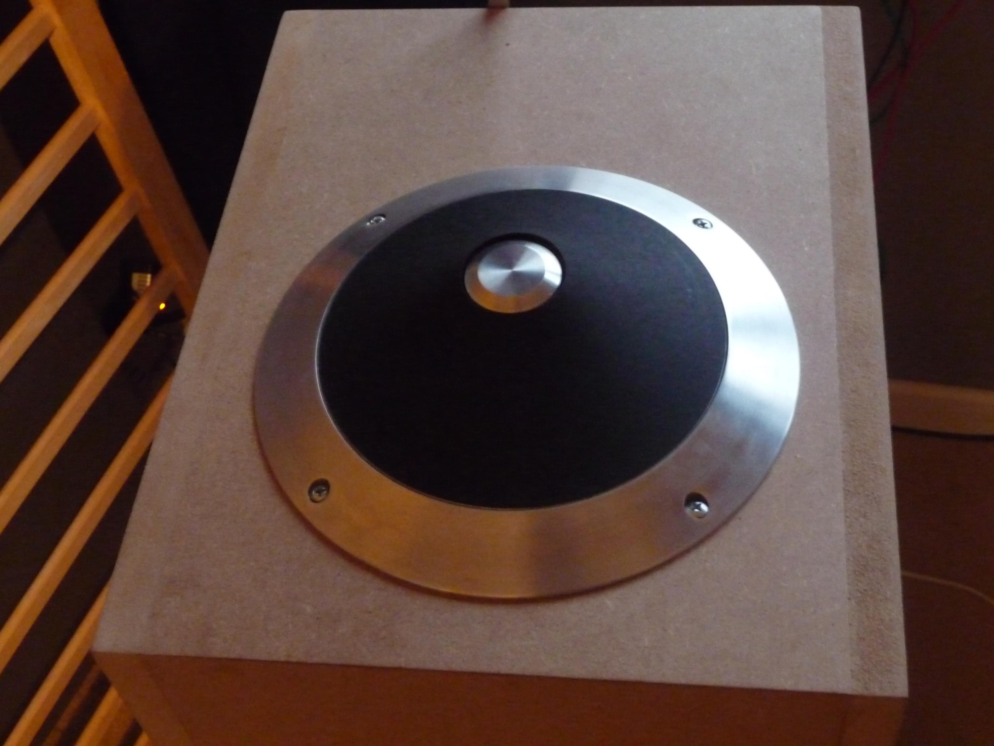

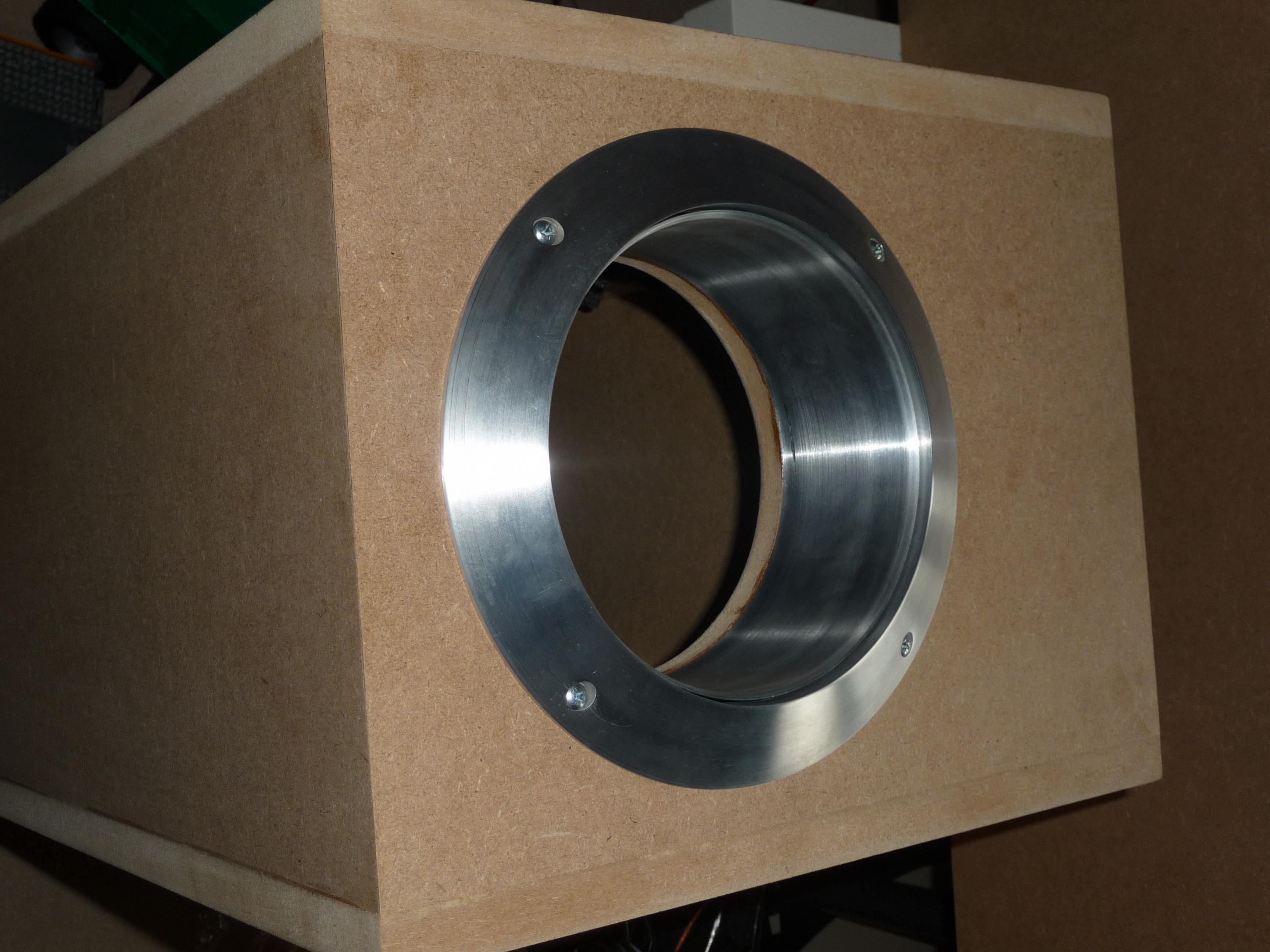

Would your design work at subwoofer frequencies as well? The fact that you can get such large excursions cleanly immediately makes me think of it's use as a subwoofer, especially where you said "If you go further the cone will pops out" - I'm sure lots of folks will be happy that over-excursion doesn't destroy your speaker completly 🙂
yes it would because I can change the design for larger excursions.
I didn't done that but in theory Xmax p-p 16mm would be possible.
there is some increase in weight but for sub. this is not a problem.
when it pops out it is not just as simple as put it back in 😉
The ferrofluid must be take out and put it back in after the cone is placed. (but the driver isn't distroyed)
=> with this prototype there is no stop on the end of the excursion but the final version will have it so popping out is no problem.

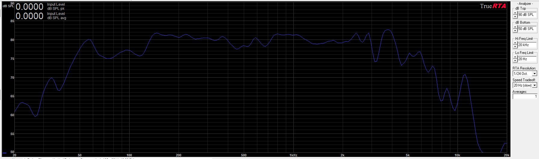

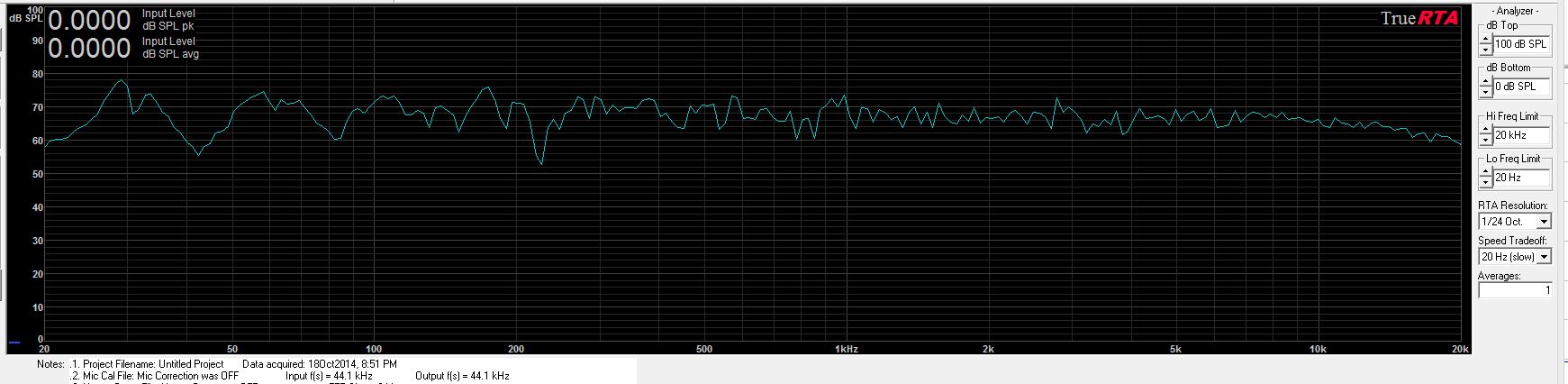

Just made a FR-plot in normal room circumstances. So there are some peaks of the room reflections but I think not bad and pretty flat.
70liter basreflex case tuned at 50Hz
There is only used one filter: -7db 2oct at 3000hz (baffle step compensation).
and a hp-filter for the tweeter. No LP for the midbas. No gain for the low's.
Question, the FR-plot is flat but the sound is not warm yet there is enough bass.
I do think if I change the kevlar cone with paper the problem is solved? Suggestions?

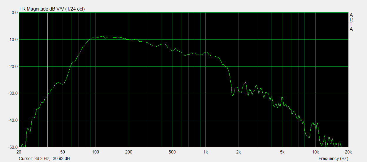

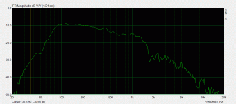

If you want to show your driver, please disconnect the tweeter, post a nearfield measurement ~1cm from the cone, and time-windowed measurements without reflections from 0.5-1.5m or so at a few angles. The graph above doesn't show much of anything, really. Also, a 30-40dB scale would be more appropriate than 100dB.
Oke I did a quick measurement (near field 1.5cm) of the driver. This is not in a IEC baffle or open baffle so I think there are some backwave distortions. Also do I have problems in my room with the 100Hz drop. (all my speakers do have some trouble about this here). The best result i get was in the middle of the room but it is still there.
If I got the time I will do some measurements outside in a open baffle (if this is a good idea?). But I hope you do have some idea from this graph.
Please advise.

For mid-high frequencies, use a program with time-windowed impulse measurements and you won't need to go outside. REW, HolmImpulse, ARTA, etc.
For low frequencies, you should be able to get nearly 100% clean low frequency response from nearfield, but I'm not familiar with trueRTA so in the image above, I'm not sure whether you're seeing something that's really happening with the cabinet+driver, or if something else happened.
Maybe you should try measuring a conventional speaker to make sure you are getting normal measurement results first?
If that's the bass reflex cabinet, it should show a dip at the tuning frequency, which you said was 50Hz, but it looks like above maybe it is actually tuned to 36Hz and the rise below 30 Hz is just noise or the microphone, maybe. Here's a typical bass reflex tuned to 50Hz and measured nearfield 1cm:
