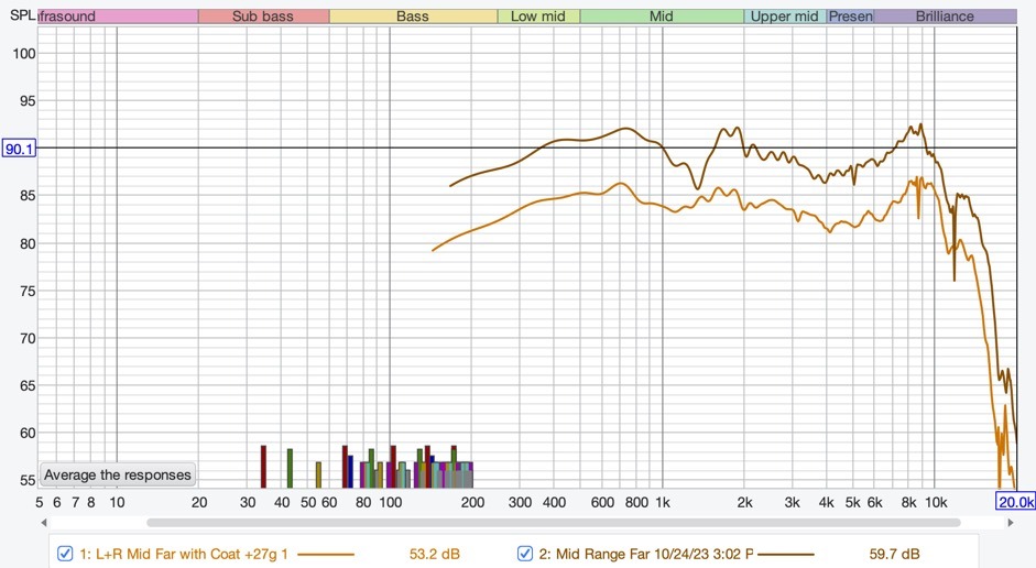

Hi all, any feedback on this result?Well, I am calling this a success...
Orange trace is with edge coating, no smoothing applied to curves.
Impedance sweeps also showed reduction in resonance around 1.3 kHz as well.
I am trying to determine if a second coat may yield additional improvement or stop while I am ahead.
Next, I have some Satori midwoofers, MW16P-8, which also show the ~1.3 kHz edge resonance. These will be used in a 3-way center channel, crossed around 500 Hz. Any benefit by edge coating in this application?

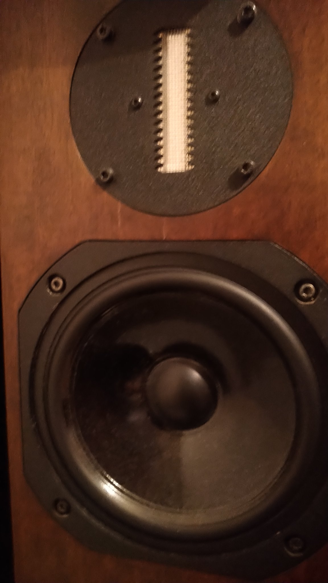

How to apply Mod Podge. Simply put your speaker on something which is rotating e.g. something like an gramophone, instead of vynil put your speaker there. : ) My speaker magnet don't have hole but an small hole in which I put metall ball and simply rotating speaker on ball I have aplied two layers of Mod Pogde using an fine brush, first layer was thin, when dry I done some fine cleaning by P600 sand, than the next layer is a little thicker, and when it dries it comes out like glass flat and aslo when it dries it will become very thin. You can also speed up drying with a hair dryer. Hope this helped. Note this, this is not reversible! Speakers is a bit dirty and I'm lazy to clean it up
My reference TL speakers, Audax HM170G8 , my faworite 6.5" bass/mid and nice tweeter RAAL 64-10
