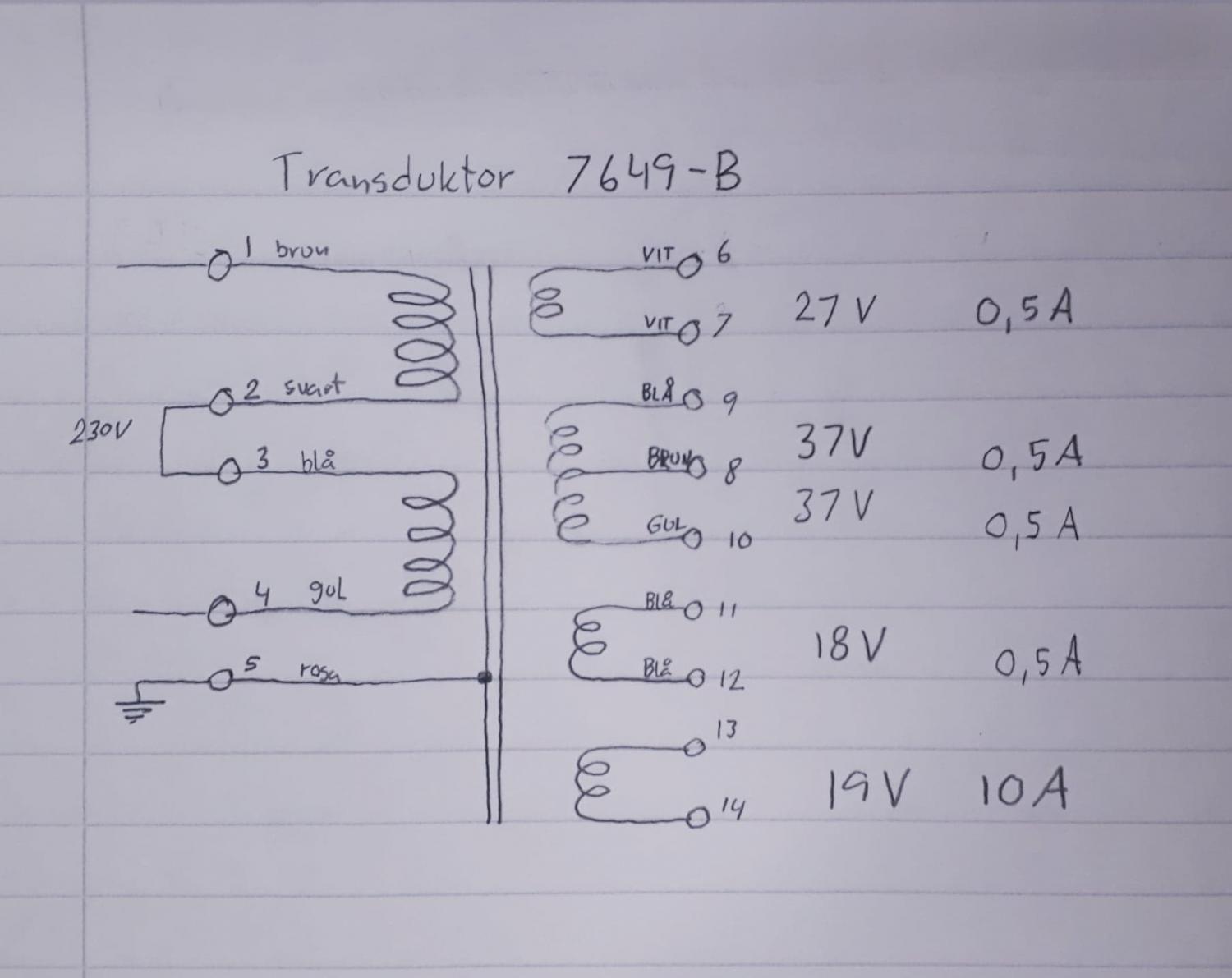

I just "accidentally" ordered two rather phat toroid transformers from a surplus dealers. The more realistic option is to use them in a power supply for my almost-finished class A SS amp but I couldn´t help noticing their potential use as PP OPT´s with CFB windings.
Assuming a symmetrical 115+115V primary we should have a winding ratio of (115+115+37+37)/19 = 16, ignoring the low current 18 and 27V windings.
16^2*8 =2048 Ohms Ra-a, right in the ballpark for a pair of EL509 or maybe a quartet of smaller sweep tubes.

You'll probably have an LF roll off if you don't wire a pair of them interleaved as one as I've demonstrated before, but it should work. Personally, I use 115+115:12:12 in my EL509 style builds which makes 2k2:6R, but I have also used 115+115:18+18 for 1k3:6R.

The primary inductance is probably rather low in these transformers (250VA estimated) but that 37-0-37V winding should be helpful in that matter. (230+37+37)/230= 1,322, so 32% more turns which should result in 1,322^2 = almost 75% more inductance.

Core materials for a power type and other types of transformer (xfmr) are different, so even if turns ratios on a power xfmr are okay for output xfmr use, the core characteristics (how fat is that hysteresis loop?) of a power type xfmr could limit the performance in audio (wideband) settings. Best thing to so is just try the transformer and give it a listen after some preliminary testing to see if it's even in the running.

Yes, the hysteresis loop is wider than for a true AF transformer, which explains the low apparent inductance.
The simplest way to determine the amplitude inductance, which will determine the actual bass capability, is to measure the no-load current with the regular 230V/50Hz input, derive the reactance and finally the inductance.
The high hysteresis will also cause significant distortion for topologies having a high output impedance and low or zero feedback.
With feedback or a CF topology, this shouldn't be too much of a problem.
The arrangement of the windings will also cause problems: HF rolloff due to the leakage inductance (but relatively benign for a toroid) and high/unbalanced parasitic capacitances.
It is worth testing anyway: you could be pleasantly surprised (or not...)

It is an approximately 250 watt transformer.
Some things to note:
- core excitation, being a power supply transformer, will be something like 1.6 - 1.8 T, while a typical quality output transformer would not go over 1 T.
This transformer will have a severe constraint in power being used as EL509 output transformer;
- the transformer is designed for 50/60 Hz; for audio we need good performance down to 20-25 Hz, so an octave lower which normally requires two times more power from the core;
- primary induction will be lowish, forcing the core into saturation quickly.
My suggestion: not suited for EL509, but an option might be 6AS7/6080 PP (also not so critcal for HF loss as this tube is low Rp).

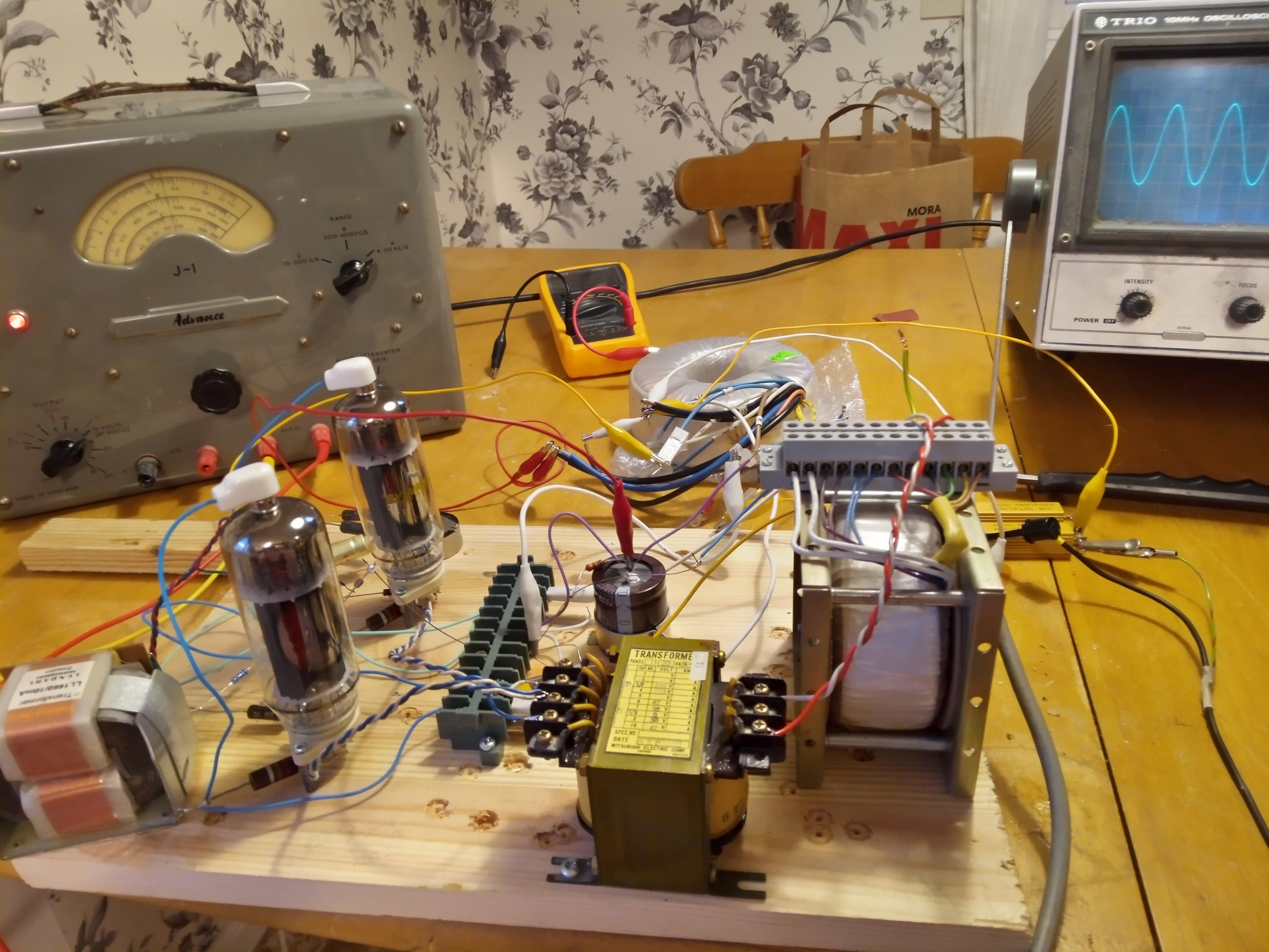

I see now that I should have been more specific in my first post: EL509 was the first tube that popped up in my mind, but I never mentioned that I visualized them running as triodes* and in class A. I don't have much use for 100W+ amps in my horn rig
* Wiring them as triodes might not be the only option. Fixed G2 voltage and cathode feedback actually sums up to Ultralinear operation, for better or worse... This would be similar to the output stage in Quad II. True pentode operation would be a bit more complex as the screen grids would have to "move" along with the cathodes.
It just might fly. I'd measure and then listen if the measurements don't summarily disqualify it.

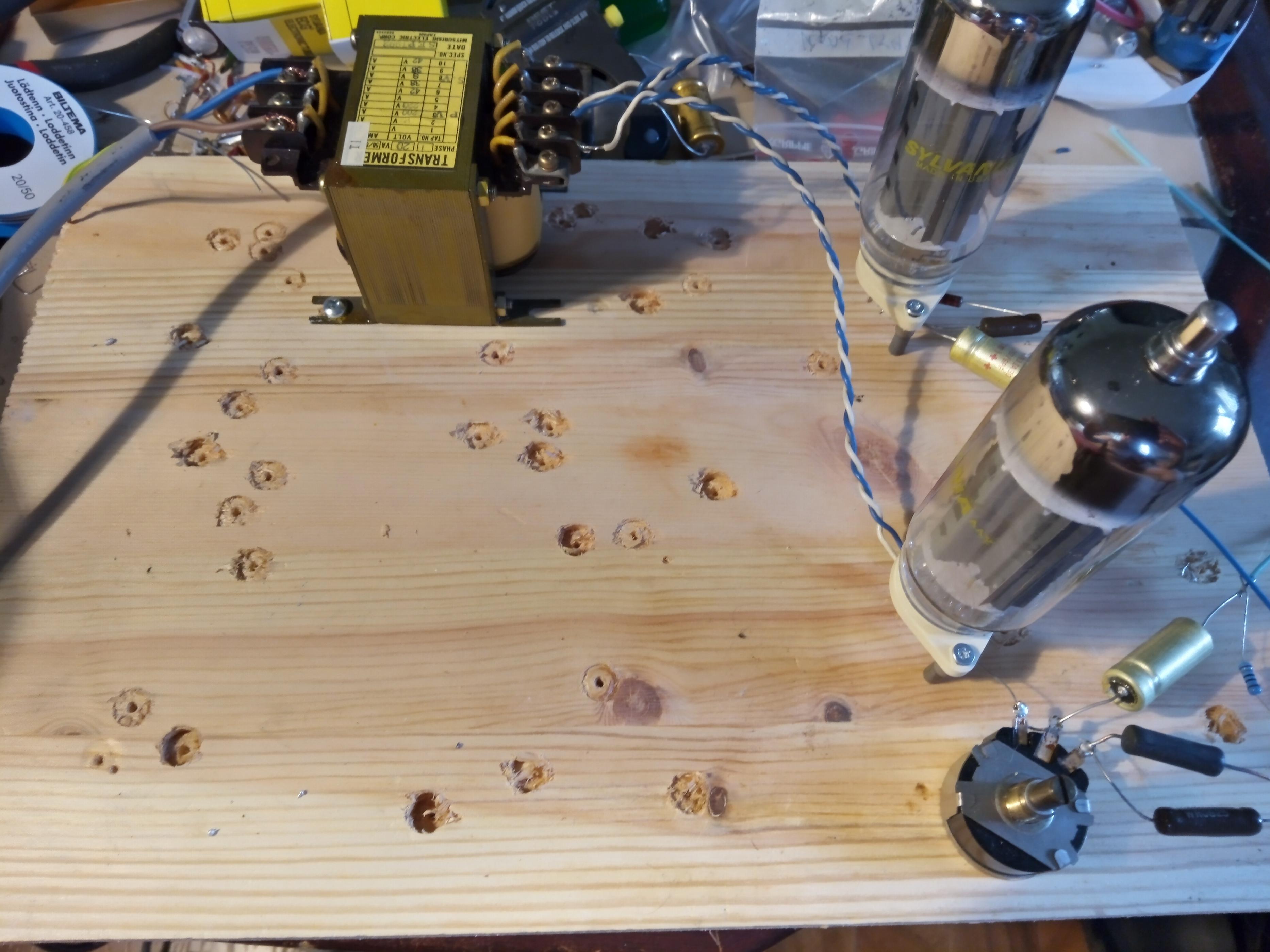

The transformers arrived today and just ran some initial tests with rather interesting results:
Pretty much flat from 20Hz to 30k, with a resonance peak around 40khz.
At 1,5W though, as I run the tubes wired as triodes and at low voltage/current (120V 50mA) for now.
Phase splitting is done with an LL1660 which may or may not introduce some extra flavor to the frequency response.

Update:
Seems like the LL1660 is guilty of much of the HF mischief. An LTP phase splitter would probably be a better choice while evaluating the OPT.
A better power supply must also be built for further testing, I ran out of juice at 255V (minus a 28V drop across the cathode resistors) and 140V for the screen grids which resulted in 20W into 7.5R.
