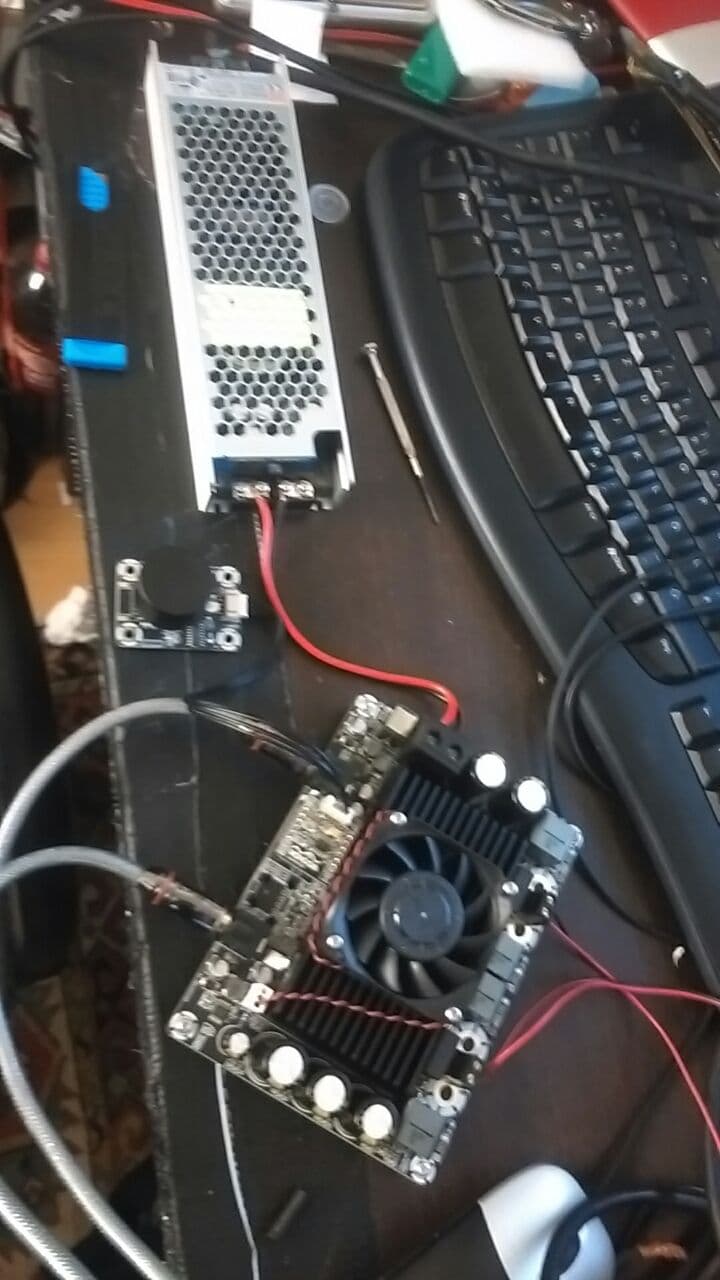

Hi everyone,
i recently bought a AA-AB32314 Board, that is now powered by a MW UHP-350-36 SMPS.
When connected to power or after the connection on J15 to end the stand-by mode i hear a medium loud switch-on pop.
I was wondering if i bougt a defect board, or if this is a normal behavior from this kind of board?
Thank you for reply
Jens

What did sure sales support say? I have two 3x 400w modules coming soon, I’ll let you know if I have the same issue. I hope not

@lawofohms
connected to my B&W LCR6 s2 the switch-on pop has a lower volume. My Testspeakers are little JVC Fullrange from a compact system.
Maybe the Crossover is compensating some of the pop.

Edit: If J15 is connected to a proper switch, the switch-on pop is gone.
