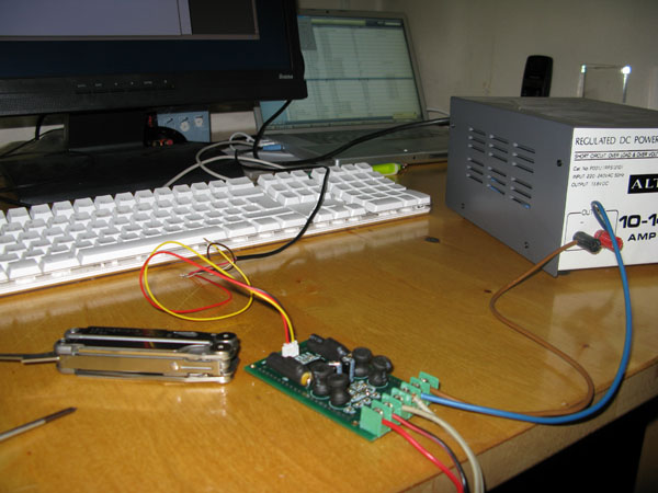

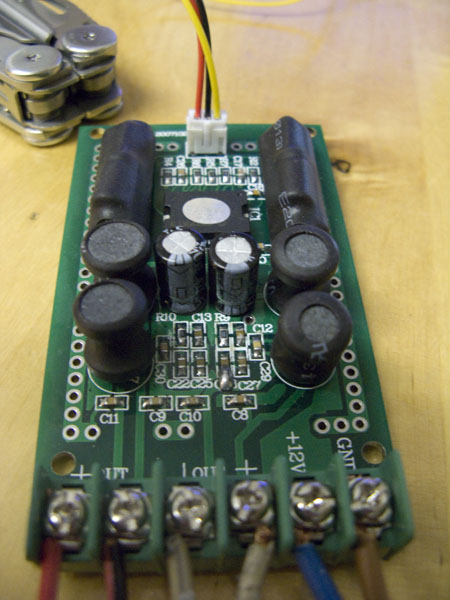

As I am new to this I thought I would start with something ready made and start from there. I received my board from Arjen a couple of days ago and today I hooked it up on a regulated 13.8 volts power supply, my cd player and a set of MB Quarts. I have to start learning faster than planned because everything was silent and stayed silent. I think I have to study some basic electronics this weekend and figure out if I can solve the problem. Waiting for the coment of some friend who wanted to talk me in buying a kit now. 🙂
Aad
Aad
I tried another power supply, speakers and my MacBook as a source but no sound. What is the best start to check the board and its parts?
Any suggestions? For a newby?
Aad. So you've wired the board with connectors for signal in and signal out to the speakers. You have connected the power supply in the correct way and no sound. Can you take any pictures of how you have wired it up?
You did not release any magic smoke by connecting the power supply incorrectly?

I made some photo's not so detailed as it was just for fun at that moment. I have to process them so that thakes a minute. I’ll do that tonight. (and check how to post images) Thanks for help.
Aad
Aad
There is not much to be seen. But that all I made at that time. Stopped making photo's as the project was earlier finished as I expected it to be.
I did not think about it to take more. I don’t know how to post more than one image so I’ll make a second post for the other image.
Thanks, Aad
Thanks, Aad
Hey there Aad,
Connections seem right, so im not sure whats up with this one, ill just come by as long as you can promisse me a olibol and a cup of coffee 🙂 haven't had one of those for 4 years :-O
Greetings,
Arjen
Greetings,
Arjen
