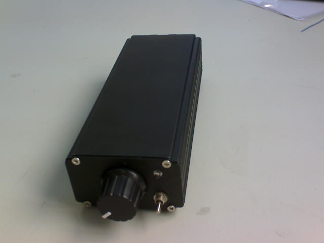

And this is the exterior of the box.

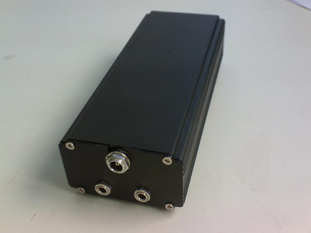

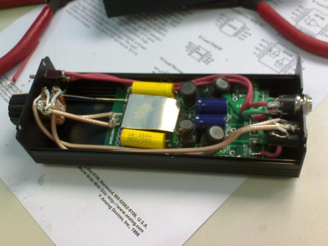

Very Portable HIFI
I had an idea last time when i was at the beach listning to my micro speakers ( Class D 2X2 watt Eutech IC )
I thought, this can be better, but it should still be a small efficient amplifier as it will be battery powered.
So i went to the market and bought a small black housing and tried to fit one of my TA2024 PCB's in there
Ofcource, it didnt fit hehe so i had to remove 1 MM of PCB at both sides to make it fit
Also bought 3 X 3.7 volts 1000mA polymer cells and a protection PCB for charge and distcharge protection.
so 12 volts all together to power the PCB, 2 3.5 mm Connections, one input, one output simple switch on the front side, and a blue LED above the power switch.
The result is a light weight durable and well sounding ampifier
now i need to design and make some speakers, i aready have 2 5 watt speakers that look very nice, with rare earth magnets and a very nice suspention.... ill keep you guy's posted!

Could you tell me the maximum voltage of the fully charged polymer batteries? I've been wanting to try them for a while.
dweekie said:Could you tell me the maximum voltage of the fully charged polymer batteries? I've been wanting to try them for a while.
4.2v I think...

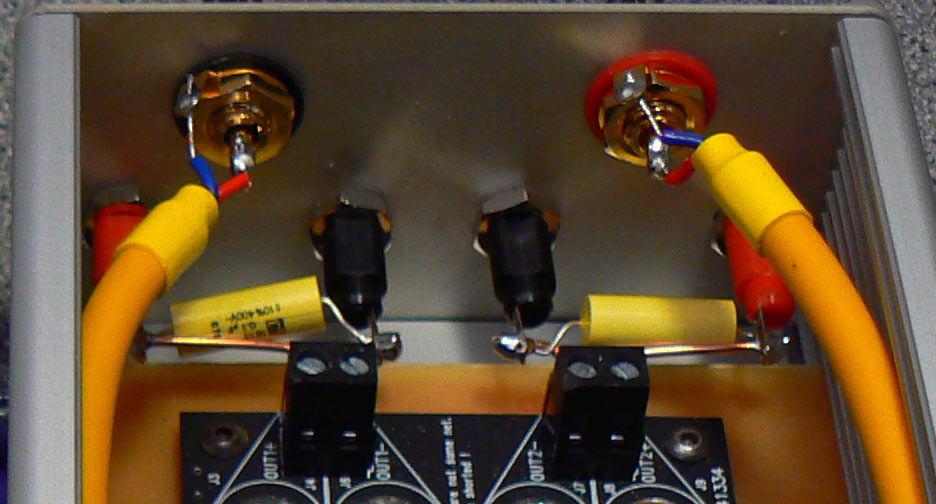

I know this is a newbie question, but I am... 😀
I noticed that you put 3 large yellow capacitors in the speaker connectors and there is a blue cable connected on the right hand side of the box for ground.
Can you please let me know why those capacitors are needed, what values should I pick and where to connect them it's not easy to see this in the picture you provided, I barely see the connections and I'm not sure.
As you are not using a pot, do you need a preamp to use the amp?
Where should I connect the ground cable?
Please don't laugh... Thanks!

OK Got The link you sent & as you are getting no reply here's my interpretation.
I can only see 1 yellow Cap across each speaker terminal. Total of 2 not 3. Most people I think don't fit them & I assume he has fitted them to drain off some of the RF getting through from the chip. I certainly did not add these but may try & locate some suitable quality cap's & give it a whirl.
Sonic Impact use .1 > .15 uF across the output terminals but I don't know what the Sure has further "upstream" in the output filter. If you want to experiment, try something round the above values.
Re Pot/Preamp. You need some way of controlling the Vol, unless like me you live on a farm.
If you feed it from line out you will need a vol pot or Preamp.
If you feed it from a "headphone socket"you will be able to control the Vol from your source device. Ipod, walkman etc.
Re Ground Wire. I cannot see where he has run it to either but it's seemingly terminated on a bolt holding both cases together & his P/S output looks to run directly with + & - leads to the board screw socket.
I grounded mine as follows.
Shielded input's from RCA's at both ends, to case @ RCA end & at pot end to a lug on the board standoff hole. Wiring from Pot sweeper to board uses the new input caps for + and shielded cable for -'s grounded to another lug.
Hope that's some help & if anyone disagrees please feel free to add your input.

Thank you very much for your reply Paul.
There is something like a third capacitor, although it's not easy to see it.
It might be something like a Zobel network but the resistors are missing.
I resized the picture and highlighted it with an oval shape. As for grounding, the blue cable is within the rectangle.

Hello Pincellon, sorry not to have been here earlier and thanks to Paul for answering..
If the third Cap you are referring to is the red item, then that is just the speaker terminal.
What I did (and is not necessary) was remove C7 and C16 and replace them with 100nF Poly's across the speaker terminals.
The blue wire simple grounds the copper side of the plate the board is mounted on..
Hope this answers the question?
