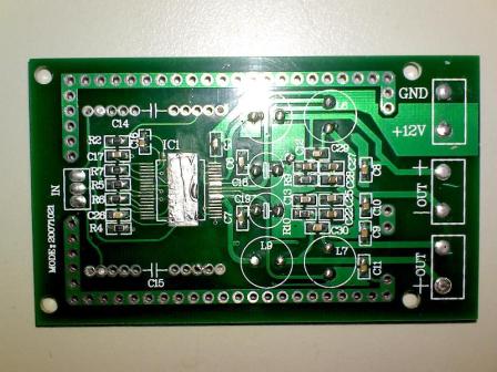

euh, back to the topic, ive made photo's of a used PCB, stripped from the IC, The IC has been remarked, and i could only find out that it is the TA2024 by decapsulating it ( luckely, i work for a IC inspection company! ) aldoh on most units, i can still vaguely see the tripath logo.
the photos i made are of the PCB only, please have a look.
i took off the shrink wrap from the input capacitor, so you can see its a MKP, i measured it, ESR of 0.3 ohms, thats fair the little cap on top is really bad with a ESR of 7 ohms, i suggest replacement,
the two little caps in the middle are the rail caps, ESR is 0.2 ohms,
Good caps but way to small all the other on board SMD components are of normal quality, i could not find any major things there.
Let me know what you think about it

They look pretty good, Arjen...

That looks like a tidy little board, you need to get some costs sorted out for the amount of interest you are getting😀

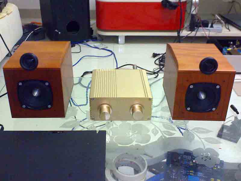

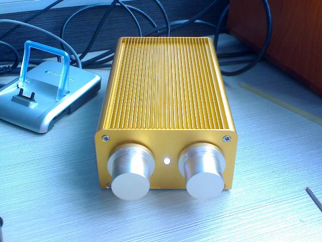

another finished project
This is the one i use for my laptop at my home
also a small switching power supply 2 A 12 volts 110 ~ 220 volts input
The PCB i put online, a alps blue potmeter, ( about 60 RMb here ) i put a big 22000 uF cap over the power input
and selector switch for 3 inputs.
this one my GF calls the " zhou bidze " Pigs Nose....
i must admit, there is some resemblance haha
