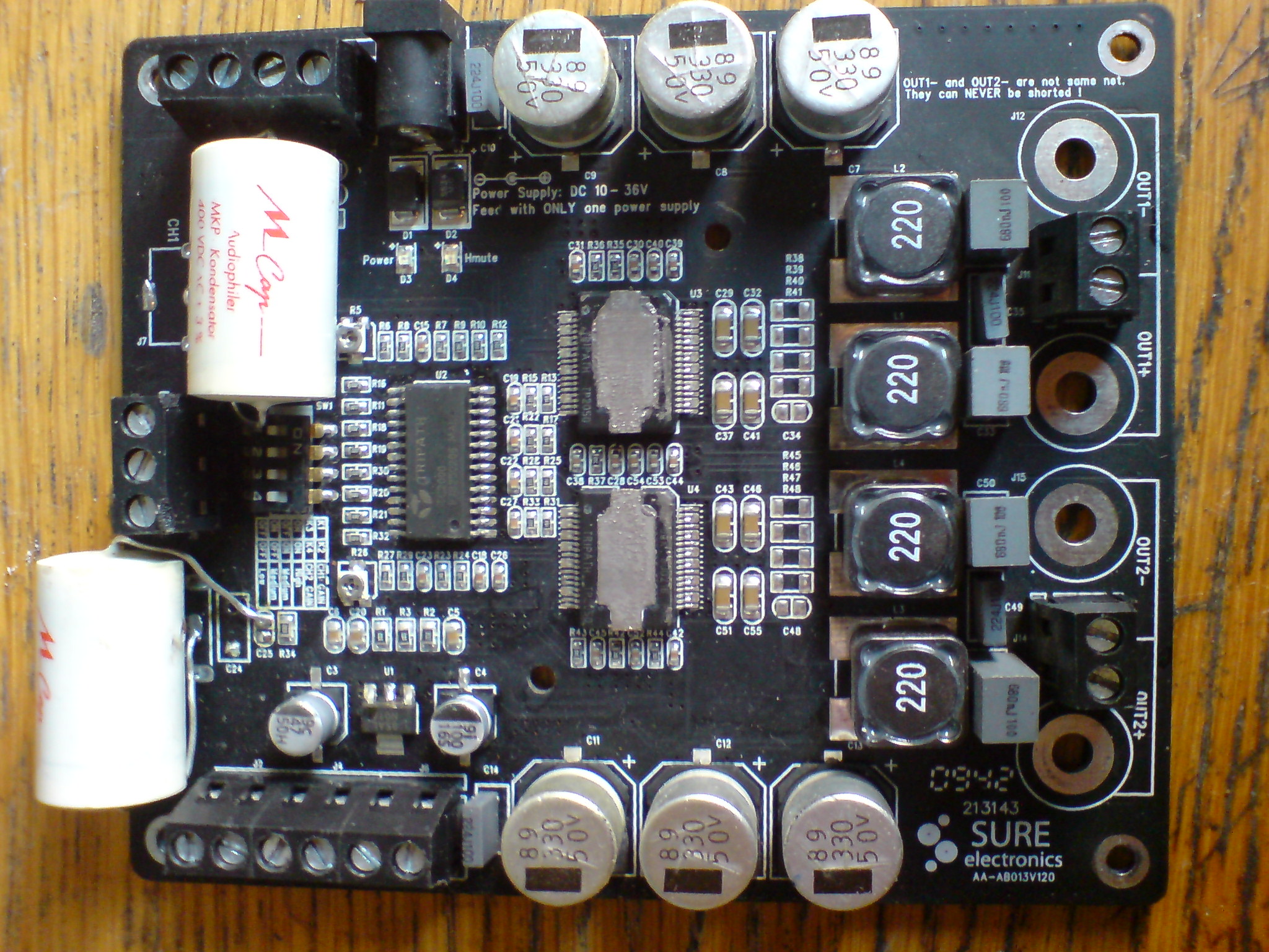

Hi, I've been following this thread since February and it has been my introduction to DIY electronics, so thanks all.

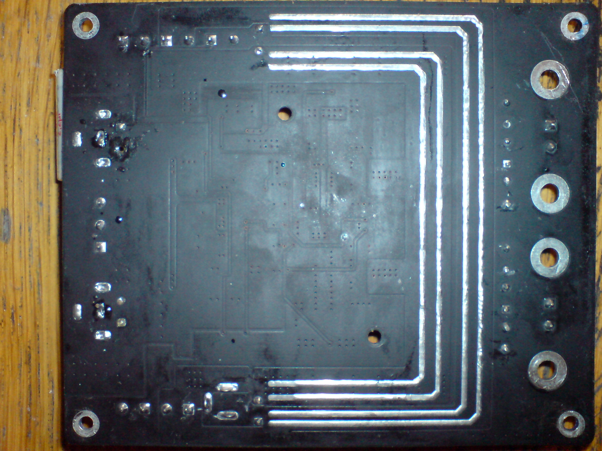

I think however that I have killed the board, when I plug in any power supply the power and hmute LEDs flash on and off continually and the SMPS switches on and off at the same time. I have examined the board for any obvious physical faults and can find none. I have also tried 3 different power supplies all with the same result.
The board has been running fine with the input capacitor mod for some months and I have tried it with 4-5 different power supplies (even running it at 36V for a few weeks) and everything has been fine.
I think that it is possible that I shorted the speaker terminals while I was connecting yet another power supply. I have tested continuity between the positive an negative speaker terminals and channel 1 has continuity.
I would be grateful for any suggestions, I have a multimeter, but only the foggiest idea on how to use it.

Done
The output chip is done. You can try to cut the bad one out with a razor knife to see if the other channel will play if you want to mess around with it or just retire it and get a new board which now comes with 10uH coils.

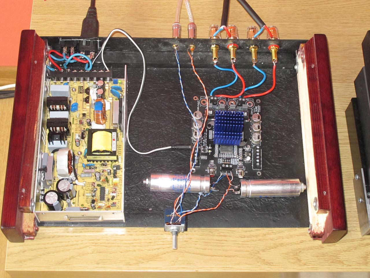

Hi. I just finished basic modifications.
1. Removed input suppressors
2. Replaced input caps (PIO - Bosch MP 2uF)
4. Installed Zalman zm-47j
5. Wuerth XXL coils 4R7
WoW ! The change in sound is insane !!! I'd never expect it !
Clarity, air, bass and soundstage which is now much more layered. I still can't belive what I'm hearing...
Thanks to all of you for your input in this thread.

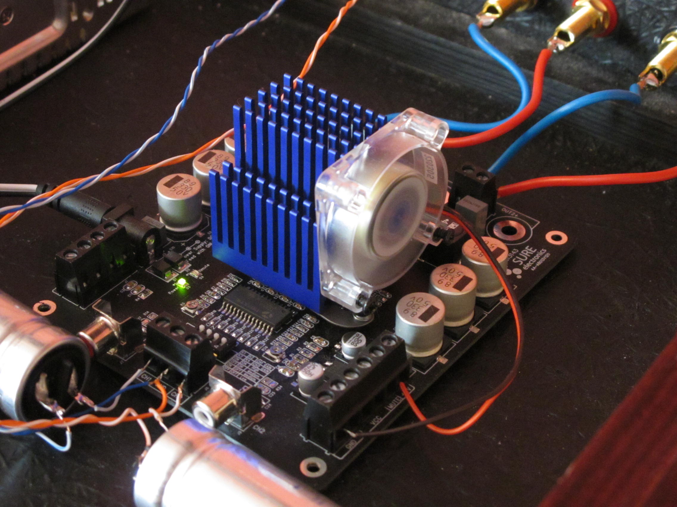

Yes. Heatsink and coils get quite hot. I have tried to connect a big 12V 12cm fan to 5v rail and I didn't hear any pollution going through speakers. The small, fast original fan was VERY loud through my highly effective tweeters.
Original fan
That heat sink should be ok with no fan.
Is the original Sure third version fan ok? I thought they were electrically noisy.I've just tried 3 different 12v fan through 5v rail. 2 of them vere dead quiet and one very loud. The loud one was also the fastest.
I've figured smth like this with original Sure's fan which is OK.
good to know.i may make a fan mount in my chasis which will be very close to the heatsink anyway.im thinking a fan like this the noctua fans are known in the pc world to be very quiet.
I just wanted to give it a try. Connected to 12v it is VERY noisy. The very same fan connected to 5v is almost dead quiet even with my ear right next to the tweeter.
