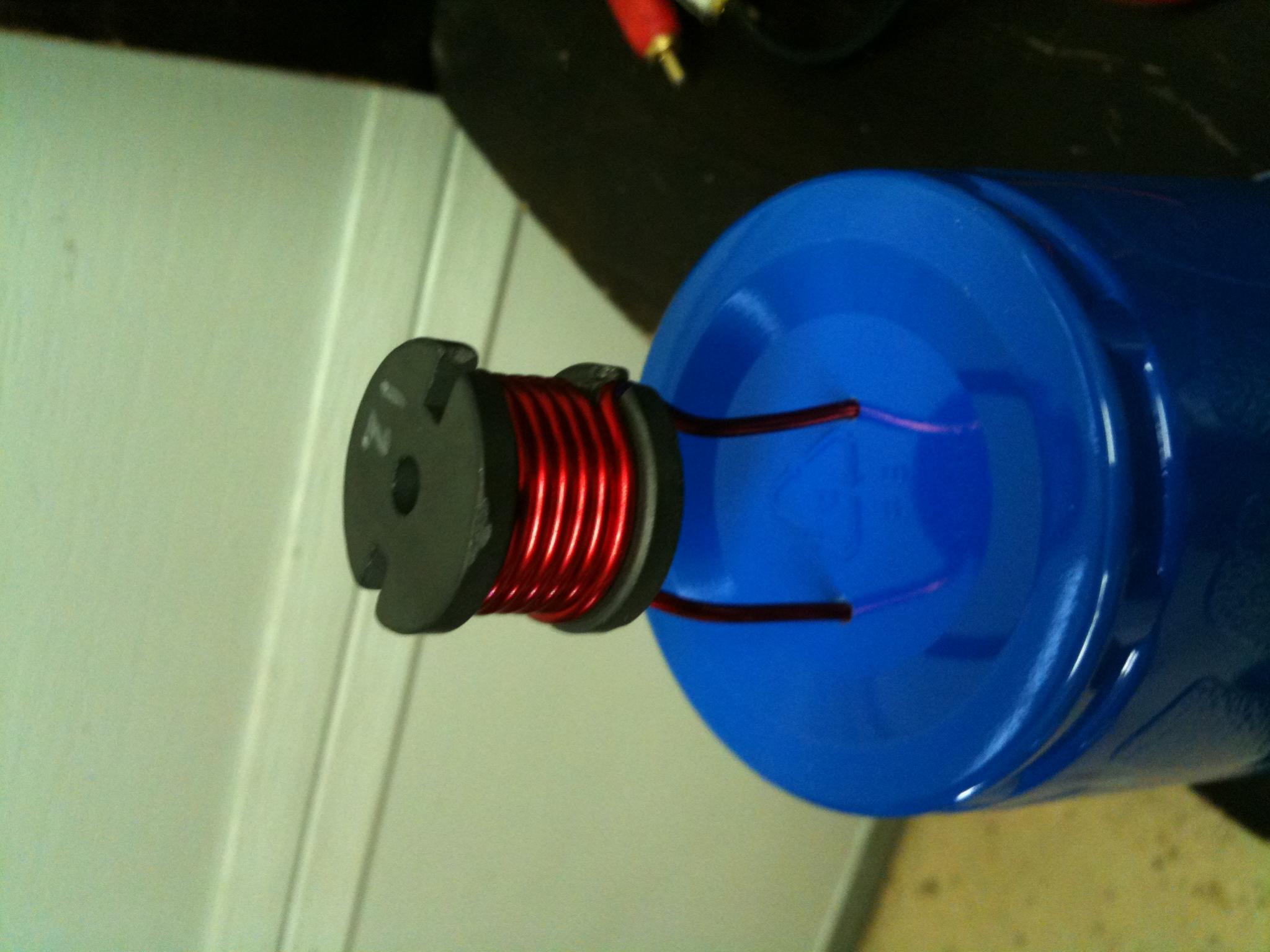

13 gauge inductors
I found some cores at my local surplus store and decided to give it a go winding the inductors with 13 gauge wire I had laying around. I had no clue what values I could get so I used my oscilloscope,a 800Khz sine wave and a decade resistor box to figure out the value. By chance, two complete tight layers around the core yielded a value of 11.5uH +- 2%. A little big though so I had to stagger the height.
I am using 100db full range speakers so I can't really turn up the volume so I guess I am only using less than 10 watts per channel.
Removed the stock input caps and suppressor and put 3.3uF's below the board.
Also found a brand new Meanwell RS-150-24 at allelectronics in LA (local store) for 26 dollars, they sell them on their site. It works quite well. I believe this model has better specs than the S series smps.
It sounds quite good. I have the fan on and with my sensitive speakers you can hear the fan buzz is you put your ear next to the driver, so I can't hear anything from my listening position. I did try it with the fan off, but even at low wattages the heatsink gets hot and the sound starts to degrade.
I have included a couple of pictures.
