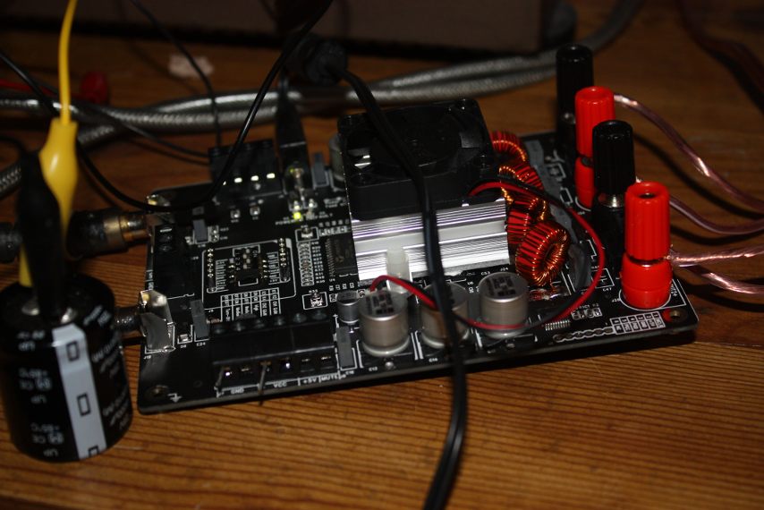

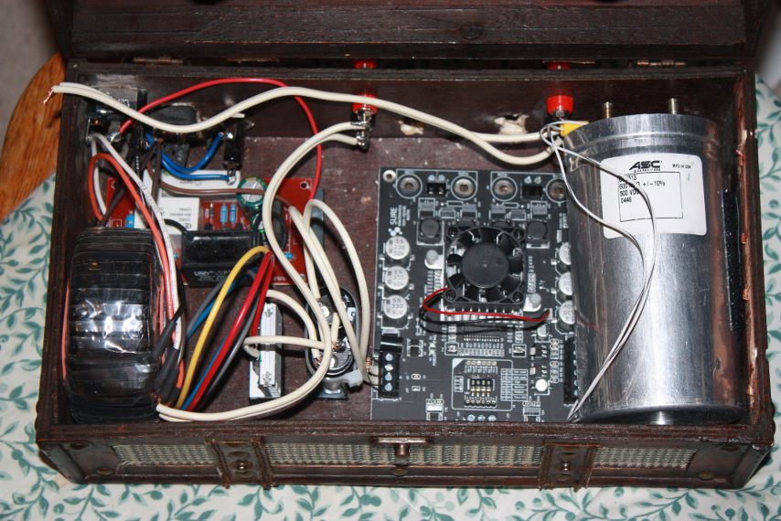

I just got my hands on a pair of the TK2050 100w Sure amps. I couldn't resist after failing to build a 41Hz amp4 and amp6. I firmly believe the Wash DC postal system cooked the Tripath chips. In any case the carcasses yield a lot of useful parts for mods. I got two of the Sure amps in case I ruin one, I'll at least have another to enjoy.
I cobbled together a nice power supply consisting of a soft start circuit, a Hammond 182P12 transformer (24V @ 5A) the bridge rectifier from an amp6, the two 10,000uF caps from the amp4 and a 600uF film capacitor. It works great, but it's voltage is a bit over 36V which is too much in my opinion. So I'm debating how to get the voltage down to a solid 32V. I'm thinking either a resistor for simple and rugged reliability, or an LM350 regulator. Opinions?
My initial test was using a 12v @ 2A regulated wall wart. I was surprised at how efficient the little amp is. Adding a 18,000uF cap definitely helps with an undersized power supply.
Observation: It seems to sound better with higher voltage 32v, but quite acceptable at 12v.
For amp mods:
I started with flicking off the lousy 1.0uF on the input and soldered in a Blackgate PK 3uF to the underside of the board, and left the .22uF in. That brought out the lower frequencies and didn't seem to effect the highs much.
Next I cranked up the heat on the soldering iron and removed the output filters. Not very graceful. Good thing the PCB is decent quality! I put in the 10uH toroids from the amp6 since that would be the easiest to do. They may be undersized for the current requirements? In any case changing these made a significant improvement all around. My big 15 inch Tannoys really came to life. Space is a bit tight, but I think I'll try transplanting the 15uH and other output filter components from the amp4 on the other amp.

Photos of power supply and modified board.
