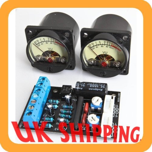

VU Meter
Nosian,
I'm not an expert with VU meters but looks like most of them for audio purposes work like:
"The rectifier is a type developed for performance under wide variations of frequency. Internal impedance of the insrument is 3900 Ohms. A 3600 Ohm external resistor is required to give total resistence of 7500 Ohms. Required voltage to drive meter to 0 VU is 1.228V RMS, which is +4dBm, referenced to 600 Ohm impedance"
I believe you can run the meter off an RCA line, however; I'm not sure how this will degrade the original audio signal. This might also be meter specific as I don't think there is a standard circuit for interface/driving the meter. If it was me I might tap off the audio signal with a decent op amp/RCA line driver circuit (power isolated from the audio power supply to be super safe) before going to the VU meter just to be safe.
Please upload a picture if you get these working!!!

Nosian,
Some of the older amps I built used a diode bridge and a resistor to limit and a trimmer to adjust the meter swing and it came from the output jacks,It was a full wave bridge with the AC connected to the output speaker terminals you could do that much and read the dc and go from there.
Separate power supplies are the way to go, unless your going to use 600 watts you might not need that much,I use the meanwells with mine and it gets loud enough I am using the 4x100 and those run my 2 midrange and 2 hi end in a 6 way system.
Good luck!! You might find some amps that use those meters and look and see how they did it !
