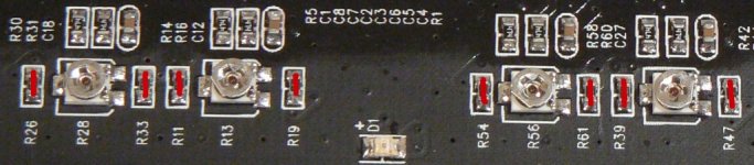

Audio1st we have a DC-offset of 0mv on all channels!!! thank you so much for your advice on those resistors! once they were shorted the trim pot became a lot more sensitive and i was then able to dial out the offset.
I have yet to actually remove the resistors as i have currently painted them with Electrically conductive paint which has worked great, i am not so sure how this will effect the long term if i was just to leave it this way, rather than removing and bridging with solder.
Once again thank you very much!!! i can now continue with fitting the board into an enclosure.

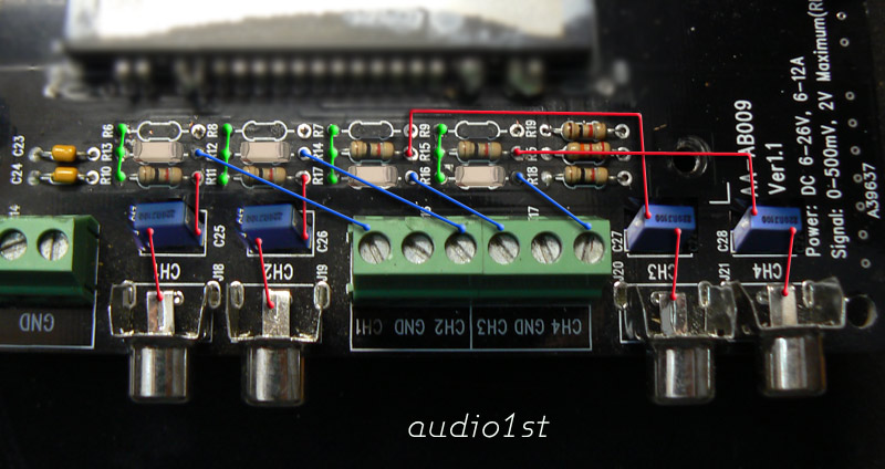

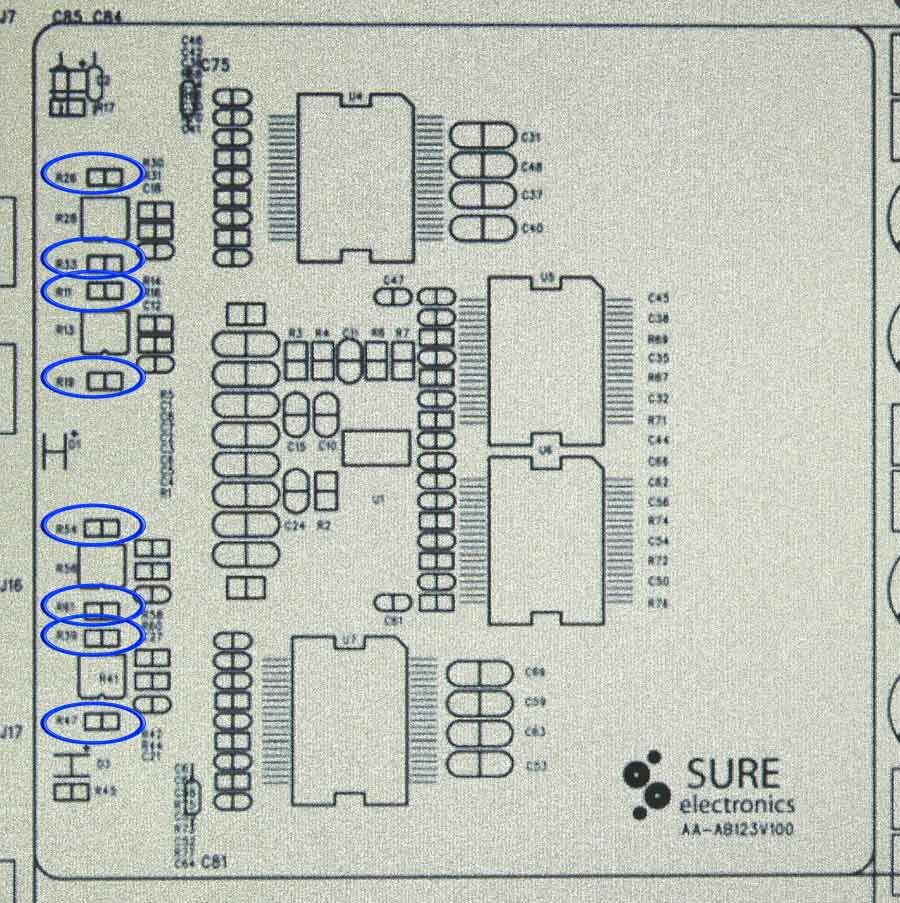

They are pictures of the 4x100 board, I have shown the modified input which shows that the RCA inputs have the better input caps. If you have the updated board it is safe to use the terminal block input.
The other picture shows the 8 resistors that need bridging. they are R11, R19, R26, R33, R39, R47, R54, and R61.

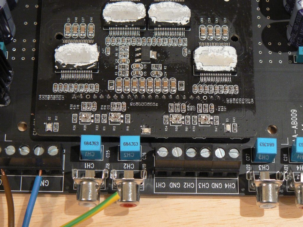

Hi guys,
These are some pictures i took of the board before painting the resistors with the conductive paint.
The first is what you can expect to see once you remove the heat sink.
The second is a close up of the resistors which need to be removed or shorted, marked in red. On my board they all had 104 on them. Once these are shorted/removed the trim pots become incredibly sensitive and should allow you to trim out any Offset you may have.
In case any one is wondering, the paint came from Halfords (some time ago!) and is designed to repair the heated rear window circuit in a car, at the time it was the easiest place for me to get conductive paint. I then literally painted the resistors using a fine brush.
