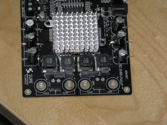

The heatsink on the 4x100 is in the way of the adjusters and should perhaps have had 4 holes to access the trimmers?

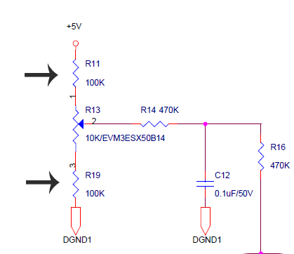

I think I have found the problem... Sure have added 100k resistors to the trimmers and this is preventing them from working😕
These are the resistors; R11, 19, 26, 33, 39, 47, 54 and 61..

Interesting. How can we contact Sure about this? What is the fix?I think I have found the problem... Sure have added 100k resistors to the trimmers and this is preventing them from working😕

The resistors need to be changed to 0 ohm ones, or just bridge them.

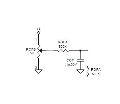

Don't those resistors just make the voltage adjustment more precise? In the Tripath circuit, the pot would swing the DC bias voltage all the way from 0-5V, making it hard to tune exactly. Putting symmetric resistors on either side like Sure has done reduces the range to 2.38-2.61V. They seem like a good thing to me. Am I missing something?
I think with no resistors you have +/-2.5V adjustment.
With the 100k resistors you have +/-120mV, it is not enough.
With 10k resistors it is +/-800mV which may have been the best solution?
I may be wrong?
I may be wrong?
I may be wrong?
That sounds likely to me. The 100k resistors may restrict the range too much. I notice that the tc2000 spec sheet says at one point that DC bias should be "2.5V typical," at another point, it says "approximately 2.4V." If the 2.4V number is right, then it's awfully close to the minimum their setup will allow, 2.38V.
Has anyone adjusted bias with the heatsink off but no signal, or will that fry the chips?
I measure mine yesterday, and I got 192, 197, 7 and 360 MV. Obviously they didn't do a good job adjusting the DC offsets.
Is taking off the heatsink and trying to adjust by myself a good idea?

I took off the heat sink and tried to adjust the DC offsets. The best I could do was: 120, 76, 1, and 322 MV. Has anybody tried to adjust and got any better values?

Hi guys, sorry i have been busy, I work for Waitrose and this is the busiest time of the year for us!
Firstly i have had the amp running on a 12v 5A power supply from my Topping TP10 for a couple of hours to test the board as suggested by Sure, on some old bookshelf Tannoy E-11 ( I also ensured my understanding off bi-amping with this amp on them as well) on 12v the heatsink is only warm to touch however i didn't measure any offsets at this voltage.
I then went on to the Meanwell 24v 14.6A power supply this is giving out a constant 24v although is adjustable via a trimmer by a couple of volts. it was at 24v i took my DC offset readings, which were to high/low for me to be comfortable with.
I removed the heatsink by removing the four screws on the underside of the board, the heatsink then came away from the board easily, the thermal compound looks like that from a computer and does not appear to be adhesive. I left the board powered for about 10 minutes with no audio source connected and the chips became warm to the touch but by not Hot. I decided to use the trim pots whilst connected to the power source, and it looks as if Sure had set the DC offset as low as it was possible to already as the trim pots only increased the DC offset.
I have contacted Sure a couple of times regarding this and they keep giving me the same info which is to adjust the trim pots, just seem to be going round in circles with them here.
Audio1st, I am willing to be a guinea pig in removing those resistors but are they easy to reach? or are they under the daughter board like the previous resistors which were already removed?

Hello Craig,
The resistors could be the smd's either side of the trimmers. Check the resistor numbers I gave earlier. The resistors will have 104 on them. They need to be bridged with solder or wire. Try just one channel..
If you could post a picture of the trimmers I could show which ones.
Too jumpy
This will make the adjustment so jumpy that you will barely be able to touch the pot with your screw driver without the value flying all over the place.
Is the pot already all of the way to one side? If not, changing the resistors won't help. Only hurt. Keep in mind that these amps are 8 channels bridged to make 4 and you are trying to adjust the offset between two outputs with one pot.

Hello Scott,
You have the the 2x100 board and 2 trimmers, the 4x100 board has 4 trimmers, still one per channel. There are no 100k resistors on the 2x100 board, they are coarse but they do work.
Craig,
Also check before you go any further that trimmer one does adjust channel one and not channel two. Also check that channels 3 and 4 are not crossed over as well?
