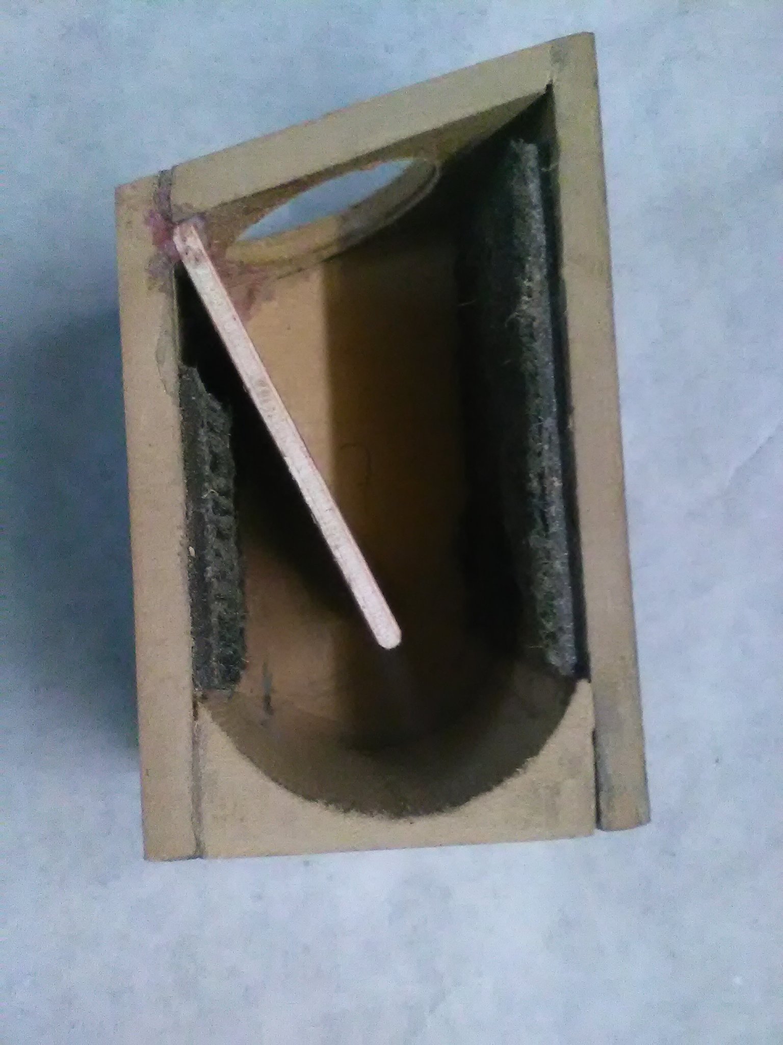

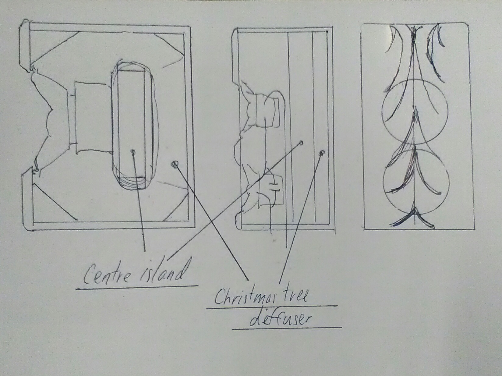

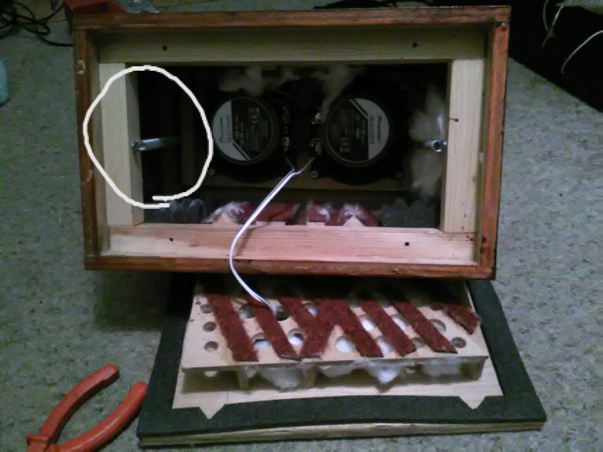

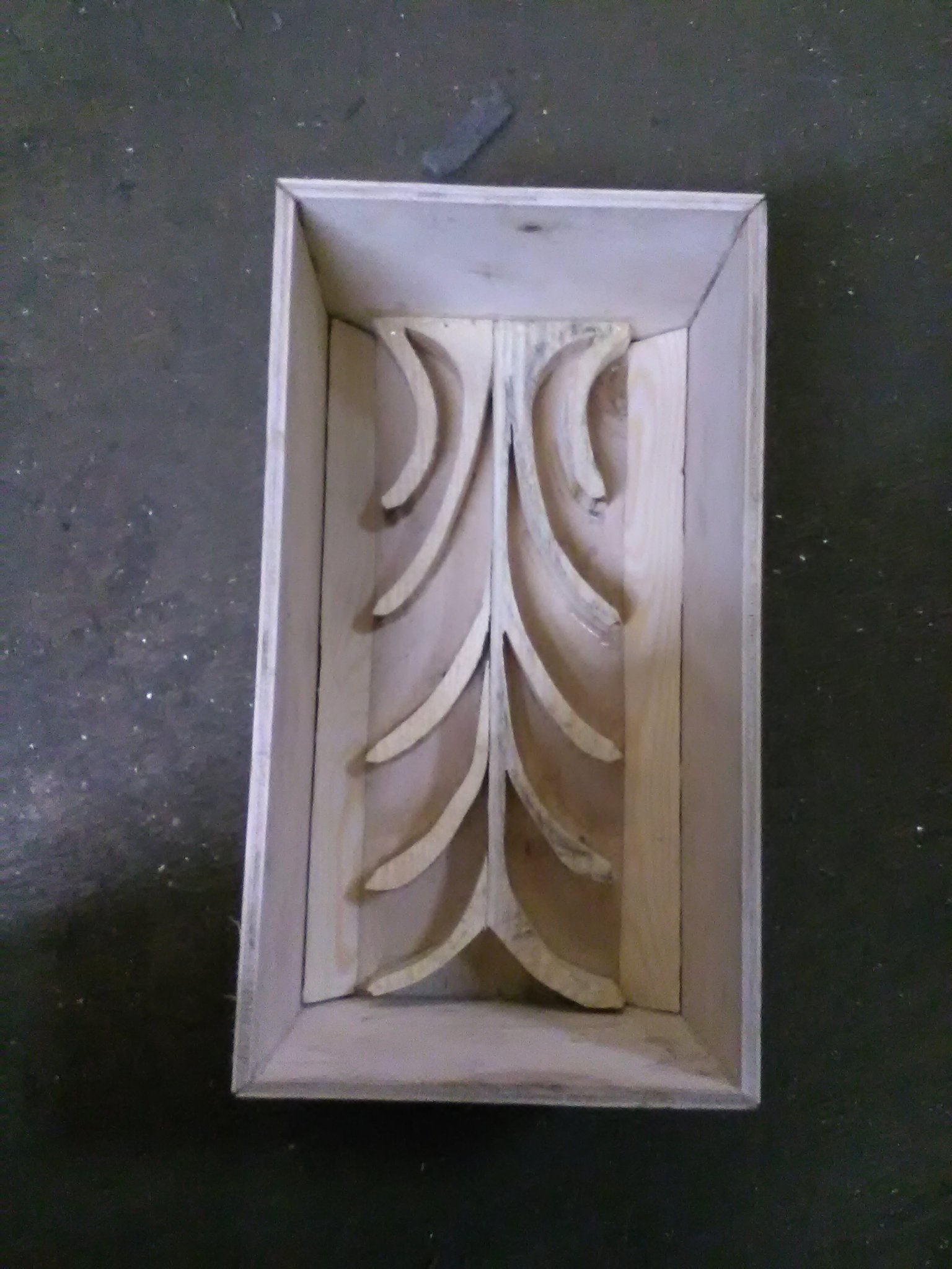

Sorry, but the Christmas tree diffuser isn't that epic, the sound is deflected around a central island and into the diffuser. I have also attached a picture of a tapering absorber and a perforated baffle spaced slightly from the rear wall

I am not sure to catch the idea of central island... Is it closed volume behind the drivers so that the sound has to go around to go in the rear Christmas tree diffuser?
Hello,
That's pretty much the idea, however I've drilled holes in it ( and added strips of carpet tile ) so it isn't too much of a reflective surface directly behind the driver, also so it doesn't rob too much internal volume. I've added a cork layer between the Christmas tree diffuser and island to try and damp cabinet vibrations, however I strongly doubt that it will make much difference.
