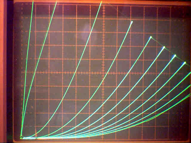

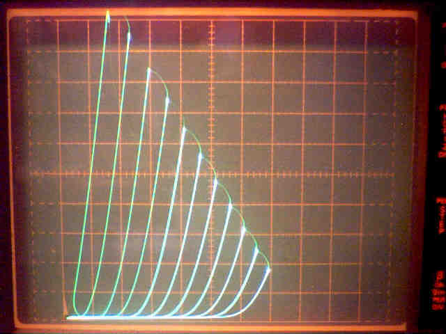

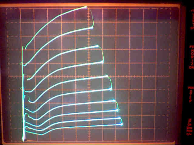

g3 modulation works by deflecting plate current back to the g2 grid. This may not be very linear due to the electron velocity spread from passing earlier grids on the way. I will try this on the curve tracer to see. In any case, g2 gets rather hot when a lot of plate current gets bounced back to it.
Here is the 9KC6 dual control tube, with g3 acting as control grid on the curve tracer. g2 was at +130 V. g1 at 0V. Horiz. scale 50 V /div. and vertical scale at 5 mA / div. Looks like a LOT of odd harmonic distortion using g3.
Guitar effects tube maybe. Take a look at the 6LE8 datasheet too, it has g3 control curves shownon it.

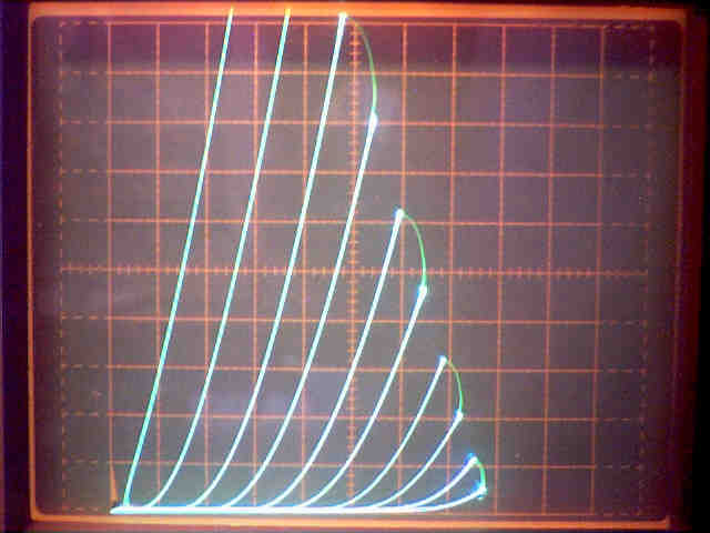

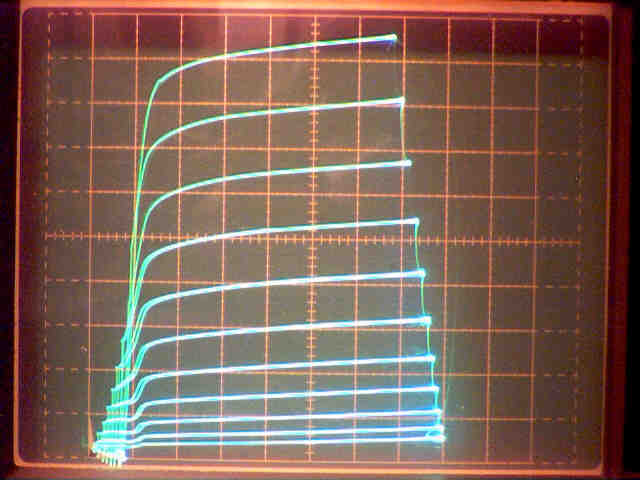

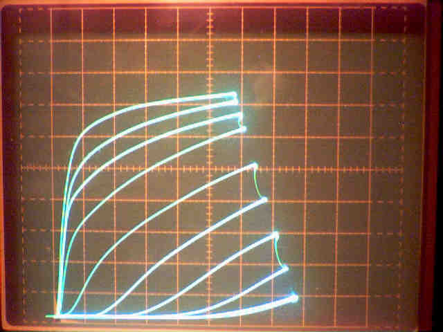

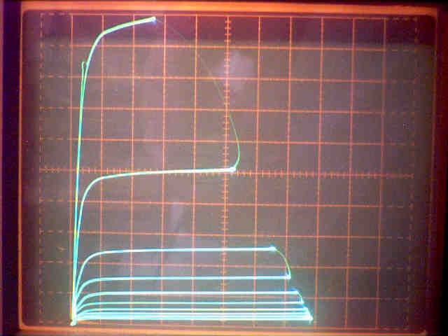

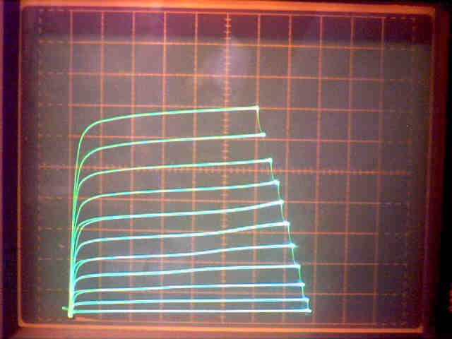

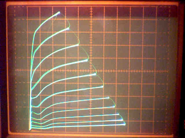

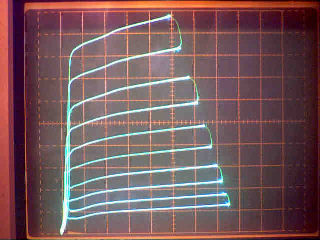

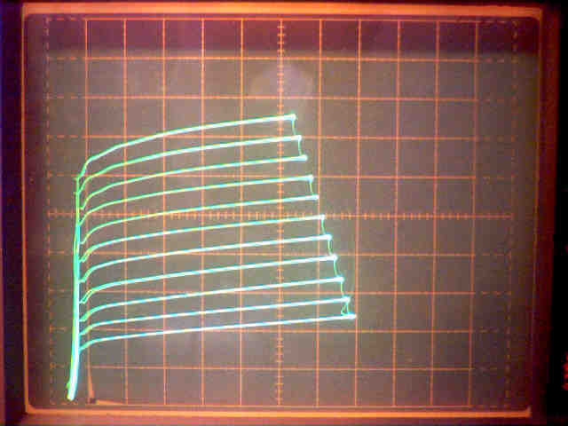

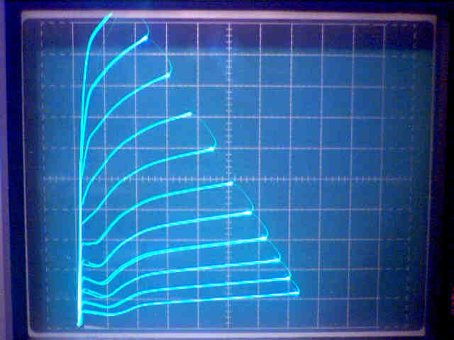

Now here are some 9KC6 g2 control curves,
followed by 6LE8 g2 control curves,
followed by 6LE8 g3 control curves.
The last g3 set are a real surprise. OMG, they look GREAT. We have to keep this to ourselves! Shhh! Secret!

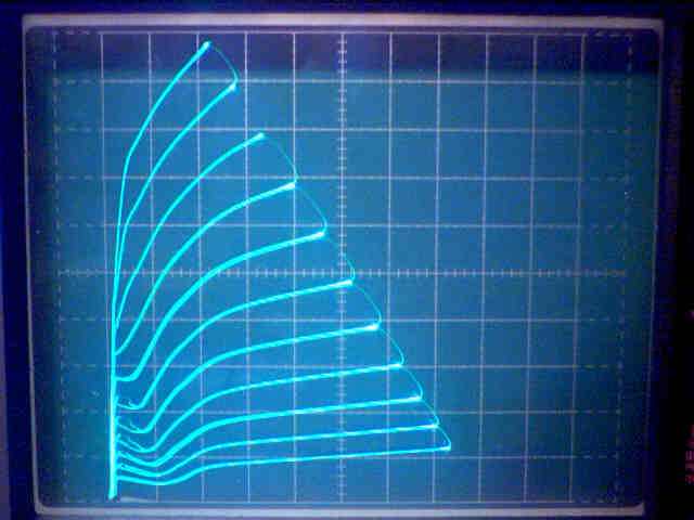

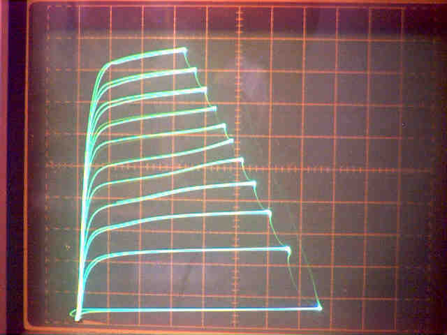

Got the tubes today, arrived in good condition.

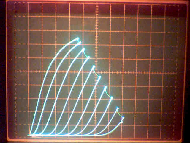

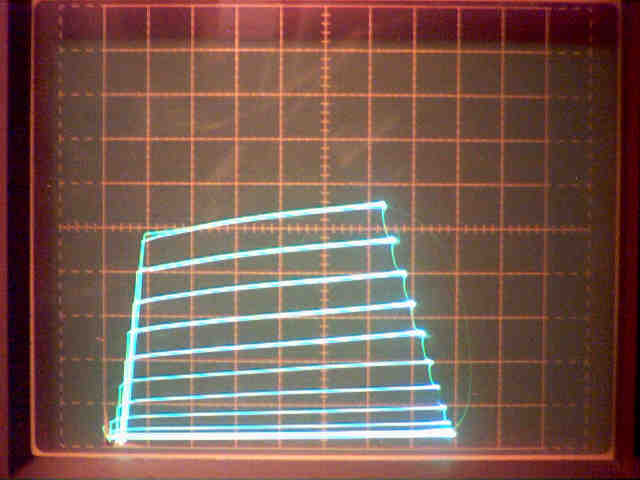

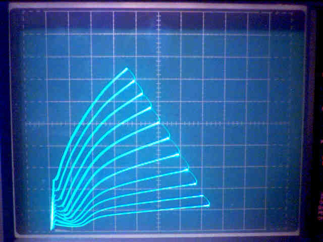

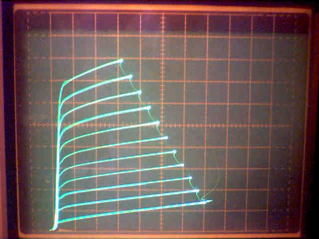

1st tube up for torture: 5763
Axis: 5 mA/ div vertical and 50V /div horiz.
1st plot is with g2 at 140V and g3 at 0V, 1V steps on g1
2nd plot is with g2 at 140V and g3 at -250V, 1V steps on g1
3rd plot is triode mode, 1.9V steps on g1
Seems that the g3 is not effective enough in this tube since -250 V on g3 fixes it up. Seems to be a bit of osc. near the knees too when g3 is 0. Changing g3 voltage in triode mode had almost no effect.
Step size here is rough yet, I still have to do some calibration work on the curve tracer, plus I added a cont. variable control to the step amplifier gain.
I will also have to increase the power supply voltage for the step generator amplifier before I can test the GU-50 fully, I think. Only have around 60V max available at the moment. The step amplifier is already modded for up to 250V.
