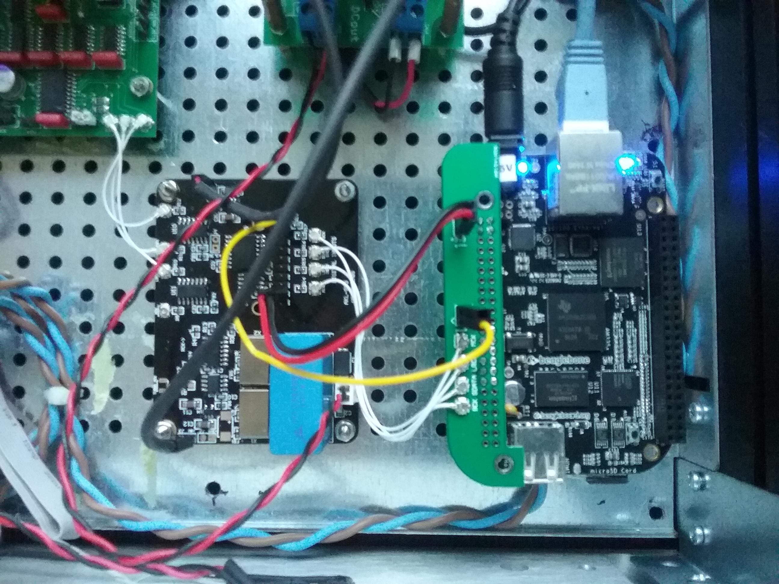

Enrico, then this might be also HW issue. Is there space to improve wiring in your setup? Can you post a photo?

Miero, attached is a picture of the BBB with the S03. The configuration with the Cronus is the same but with only one 5V. I will be surprised if the problem is HW...

The DSD and PCM signals are sourced to different pins of P9 header on BBB. If there is no problem with PCM play, then you might want to check the possibility of dry or incomplete joint soldering that might be remaining between the BBB and Hermes board. The DSD signal is more susceptible to incomplete pin/wire connection and grounding. Just my two cents.
