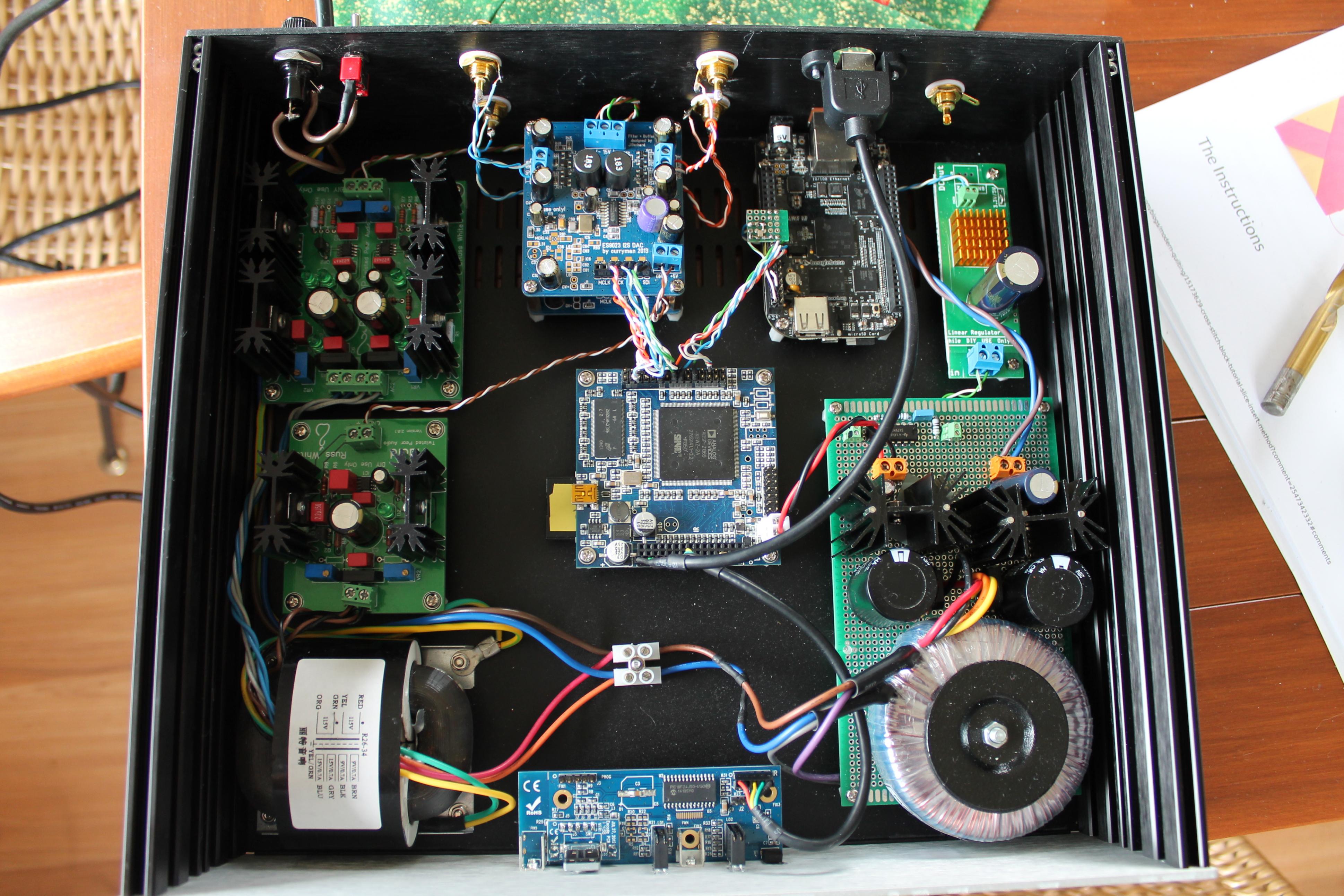

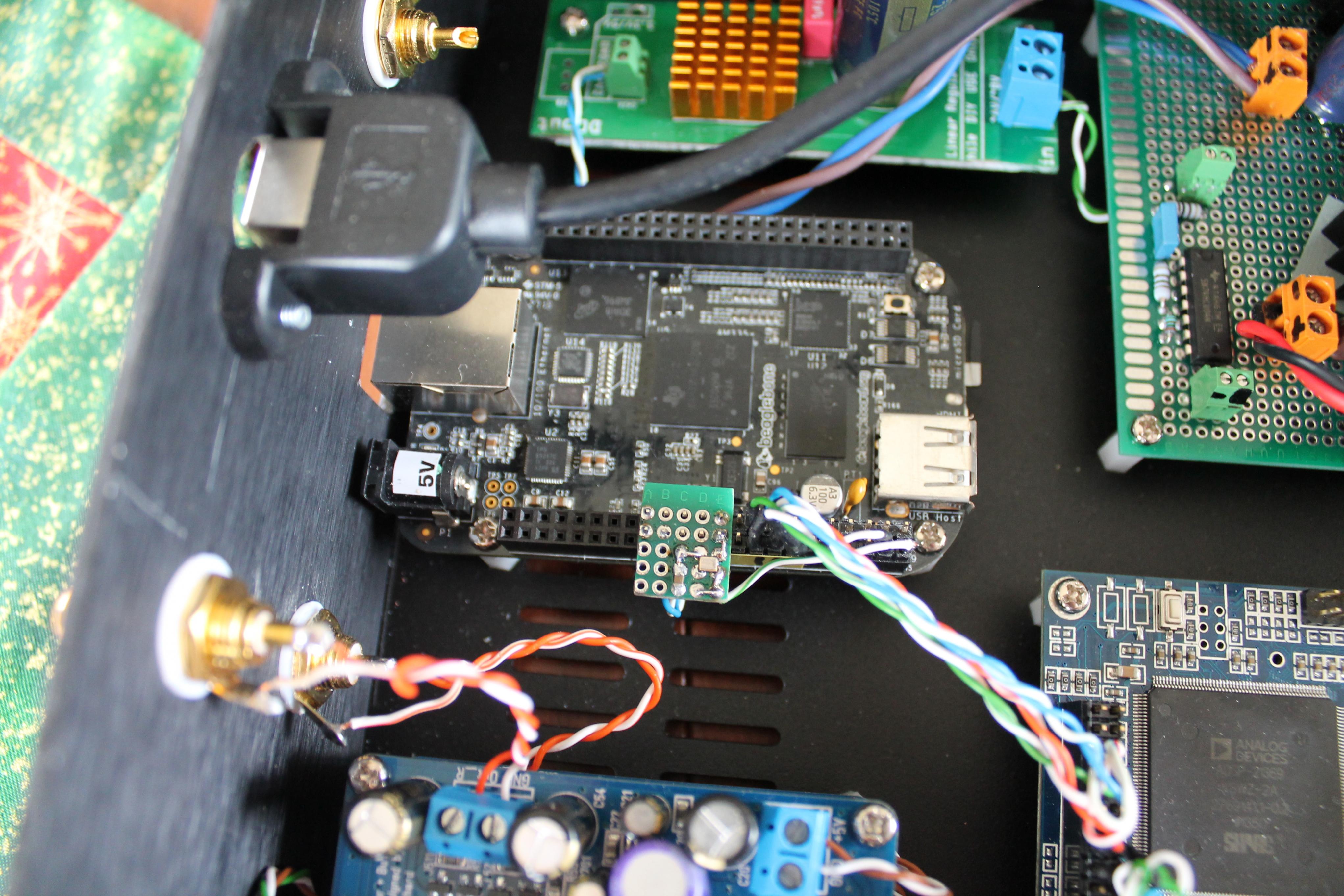

Quick pic of the all in one BBB-DSP-DAC box I have been working on and a close up of the nano-cape with the NDK NZ2520SD 24.576 oscillator (gee they are small - fun to solder!) 3.3v power from the TPS7A4700 on the board at the top. Upsampling via SOX to 96k which is the frequency the miniSHARC runs at. Because of this no need for dual oscillators.
All working as intended - just need to tune the DSP parameters. Only problem I have not is there is no way to feed the analog test tone into the system so I can do frequency response measurements!
Not mainstream in terms of what most others are doing I know but running the miero Botic code so here it is...

Very cool Chris. That you are exercising Miero's driver and getting expected results is VERY relevant to what the rest of us are doing! Thanks for sharing!
Can you use the speaker test function in Alsa to produce test tones? Miero may have to provide a correction for how to make it work with his BBB driver, but it goes something like this:
speaker-test -Dhw:Botic -c 2 -f 1000 -r 96000
BTW, got this from Miero the man himself. Very generous & productive dude!

Thanks, I will read up on speaker-test, have used it before I recall. Problem is I am using REW which generates its own frequency sweep and records the mic output. may look at using the SPDIF input - not in place yet as I need to convert coax to TTL 3.3v, just waiting on some components to do that. Then find a laptop with spdif output or get HDMI to SPDIF converter - sure it can be done somehow!
A hot-air station would be useful for sure. I did manage to find a way to do it with a fine iron in the end involving soldering all surfaces first then placing the oscillator and reflowing.
The speaker-test tool is not able to generate sine sweep, but you can use play tool for this. The play is part of sox package.
$ play -r 96000 -c 2 -n synth 30 sin 500-5000 vol -3dB
This will play 30 seconds of sine sweep from 500Hz to 5kHz on two channels and at 96kHz sampling rate.
Enjoy! 🙂
