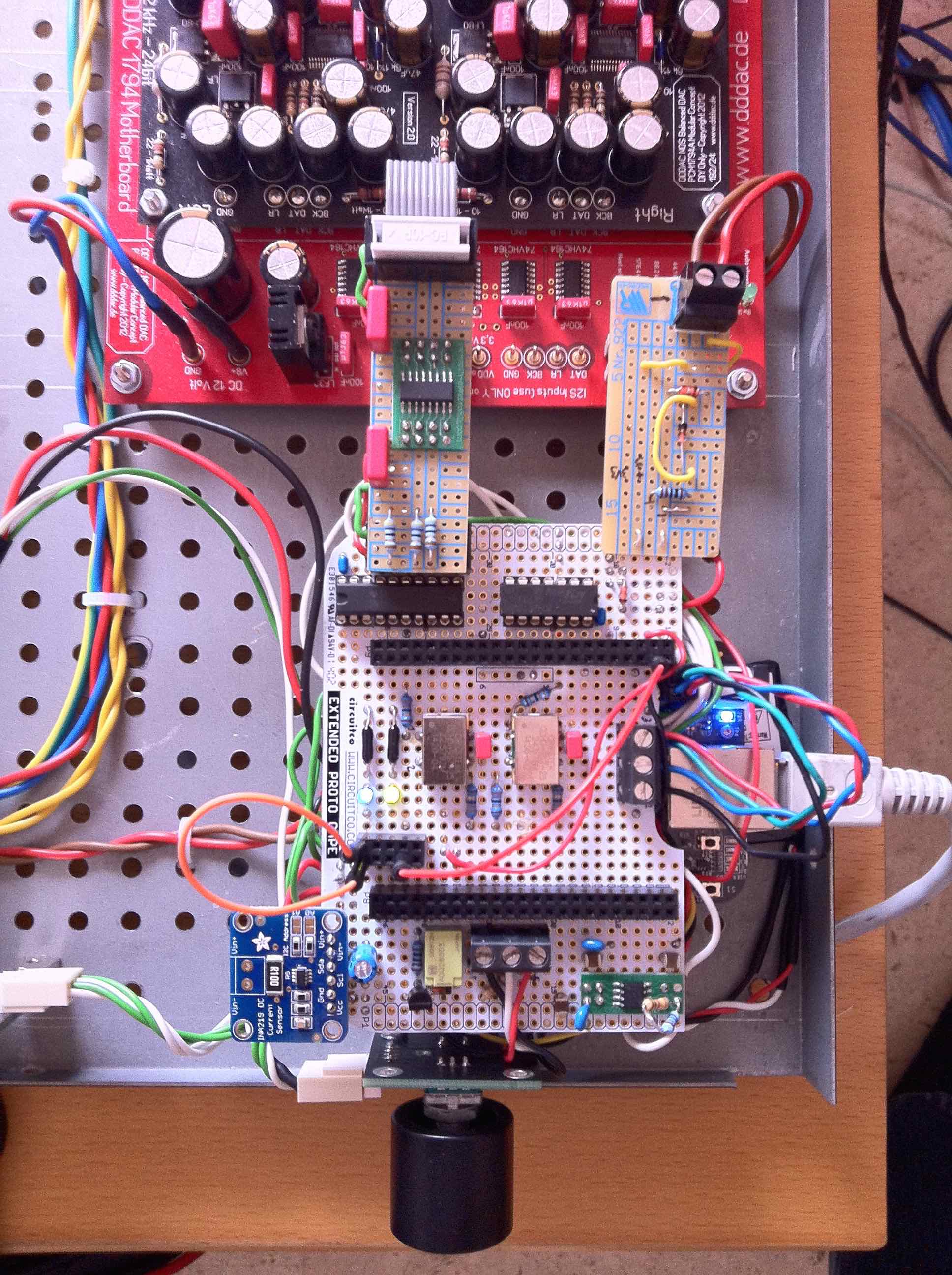

BBB Cape with DDDAC1794
Hi Miero, thanks a lot for your great work, and thanks to Russ and the DIY folk for ideas around the cape.
While waiting for Russ' cape I built my own protocape with BBB Rev. C, works great in I2S mode connected to a DDDAC1794. After some tests with a DSD DAC I'll design my own board layout.
There is still one hardware issue. My power supply uses a small LiPo for safe shutdown (following discussion in this thread), but when BBB is totally shut down there is still a small current on the 3V3 power line on the BBB by LiPo. So after 24h hours the LiPo is dead. Thats why I switch the LiPo shortly off after complete shutdown of BBB by a small 3V3 relay, then it's fine. Any other ideas? The relay cannot control by BBB.

Yes, BBB was switched off, by switching off 5V supply via cape (USB and AC are off) or by SSH command "shutdown -hP now".
BBB in my setup is always connected via BAT connector to 3.7V LiPo and the 3V3 line (P9.3-4) is still on after shutdown. I tested this with different BBB boards (element14, Rev.C). Maybe the TP65217 is not absolutely off after this procedure? Shortly switching off LiPo after BBB shutdown is a solution but maybe there is a better way. I'm still on investigating but if anybody has tip...
