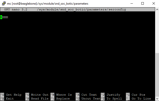

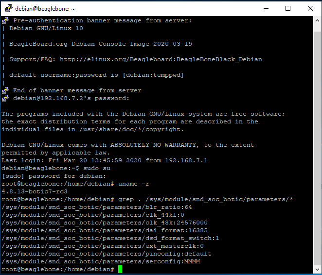

With the faulty setup I also noticed when running "cat /proc/asound/Botic/pcm0p/sub0/hw_params" it said "no such file or directory" ... ???
In /proc/asound the Botic directory was not present so I had the impression that /boot/uEnv.txt had something to do with it.
Comparing uEnv.txt I noticed the faulty systems missed the "#" at the beginning of the line "enable_uboot_overlays=1"
Deactivating the command by placing "#" in front of the line solved the problem for both Debian 9 and 10.

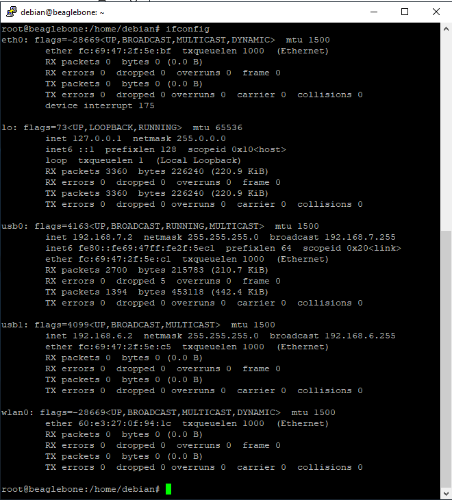

I repair my problem for BBGW connected to Internet at here: How to Setup WiFi on the BeagleBone Black Wireless
I performance to chapter 7. I having two problem at next guide.
I missing the "internet over usb" at adress 192.168.7.2 via Putty SSH and Wifi 192.168.8.2 of BBGW both.nano /boot/uEnv.txt
Remove “#” before dtb= and complete line like this: dtb=am335x-boneblack-botic.dtb
And add # at the start of this line: “enable_uboot_cape_universal=1” further down this file.
I mean before I connect SSH Puttu are good, and I performance from chapter 1 to chapter 5 are good too. Only when apply "dtb=am335x-boneblack-botic.dtb" and reboot. All SSH connect to my BBGW missing.

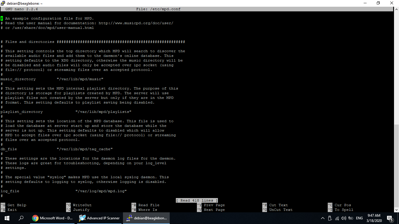

But at "nano /etc/mpd.conf" I see diffirent to your guide. Please the see attacked below.nano /etc/mpd.conf change the following
music_directory change to: "/mnt/music"
port “6600” (remove # at start of line)
auto_update “yes” (remove # at start of line)
Audio output: (alsa)
name change to “Name_of_your_DAC”
device "hw:0,0" (make sure it is set as “hw:0,0” and remove # at start of line)
mixer_type "hardware" (remove # at start of line)
Device hw:0,0 is for using I2S out from 40 pin header instead of sending audio over USB
I suggest using a LAN scanning program such as Fing or Net Analyzer (iOS, many similar programs for Android). The BBGW will likely report as 'Texas Instruments', and you can see exactly what IP address it is using. For convenience, it is best to give the BBB or BBGW a static address that will not change from one re-boot to the next.
I using ScanIP.
Before my BBGW are 192.168.1.2 (Texas Instruments) - one client of my Lan, and it displayed are online with green led.
I missing IP Adress of my BBGW it after performance it. 192.168.1.2 displayed are offline.nano /boot/uEnv.txt

I not see any "Texas Instruments" other are displaying.
I using ScanIP.
Before my BBGW are 192.168.1.2 - one client of my Lan, and it displayed are online with green led.
Are you sure you als edited the line further down the uEnv.txt:
put # in front of “enable_uboot_cape_universal=1”
If you not disable this line by # it can happen (mostly at Debian 8) that the BB will not reboot.
You can also check visually on BB if the LED's are flashing or not.
If “enable_uboot_cape_universal=1” is causing trouble I had it that 2 LED's are on constant but no flashing.

I can't the find enable_uboot_cape_universal = 1 before because I don't pulldown.
I'm successfully folow your guide now.
Botic and MPD/MPC running on 192.168.1.2 Texas Instrucment in my LAN.

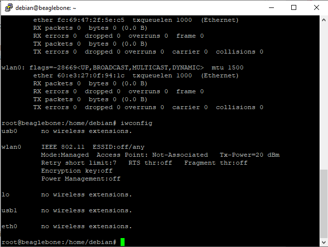

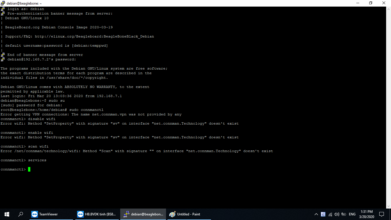

Sorry! because I got a little confused.
I have tried it many times. Wifi onboard only problem when the me changed "#dtb=" into "dtb=am335x-boneblack-botic.dtb".
If I restore "dtb=am335x-boneblack-botic.dtb" into "#dtb=" as first and reboot my BBGW. So wifi onboard are normal performance.
I tried on Debian 8.7 & 9.5 & 10.0 & 10.3 problem same too.
Should, I mean can "am335x-boneblack-botic.dtb" does't support the wifi onboard default, right ?
Can anyone help me fix this problem? Tks so much 😀
I using USB Wireless TL-WN722N v1.2 for connect to my LAN and Internet.

I want the change parameter of Botic7. After edit to new parameter, then Ctl+O for "Save", and read again for sure. I see the parameter are changed to new parameter.
But, when I reboot BBGW - the parameter this auto return to default parameter first.
What is the problem of my and what to do to handle it. Thank you everyone
