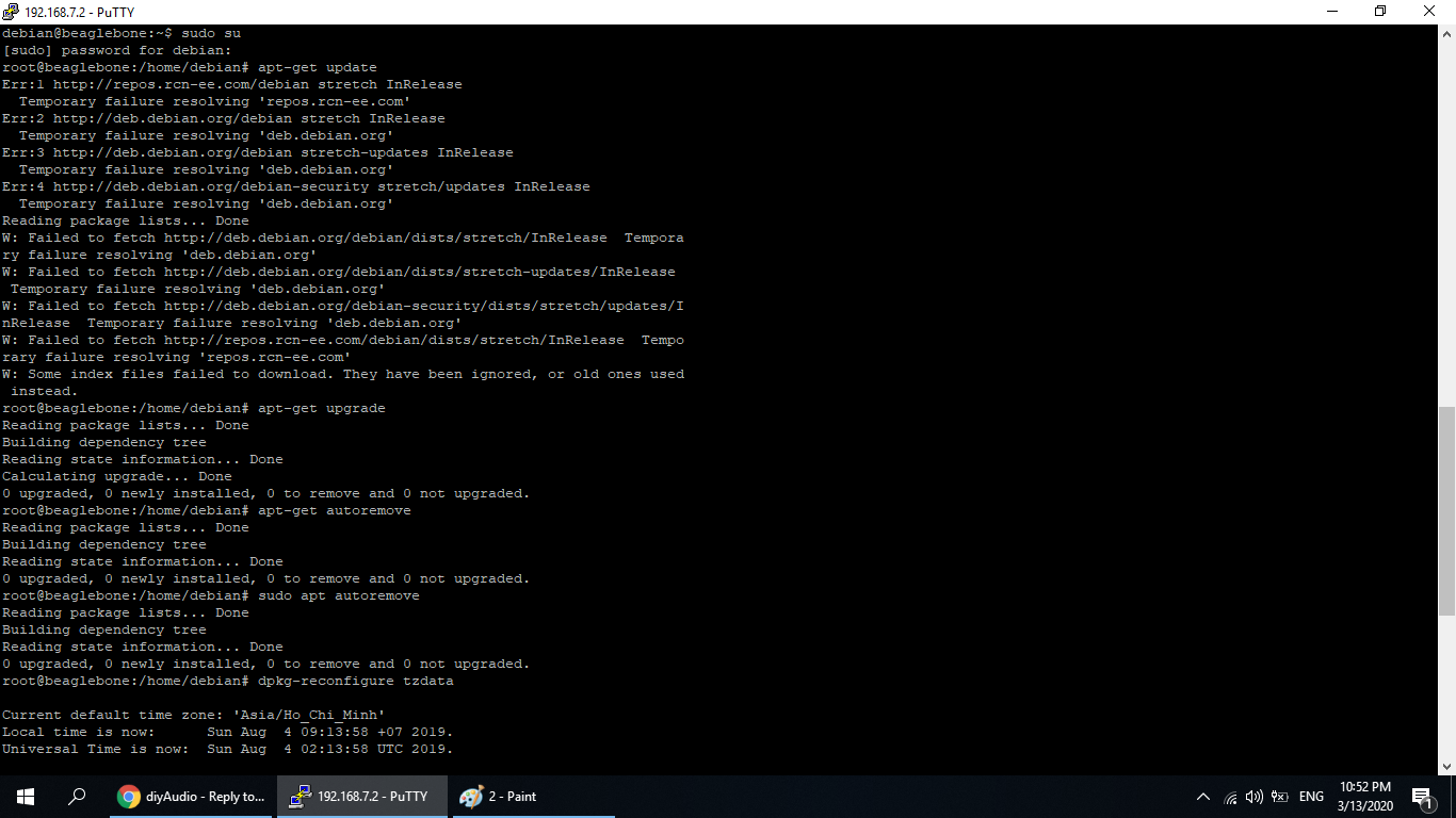

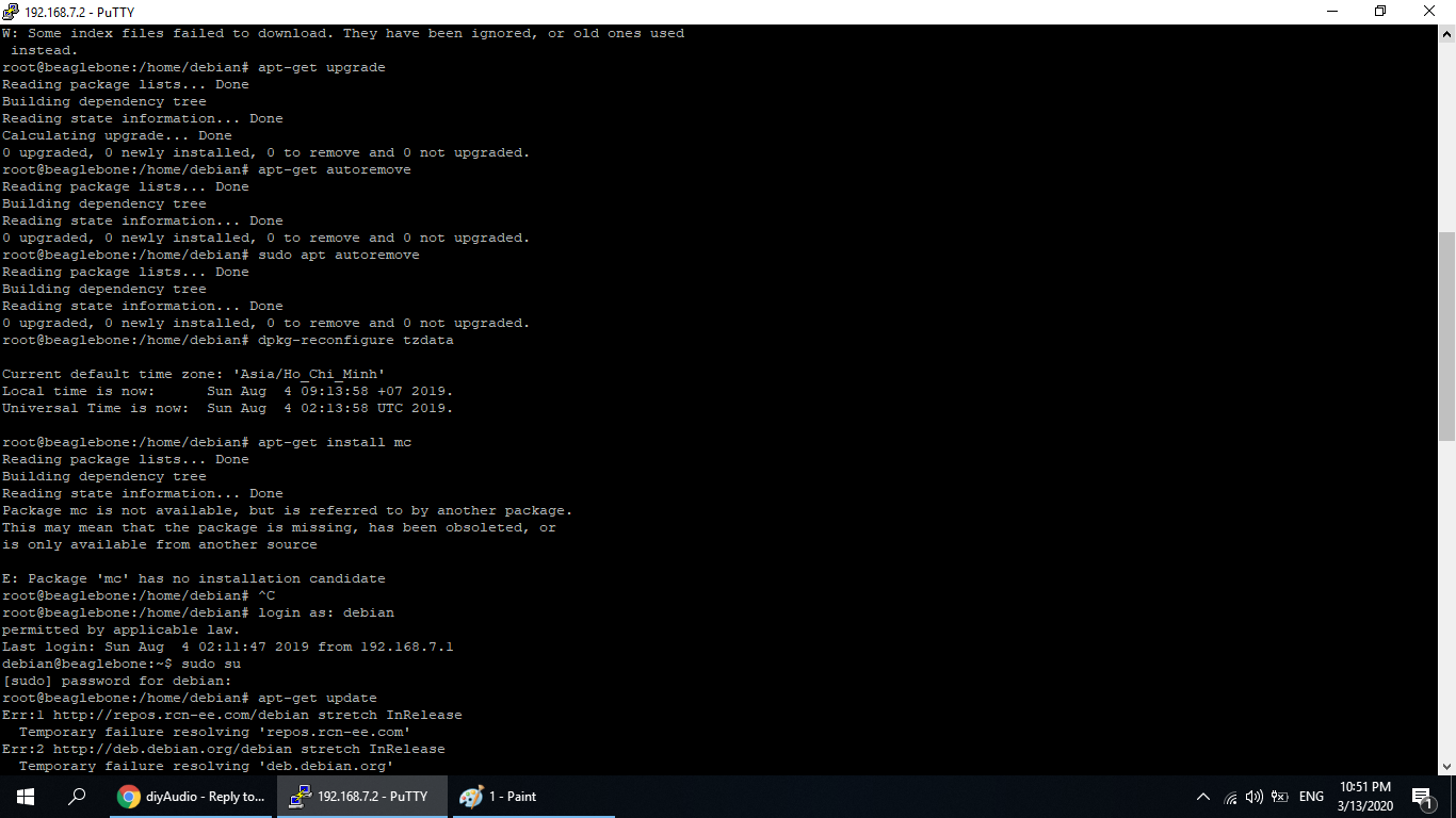

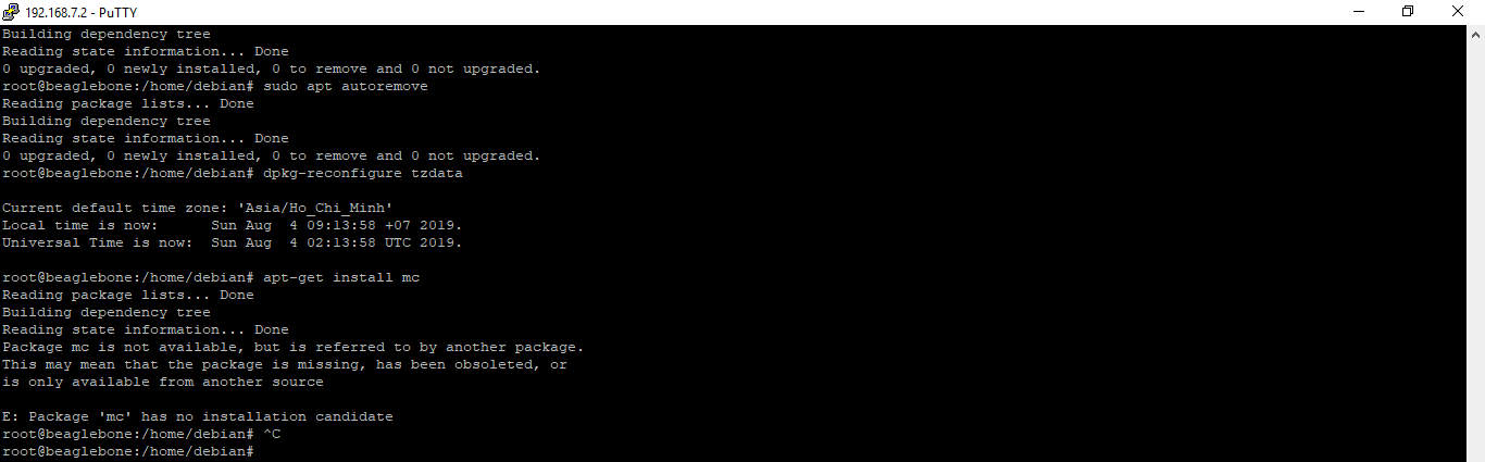

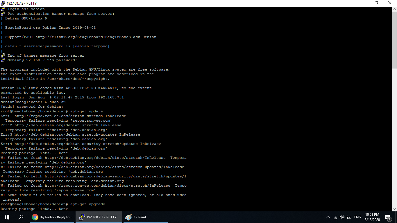

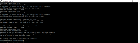

I have problem when used the codes (apt-get update, apt-get upgrade, sudo apt autoremove, apt-get install mc) as images attack below:
My ethernet are good, and I connect to my BBGW via USB: 192.168.7.2
Please hepl me

P.S. is the LAN connected to the BBB also connected to the internet ?
For apt-get update/upgrade/install the software will be downloaded from the internet so it wil not work if you only have an isolated LAN without internet connection.

My PC Windows are alway connected to Internet with wifi wireless 192.168.1.5
I only connect to my BBGW via Putty SSH via USB (Internet Over USB) with 192.168.7.2
So, BBGW are not connect to Internet, right?
It looks like your BBB is not connected to internet.
Your PC is on another subnet than BBB
PC = xxx.xxx.1.xxx
BBB = xxx.xxx.7.xxx
Normally when BBB starts it should get an IP addres from your router (DHCP server) and then your BBB also should have an IP address wit “1” in the 3rd block.
But this is standard TCP/IP / network technology not related to Botic.
Did you connect the USB/LAN converter to your router direct or do you have direct cable between BBB and PC ?
P.S. in Windows PC you can bridge you LAN connection (to BBGW) to your wireless connection.
Then the BBGW is also connected to the internet.
On internet is enough info how to do this: Google for “Windows LAN brigde to wireless”
