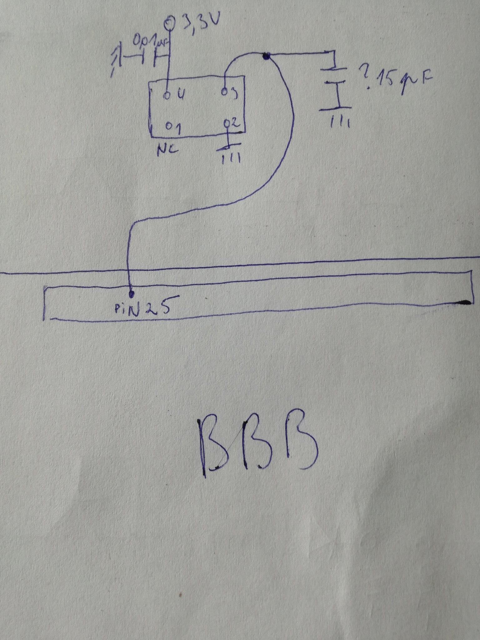

Hello,
I want to use one simple external oscillator (CCHD-575), but I don't understand if the load cap is needed. In the datasheet it says that the tests is done with a 15pF load. Should I put that cap like in the draw?
Also, if this particular oscillator hasn't a disable pin, will it be a problem if at the pin 25 will always be a signal comming from the oscillator?
But how is hardware volume control implemented now?
The TPA DACs have a pot-based controller built into the firmware. Lacking that, you will have to look into scripting your own. A command-line interface is not very user friendly, but the sound quality of attenuating on the 9018 is quite good. If you are sufficiently motivated I suggest NetIO, with a volume control script in Python. Code examples are available, and Python is fairly straightforward. A thread exists here: http://www.diyaudio.com/forums/twisted-pear/281776-control-bbb-based-audio-appliances.html
Cheers!
