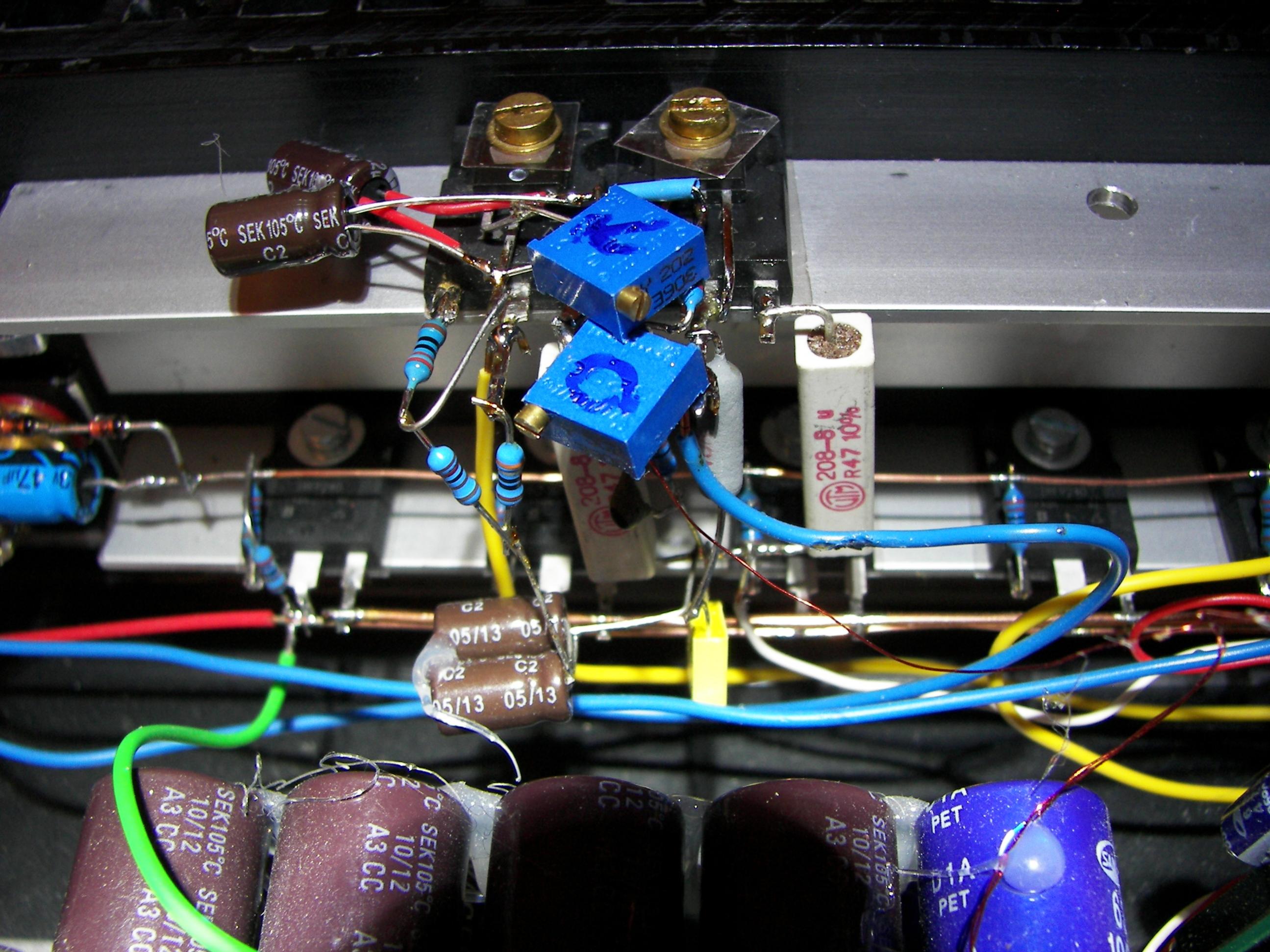

I wrote somewhere I will be using ESP P101 mosfet amps, hi-power versions. I already made them and they sound excellent. But most amps which were designed good sound the same for my ears. In time I'll change the amps with my own design.
I'm building an entire integrated amplifier, including pre amplifer(volume, tone and balance control). I'll also have full digital control over the amp via Android/iOS applications over Bluetooth. Still don't know which preamps to use.
I will make another thread in near future when everything will be finished.
Great amp, great design. Just one complementary-parts-stage. I would integrare an active bias-regulator/control.

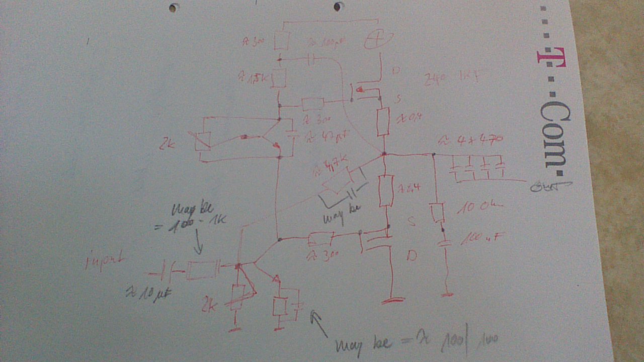

To beat this design you would need a not-complementary-parts-design. And a step further: With only one psu, just (+) or (-). Or, final, a se.-)
May be you need just passive tone-controls. There is a differential-"preamp"-) I built this design - with only one (+)-psu, without this pre. Less "sound" in my mind. Every source does drive easy.

@ Abdiel:
I try to recreate the amp and will send a graphic.
