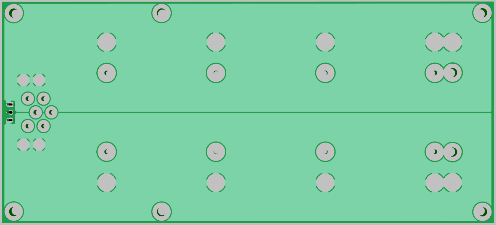

It's quite difficult to properly solder (or desolder) a pad that is connected to a plane,
without using them. They are universally used in pcb design.
https://en.wikipedia.org/wiki/Thermal_relief
https://www.google.com/search?q=the...zmmorMAhWFJCYKHfd2CrUQsAQIIw&biw=1093&bih=506
Depends on the supply current, where possible it is best to use them, but some designs just have too much current.... To give an assembler a challenge I did some boards for a BIG SMPS (13kW) using 4 and 6 ounce copper, NO thermal relief🙂
The rule for high current is that the spokes width must be the trace width for the required current divided by the number of spokes. (Ref IPC-2221, IPC-2152 etc.)

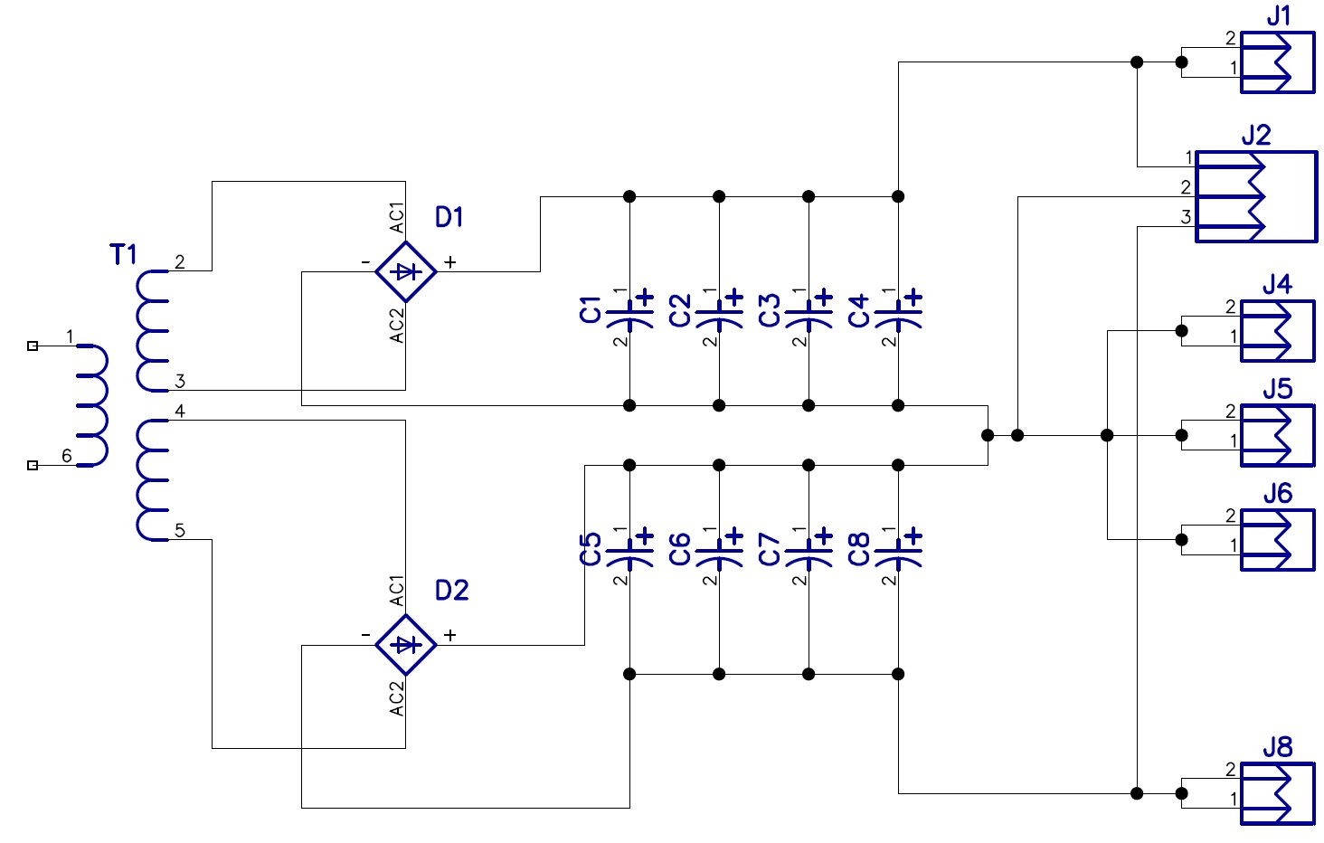

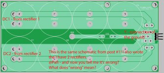

This is the schematic.
Like I said on the 1st post, I have 2 rectifiers.
Each has 4 caps.
1st cap on each is directly tied to rectifier on all my PCBs except the last one.
Each has 4 caps.

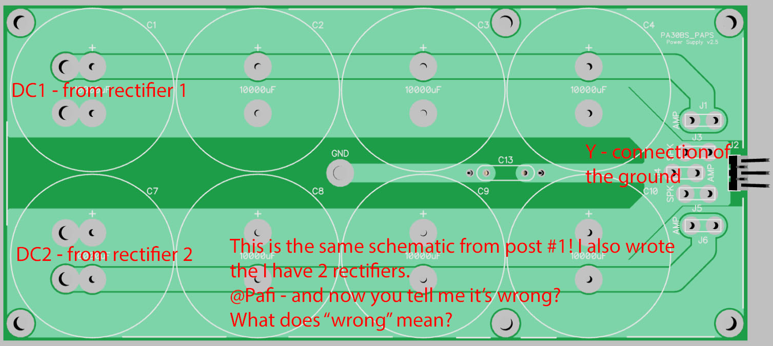

Yeah. And I've seen some PCBs here which have enormous ground plane but they connect the pad with 4 silly 0,33mm spokes.😀marce said:Depends on the supply current, where possible it is best to use them, but some designs just have too much current.
I would use both wires for both psus. The differences - not the voltage-high only - between (+) and (-) would be more slightly.
It would sound a little bit cleaner, finer.
Not sure what you mean.😕
PSU is exactly as it is on schematic...it's +-56VDC.
Figured you will complain about Y. 😉
GND plane overlaps both + and - plane, look closer, on both 2.4 and current 2.5 version.
If I have to look closer to see, then they don't. 100 % overlap is needed, not a fraction of a mm. It's practically nothing. And I repeat, it should be continuos.
Why to ruin something that has been almost perfect?
And do you think there is any problem with 4*0.33 mm spokes? What current do you want to use it for? Over 10 amps/capacitor? Do you think your capacitor survives 10 amps continuously? I tell you: it wont. But a single 0.33 mm track with 0.4 mm length can carry 10 amps easily. And that spokes has much lower impedance then anything else on your design. So no reason for you to avoid them.
Not every design needs thermal relief. For example in a 500 kHz DC/DC converter with 100A 1V output the inductance of a thermally reliefed pad can be too much, so it's better to be avoided. But it will be assembled in reflow owen, so no problem with any plane connected, everything is heated the same time.

@AndrewT
But I'm using 2 rectifiers! Not one!
I don't have one middle transformer point, I have 2 middle points.
Transformer has 4 wires. Yes, I could put middle ones together into one, but the idea is to use 2 rectifiers. So each rectifier has it own caps, first rectifier has upper capacitors, second has lower capacitors. Should they not connect on one single point at the end?🙁

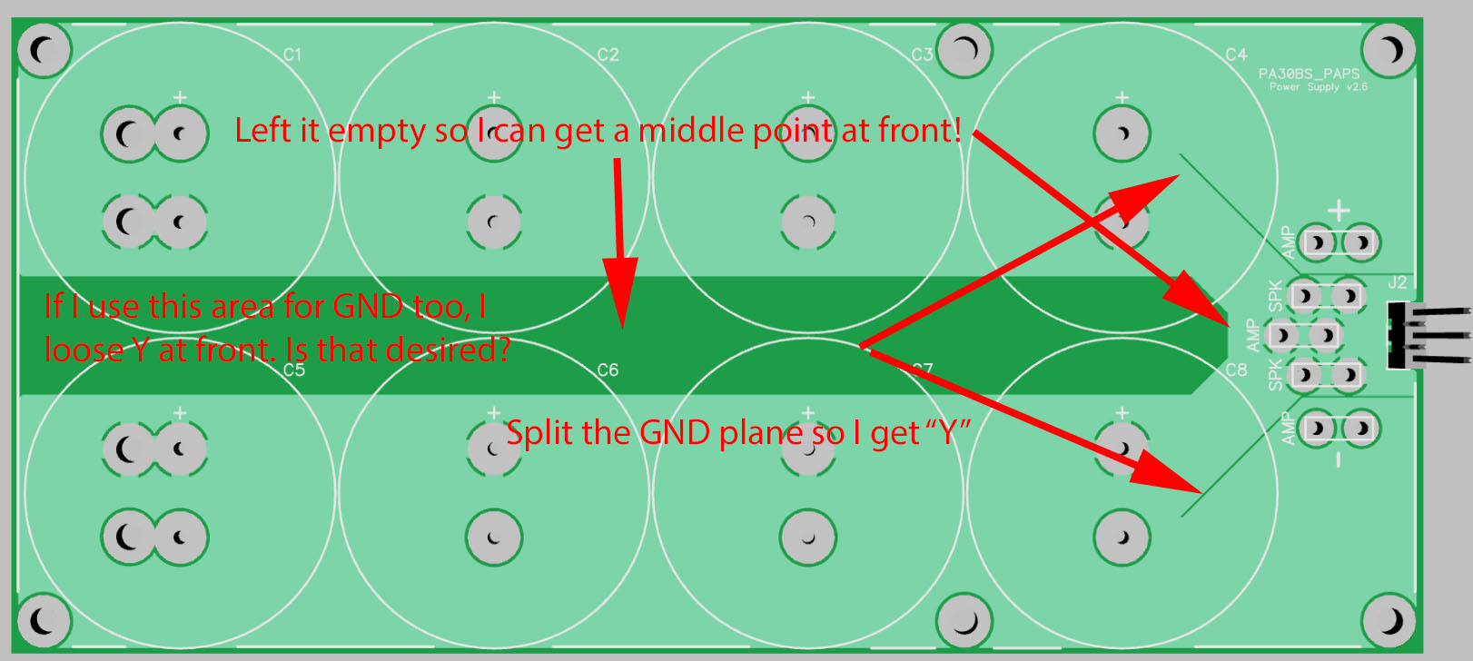

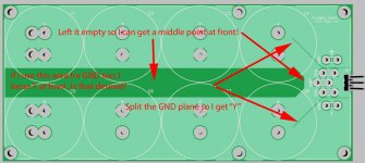

I went back to design on post #22 since Pafi said it's the best. I wanted to remove some things and put + and - fastons closer to GND. I'll soon post an update based on his words.
I sure hope he has a PhD, I would be very happy about it! I'm sick of subjectivism and all the crap I've read and seen, finally someone who can give the right answers.
@Pafi
I guess my words were misunderstood. When I said I'll do another design, I meant I wish to change some things based on design on post #22. Not "I'll do it better than you". If I knew better, I would have not asked.
Anyways, I've made a new design. Removed cap/resistor for chassis, put + and - fastons closer to GND.
I've also reverted back + and - lines(bottom layer) so they are very close to each other as on post #22, which was intended. I also put GND plane on whole top layer, except in the middle.
As you can see, I left a bit of space in the middle and I've split the GND plane where connectors are so I can get an "Y".
Is this desired or not?
You said I should keep Y, but on one of the posts you said I should minimize the loop for first capacitor, which is what I have now, for both + and - planes, each plane's 1st capacitor returns directly to rectifier. Or am I mistaken here?
This is where you have confused me.
I'll do which is best.
I can also use 1 rectifier and then the entire top layer as GND makes sense to me perfectly. I'm just confused because it seems nobody understands what I'm trying to do, use 2 rectifiers.

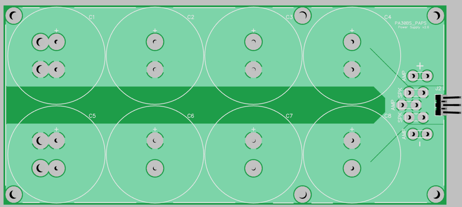

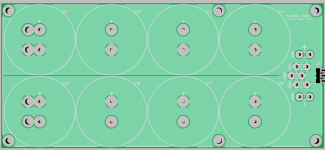

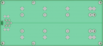

And this would be the updated version.
Left a small gap in the middle so GND is covering 100% of - and + planes.
Removed those splitters, this is still a Y connection, just with bigger joining point.
Bottom layer is the same, + and - planes on each half, very close to each other.
I've also used thermal reliefs(2mm per spoke), since all planes (+, -, GND) have very large areas.
Is this ok?
Is this ok?

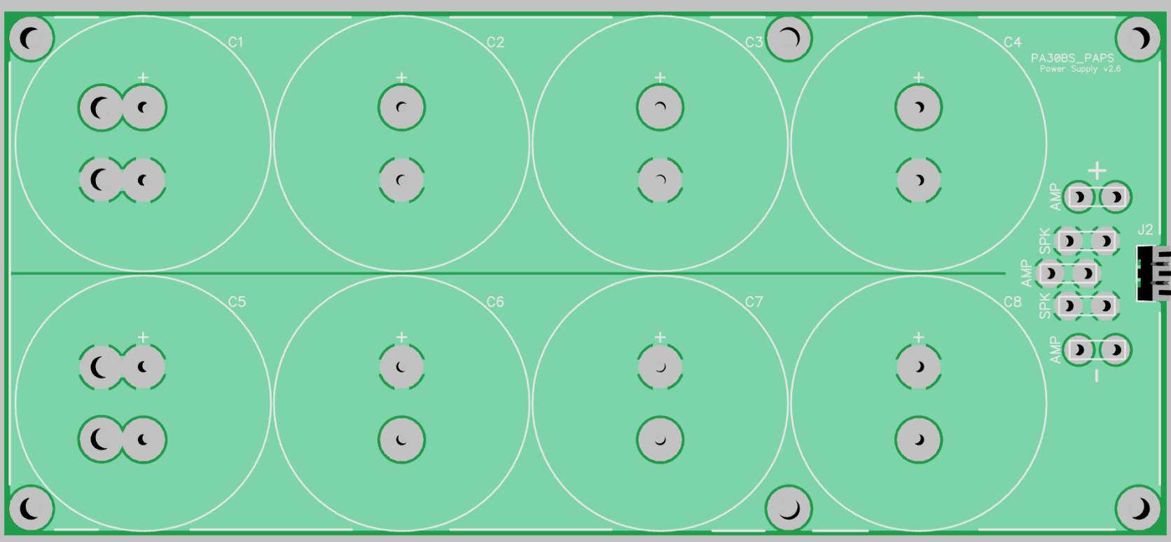

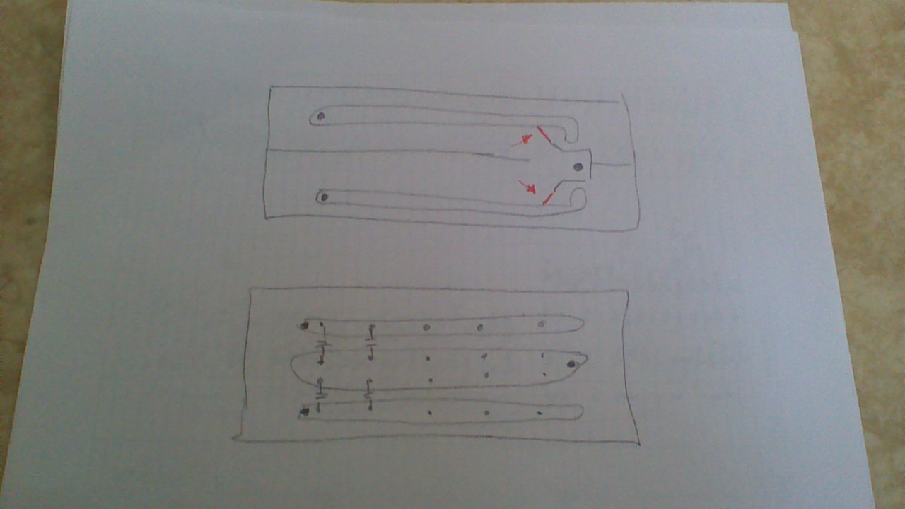

Your last pcbs are chaos-grounds. X- undefined circuits, currents.
I suggest the pcb # 53, with a little alteration as shown. To get not ground-loops, to get a more defined circuit, current.
And I would connect the middle-windings of the trafo, use one rectifier, to reduce the differences between (+) and (-). The minimal better pcb (would be) as shown below.

Ok, PCB from post #53...so I just cut more on top of pcb GND layer to create better Y. Ok, I'll do that because it has sense. Someone before you told me that that was not necessary... Oh boy, this is so confusing.
Your image, bottom part has GND in the middle. Pafi said not to do it that way, + and - planes should be as close to each other with GND plane only on top. I've also gotten the same response from another engineer(not from here). I'll wait what Pafi has to say.
Like I said before, one person tells me one way, other person tells me the other way. It's hard to know which is the "best".
